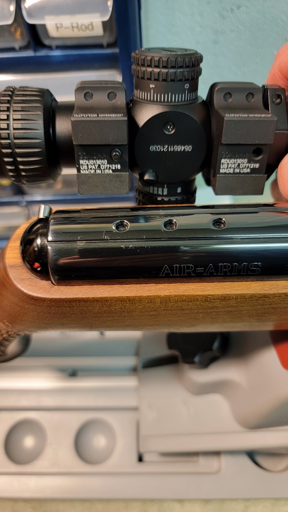

This is just to share my evening of scope mounting. And then the questions came up...

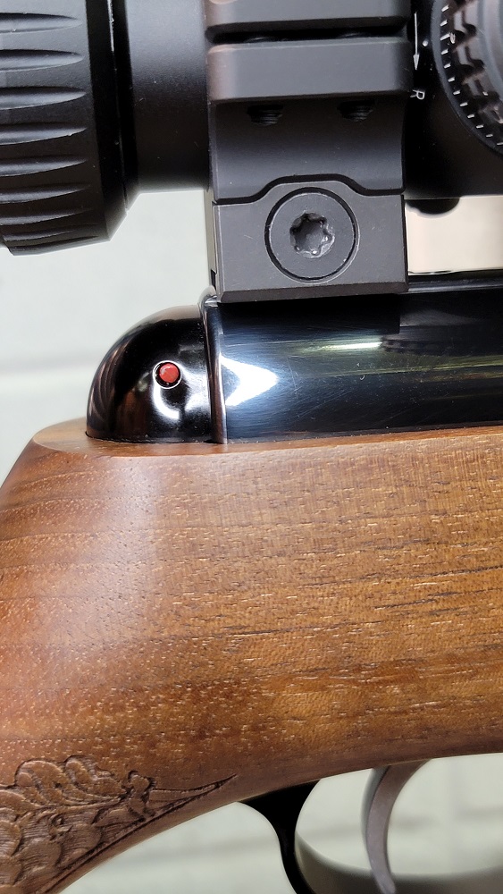

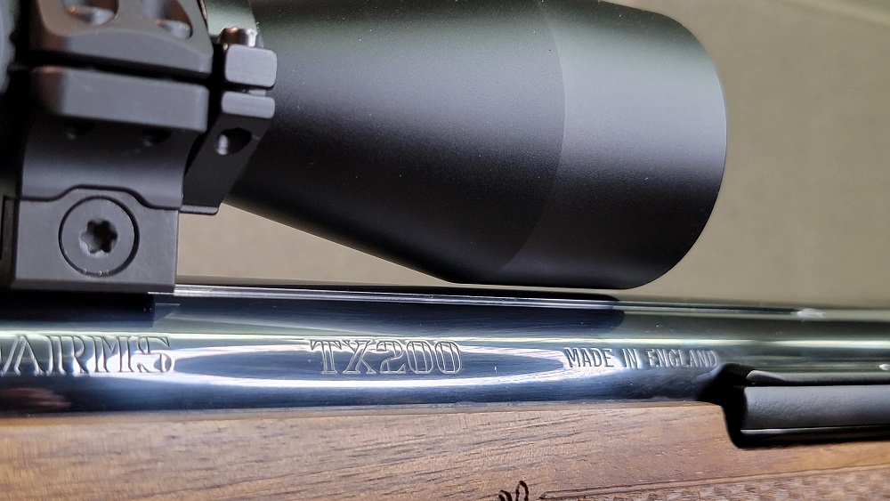

My springer is a AA TX200 MKIII in .17 along with the Vortek kit, topped with a new Vector Veyron 3-12x44 with what I hope to be the “perfect for me” rings from UTG. They are the UTG PRO low rings (RDU013010) @ 10mm saddle height. They allow the scope bell to sit, no lie, 1mm from the barrel. I dream of this for my FX’s!!!

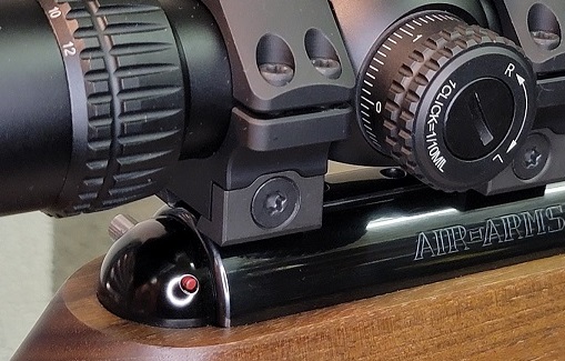

I discovered this evening that even though I torqued the rings to the dovetail with my Wheeler from 22 i#, in 5 i# increments, to 45 i# (UTG recommends 40 i#). After 3-5 rounds, the recoil has moved the scope rings on the dovetail backwards at every torque setting, even with the stop-pin set fully set forward.
If you know this scope and can see from my photo there is not much wiggle room for scope ring placement.
Does it matter that it moves?
Do I need different rings?
Will they settle in?
I have not tested on the bench after my scope mounting, but would like to hear others experiences.
Here are some photos.
Patrick

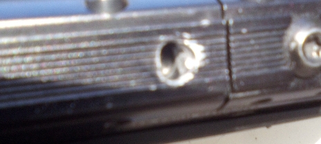

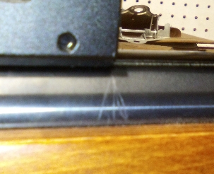

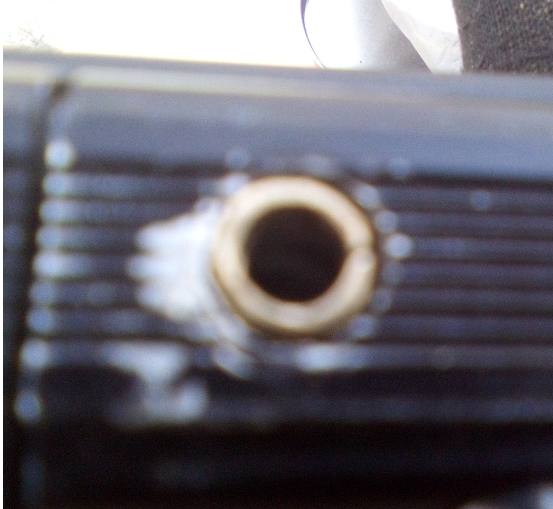

Hard to tell by your picture if the stop light d pishing the pin hole out ( bending or wallering ) looks like it is .?
What i found out s if the stop pin is small or skinny in the larger hole ot will continue to push back and walker the hole more and more. Fattet pins tend not to .
Now not to day it's s sure fix but it stopped all my issues . Movment wallering / damage.

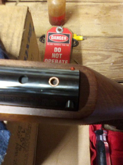

These hole shims i made out of tubing .
One picture os in a r9/hw95 the other is a gamo rail before and after. And solved that deforming jole and no more movment or poi changes.
View attachment 344552View attachment 344553View attachment 344554
That is a great hack, wish I had thought of it myself! Simple and effective solution.

Ya, another thing is if it does hammer back the shim ring takes the damage first before the gun/ receiver. But even on that softer aluminum rail it holds firm and aint deformed it yet when ot sermed ot eas like 500 shots and fix with out it .
( I'll call ot the receiver saver© ) patten pending all rights reserved 😇
I got to give nced for the base idea from his attempt..
