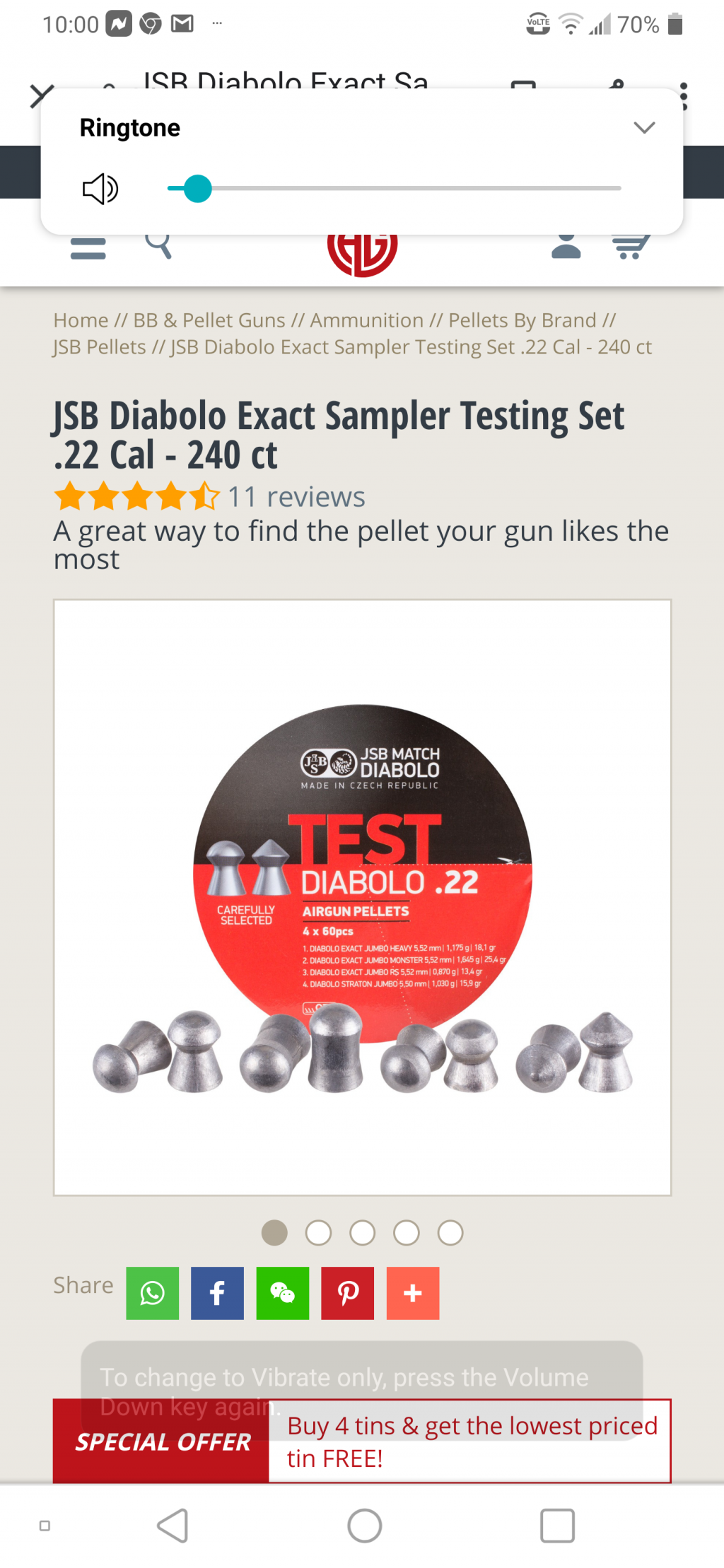

Bulletbob, you are in a "love the one you are with" situation. I would buy this sample pack. Clean your bbl very good, check all screws. A solid mount, decent scope and practice, practice the artillery hold. Correct trigger time is the answer. Good luck with your quest for accuracy.
