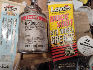

I just use copper never seize on the spring and piston ( aka beeeman lazerlube)
Then a little smear of white lithium grease on the locking chisel and 5th wheel grease in / on hinge bolt and shim washers then a light coat of sillycone paste on the breech seal.

5th wheel grease is one that never dawned on me to try...🤔
My go to for everything that doesn't get the Ultimox treatment

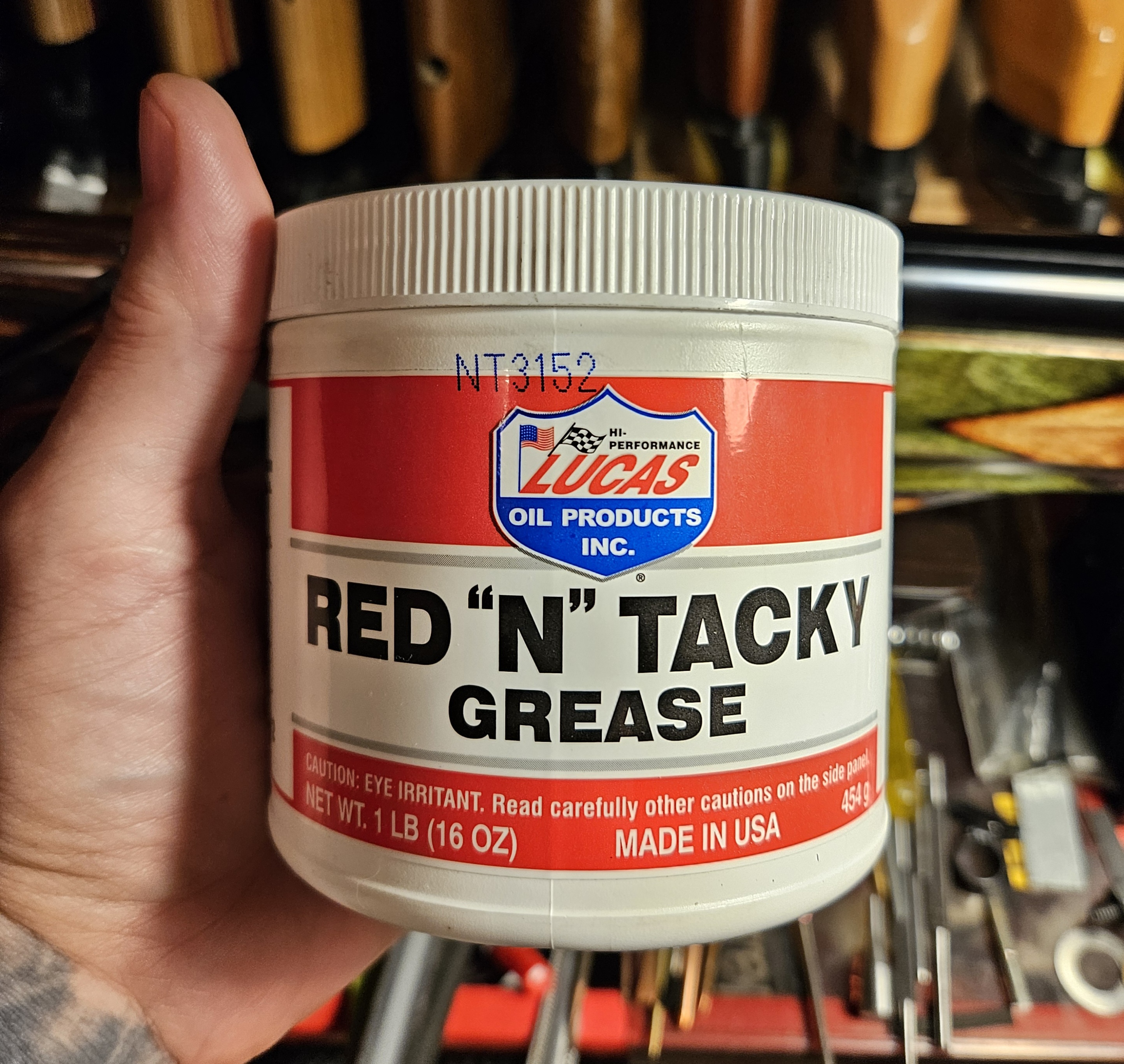

I just assembled my HW95 using Jim Macarri's Moly grease on the piston and seal then Vortek's red grease on the spring. I believe the red grease is Lucas Red 'N Tacky/ All things work perfectly.
I can not swear to it under oath, but I believe that the Air Venturi 'tune in a tube' is also Lucas.
I remember someone on the old GTA recommending Lucas way back when, and used judiciously, it has served me well to date.
