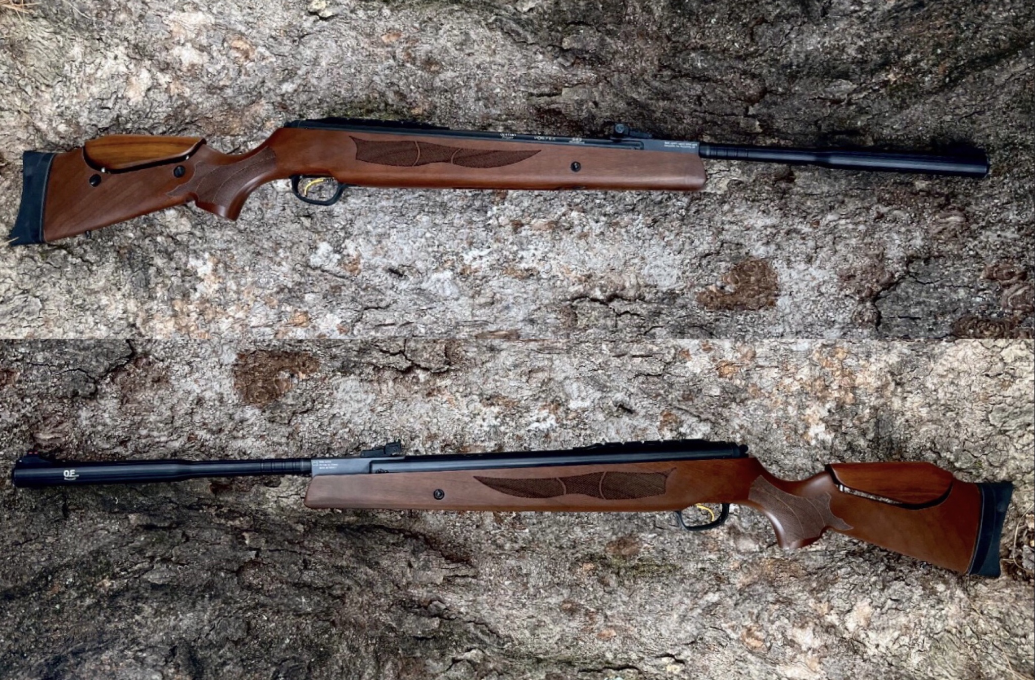

I have the Hatsan 135QE. Been through the entire gun and trigger with a tune. 25 caliber. It’s a great gun for the money. I have a bum shoulder so it doesn’t get shot much. I had the 22 caliber as well but sold it here to another member. Just had to keep one. Both the 22 and 25 caliber are the sweet spots for the 135. They're heavy but so well balanced that you don’t notice the weight. Cocking effort is heavy but I’m 67 years old with a bad shoulder and can one arm cock them all afternoon. Well at least I could before this new shoulder issue. It’s a gun that needs some tuning when it’s new. Unfortunately the newer ones are not finished as well as they once were.
I have the Hatsan 135QE. Been through the entire gun and trigger with a tune. 25 caliber. It’s a great gun for the money. I have a bum shoulder so it doesn’t get shot much. I had the 22 caliber as well but sold it here to another member. Just had to keep one. Both the 22 and 25 caliber are the sweet spots for the 135. They're heavy but so well balanced that you don’t notice the weight. Cocking effort is heavy but I’m 67 years old with a bad shoulder and can one arm cock them all afternoon. Well at least I could before this new shoulder issue. It’s a gun that needs some tuning when it’s new. Unfortunately the newer ones are not finished as well as they once were. View attachment 367874
Ive noticed that too. Like late models get some cost cutting compared to first/ early.

My 135 in .25 caliber shoots around 800 fps. If one wanted the 135 in 177 caliber I would highly recommend a synthetic stock. The Walnut stock will get eaten up. I filled a Hatsan 95 22 caliber Vortek to 150 bar. Totally ate the stock up. To much for the Walnut.
I saw three new 135’s in a gun shop last summer. 177, 22, 25 caliber. I could file my nails on the receivers. The Walnut stocks had no figure at all. Very rough sanded and finished right over the belt sanding lines. Probably could still be tuned into something good but I would want to be holding the one I’m getting.
