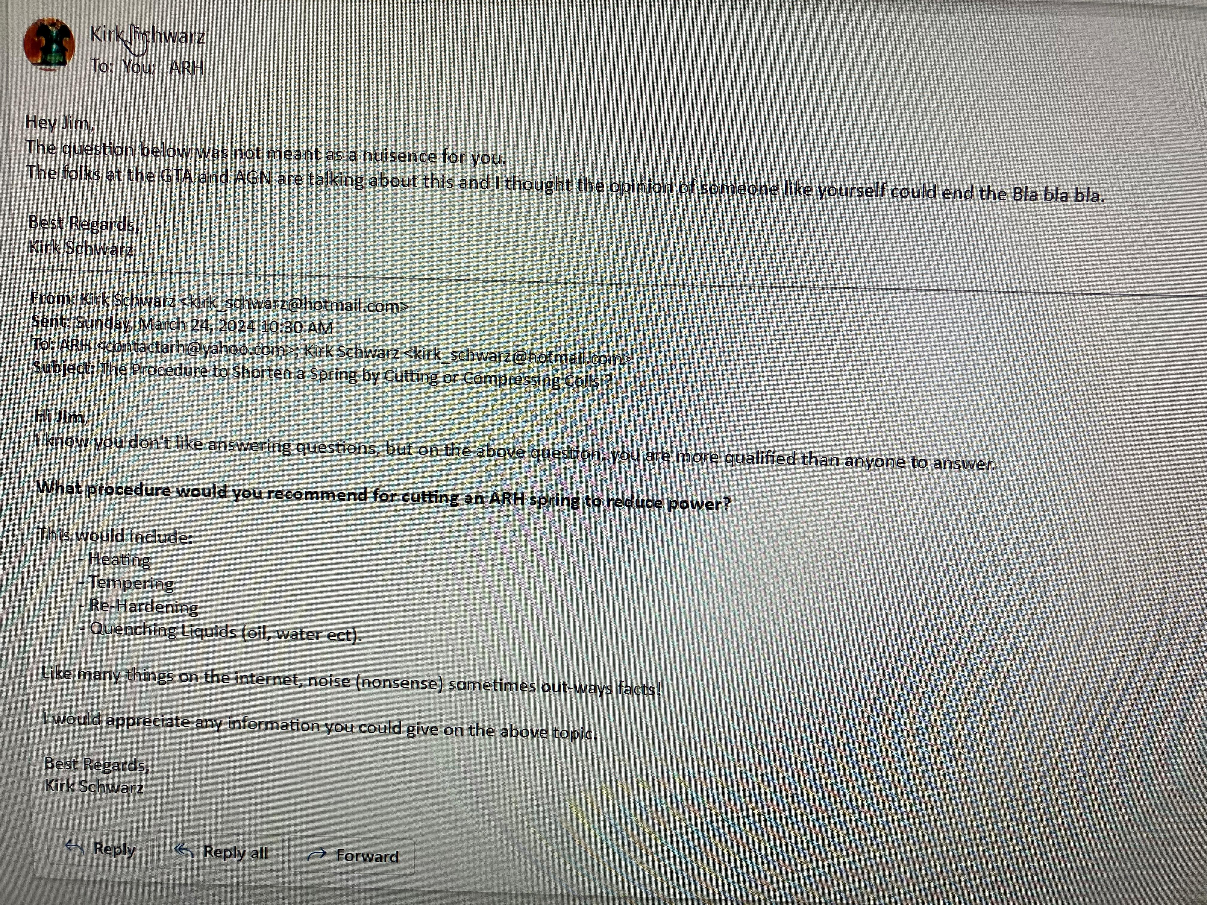

Hey Guys,
I sent him this Sunday:
Jim Bentley is likely correct - JM likely won't respond:(.
He has learned some people are not responsible for their own mistakes and doesn't want to be involved in someone else's mess.

Hey Guys,

Hey Guys,
