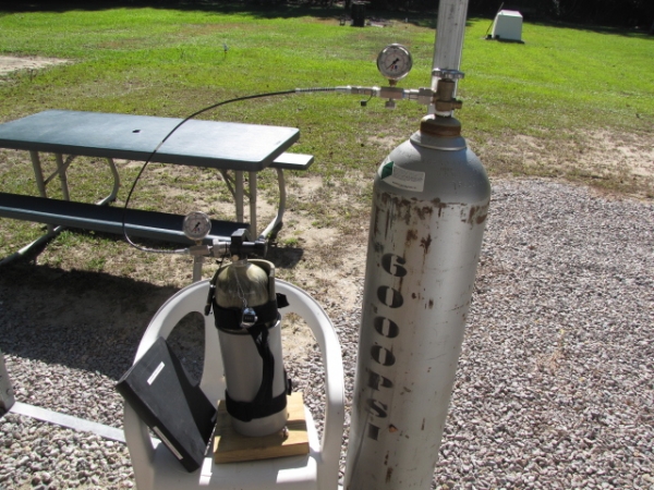

I started with a Paintball store and taking my tank there to be filled. The drive and the fact they could never get it above 4000psi soon ended that ordeal. Then I went the compressor route with a used Shoebox . It didn't last long and started giving me problems. I contacted a local welding supply and lease a 6000 psi nitrogen bottle that I use to fill my 4500 SCBA tanks now days. Been doing the Nitrogen for over 4 years and no complaints except it is a little expensive. I figure it costs be a $1.00 a day when all is said and done so that's OK with me.
