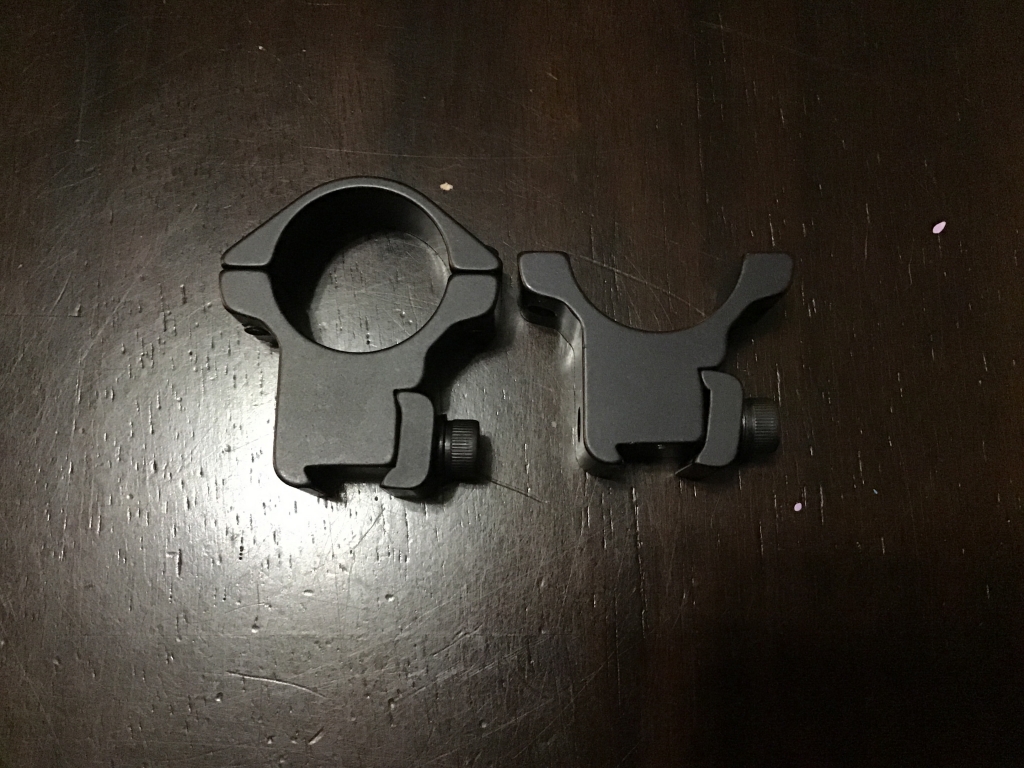

Which of the two rail clamps is the right way for 11 mm rail?
