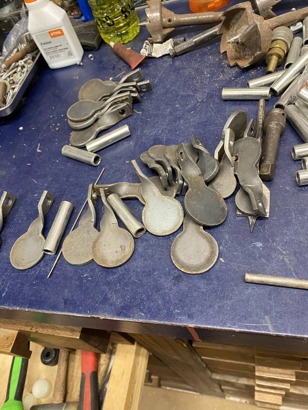

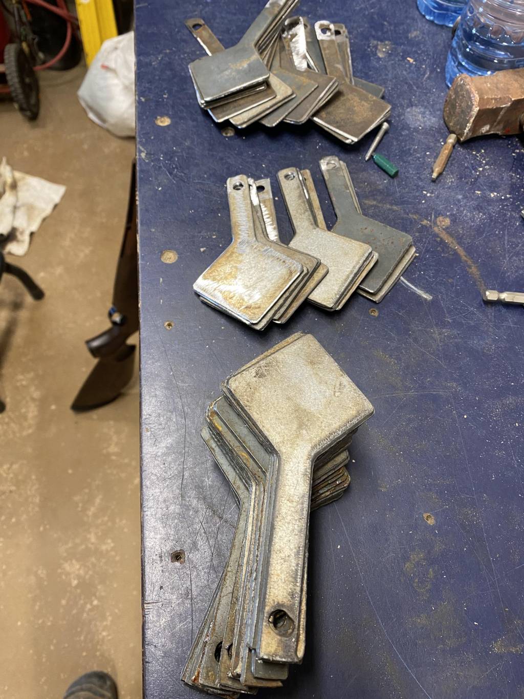

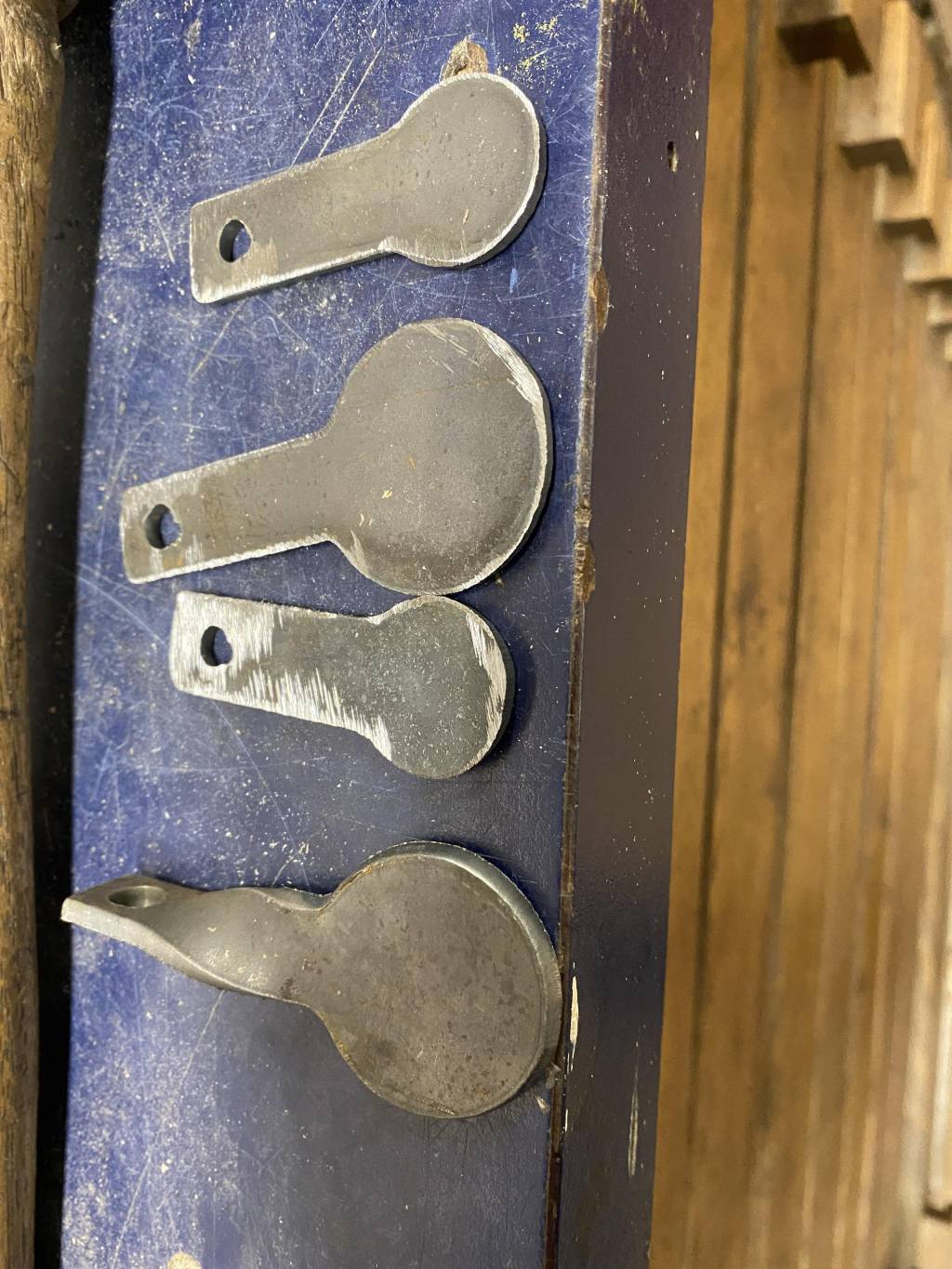

I have a friend with a fab plant. Has a plasma cutter with C&C machine. He cut me some heavy duty spinners 1” and 1 1/2”. I have to clean the hole, grind them clean, give them a twist and a blast of paint. I have 200 coming with different diameters. They make awesome targets. Crow

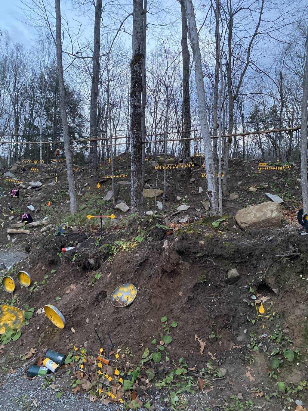

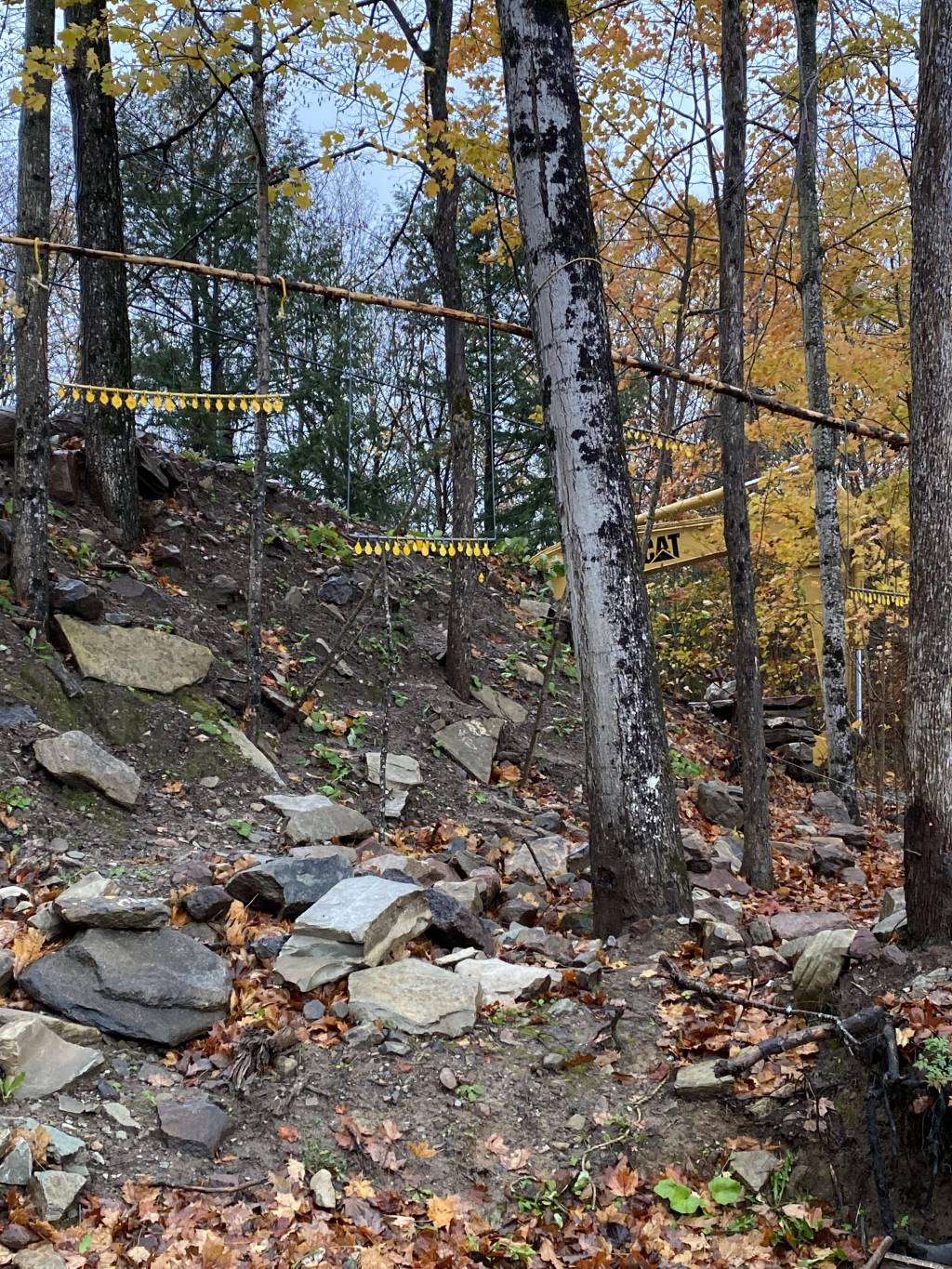

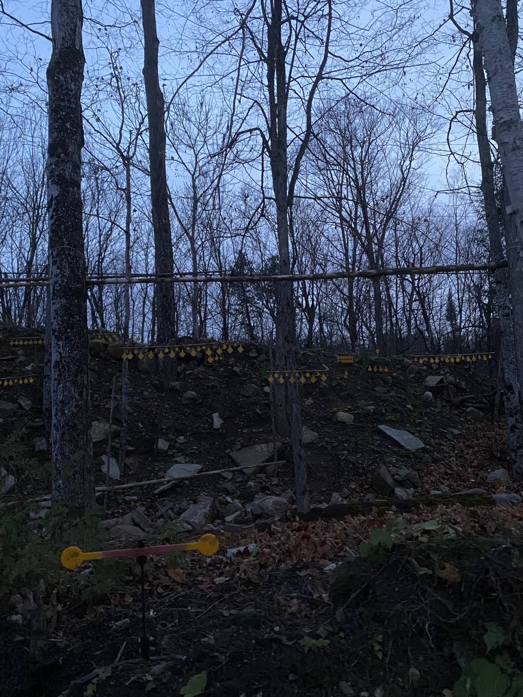

Made more spinners. Now these will hang from branches or I’m using a pole. Reason, soon be buried in snow if left on ground.
 The poles I get at my buddies near Algonquin Park. Their up to 35 ft. long, skinny, straight as a die, dead, dried out and strong. I got a few to hang my spinners. Just tie into trees.

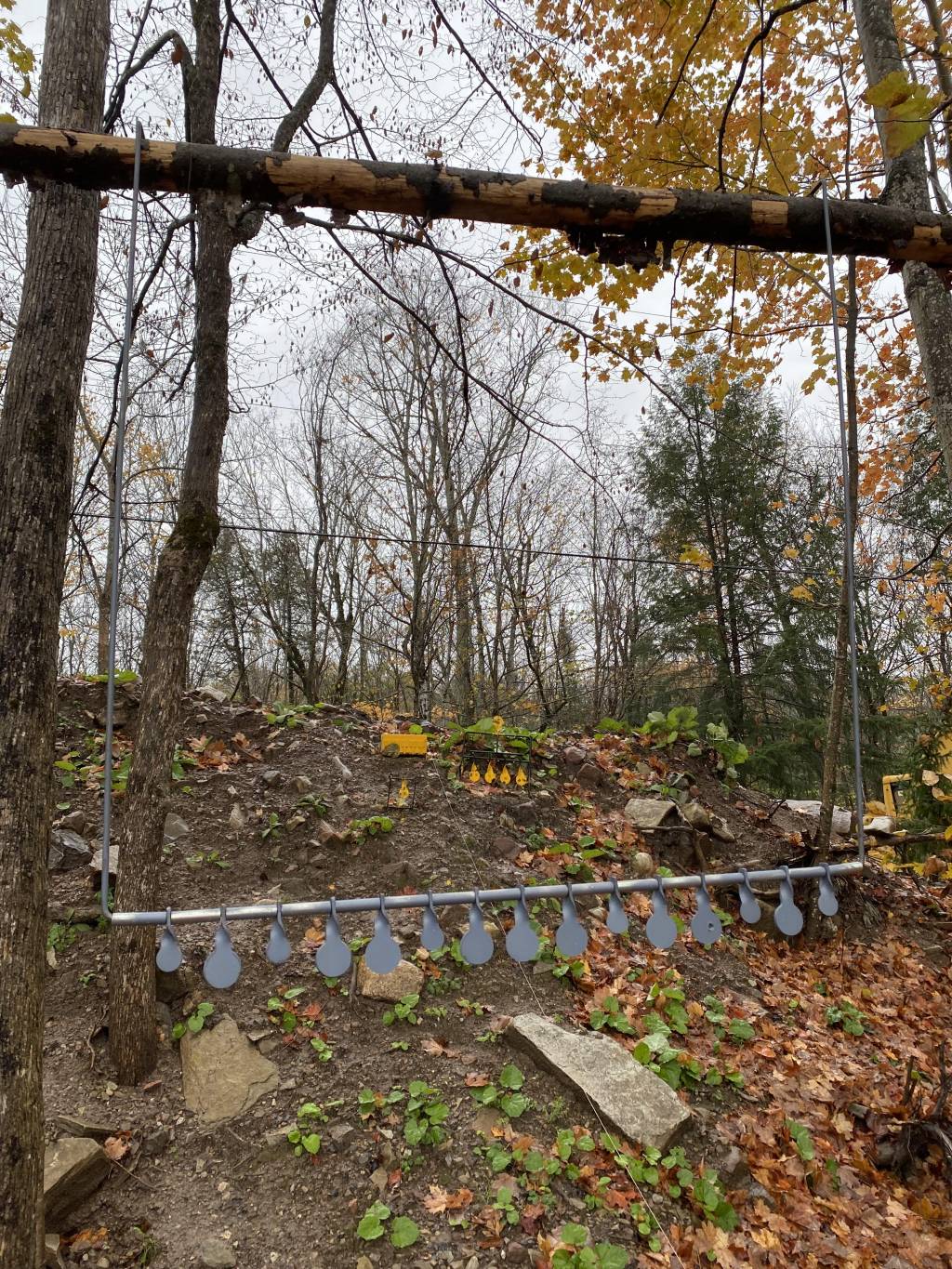

 Kitty in background, gone on Wed. These spinners will last indefinitely. Easy to make 1/4” rod, 3/8 I’d. tube for spacers between spinners. Bought my first 39 spinners on Amazon proximately four dollars each.
 These are 1/8” thick,I’m going to go 1/16” on next lot. I find this the most reliable target. I ordered some diamond shaped ones today. Crow
