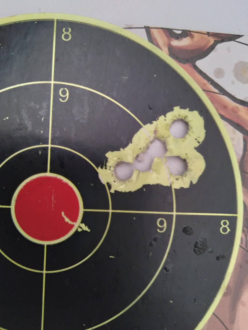

So - what about the Wildcat - it IS an FX rifle with the new Superior barrel liner. FYI - My Wildcat is dead stock - no tuning, etc. I started at power level 7 (slug velocity was 849) thinking slugs want to be shot really fast. Groups were pretty good at 35 yard but the groups were bouncing around - lots of flyers. Same thing at 50 yards (that's all I have where I shoot unless I go to our gun club). So I decided to try power level 6 (slug velocity of 836 fps) - magic happened. 1 hole groups at 35 yards and 1/2 inch groups at 50. iStrelok had issues calculating the proper holdover so I had to use the adjustment feature to fix that. But - I have a good slug load with proper aim points for the Wildcat now.

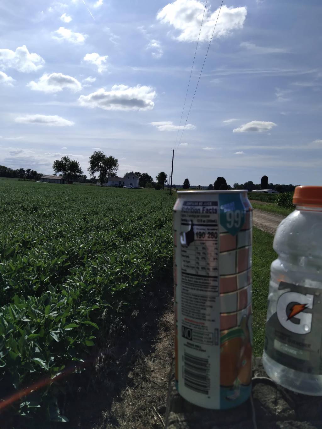

My taipan vet standard does this w/ .25 hybrids shooting them at the described 830-835 fps ( this was 5 at 50 yards). Stumbled upon this as i bought the hybrids for my cricket and tried em in all my guns after the cricket didnt really like em too much... But yea I've tried them out to 160 actually, not groups but I was popping cans off a post @ 161 yards in front of my house...I was stoked to say the least! What really struck me was it only took 8 shots total to take 3 cans at that distance! They actually seem consistent!
-cans on the post, my shooting table is behind the car in the driveway
