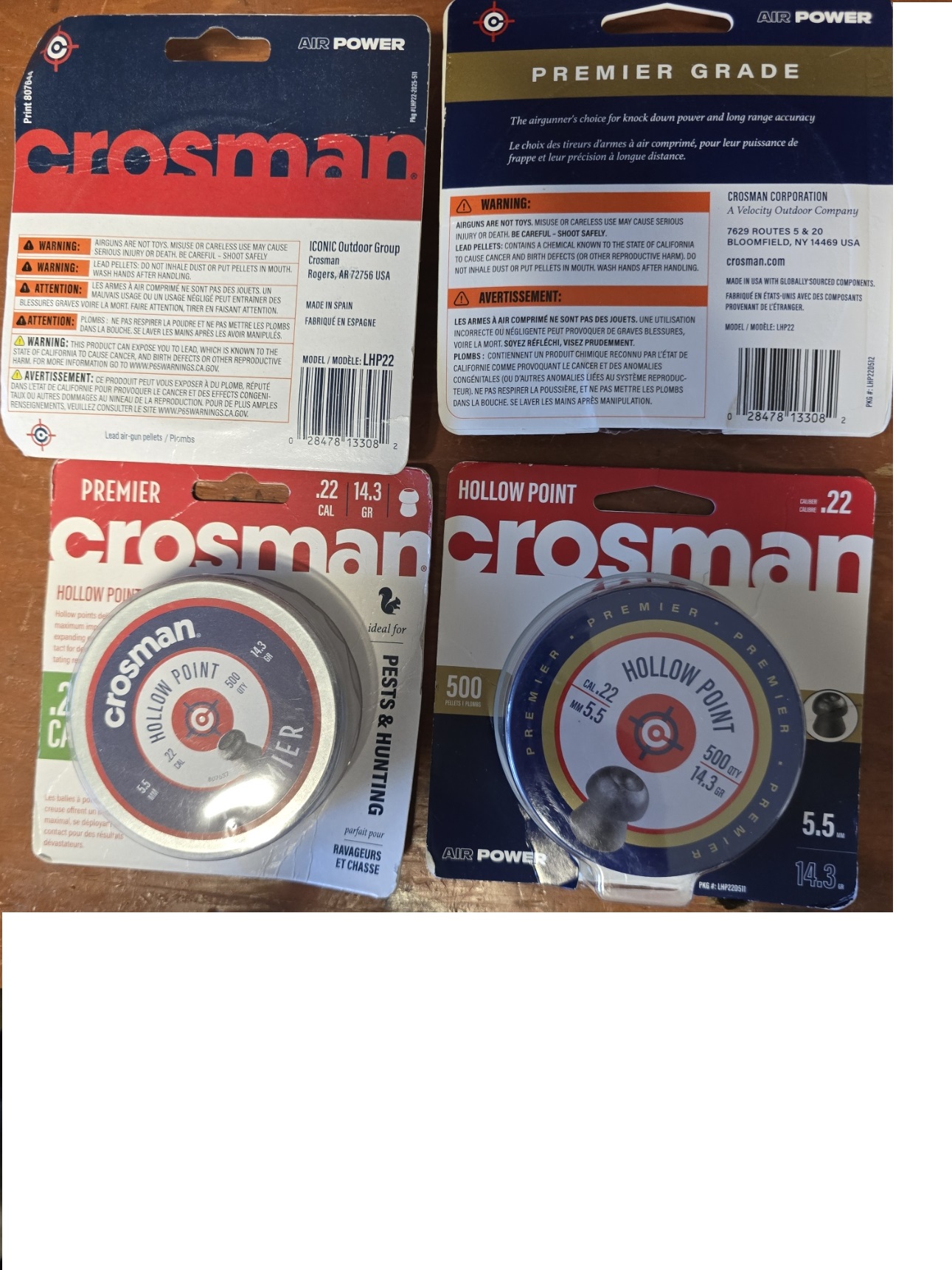

I have a bunch of US CPHP and about (10) tins of the new Spanish made CPHP.
TThe Spanish ones are shinier and seem not to have lube, not as much lube, or a different lube.
I've been testing them in my .22 Streamlines, DRS, S510 and come to the conclusion that they don't group quite as well, out of the tin as do the US.
I'm going to try sorting by weight to see what results, and am thinking of trying some different lubes such as Fluid Film (lanolin-based EP lube) and/or WD-40 Specialist Dry Lube PTFE Spray which is obviously not ordinary WD-40.
Has anyone any experience with any of these factors?
