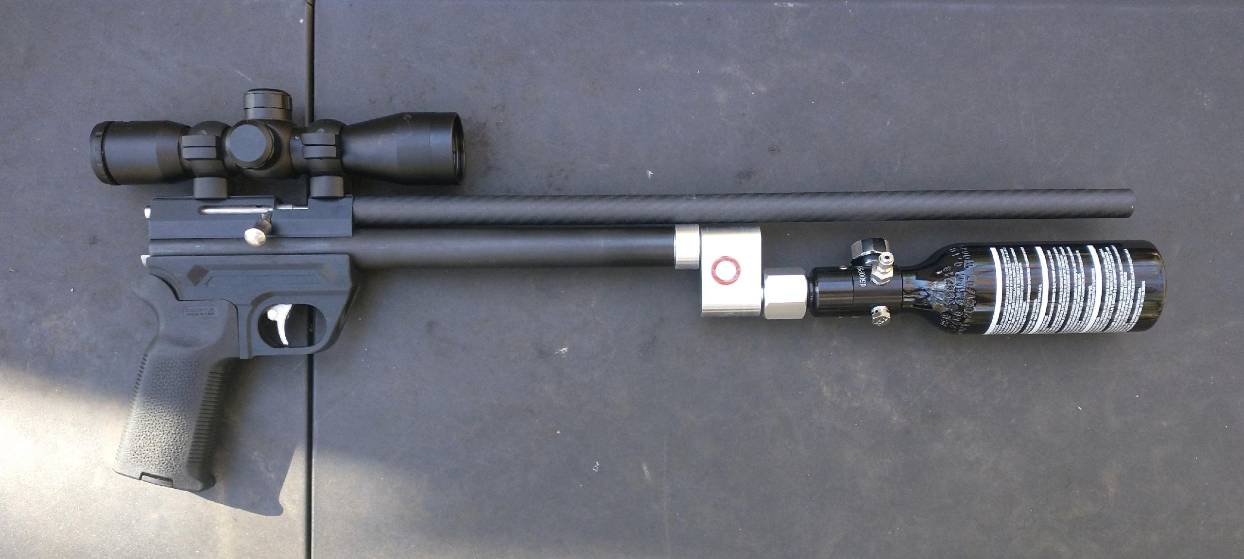

Here's what I did to mine. 48 shots at 18 fpe.
