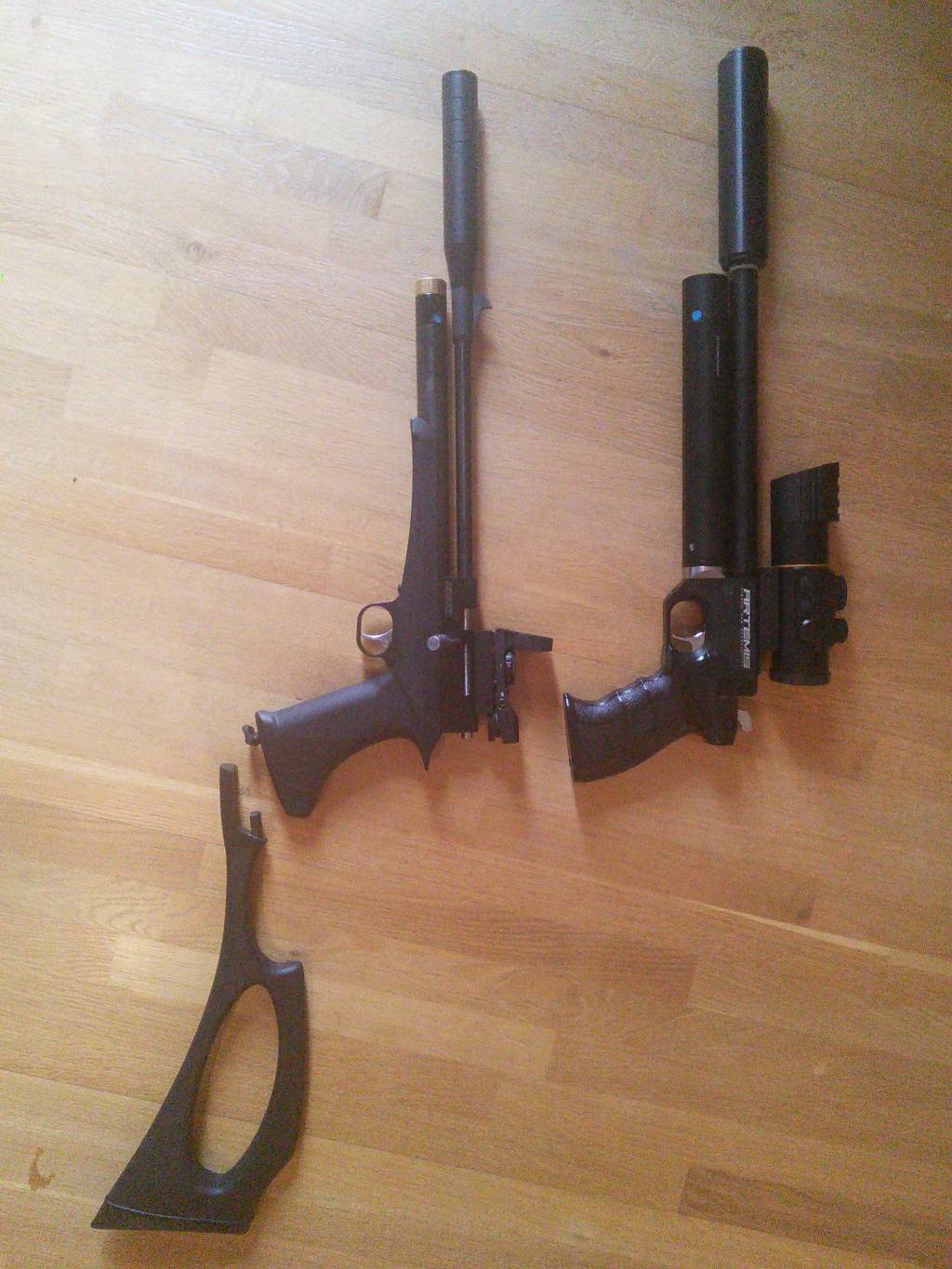

Great accuracy. Some reg issues, no safety. Even with a silencer, a loud pop due to the concept of the breech & transfer port.
I prefer the equally accurate pp800 repeater for those reasons. After putting in a Lane Reg and borrowing the stock from the 100 USD CO2 package that also includes a shoulder piece and a long barrel.
I fitted a Huma reg, a Theoben barrel and had the trigger polished. With JSB 7.3s, it shoots sub MOA at 50m which surprised me no end. Extreme spread of 6fps on average. It’s not easy doing so with a pistol though but it’s me not the gun when I don’t get it right. I shoot small metal silhouettes at 50m and in windless conditions often get 10 out of 10 hits. It’s a blast.

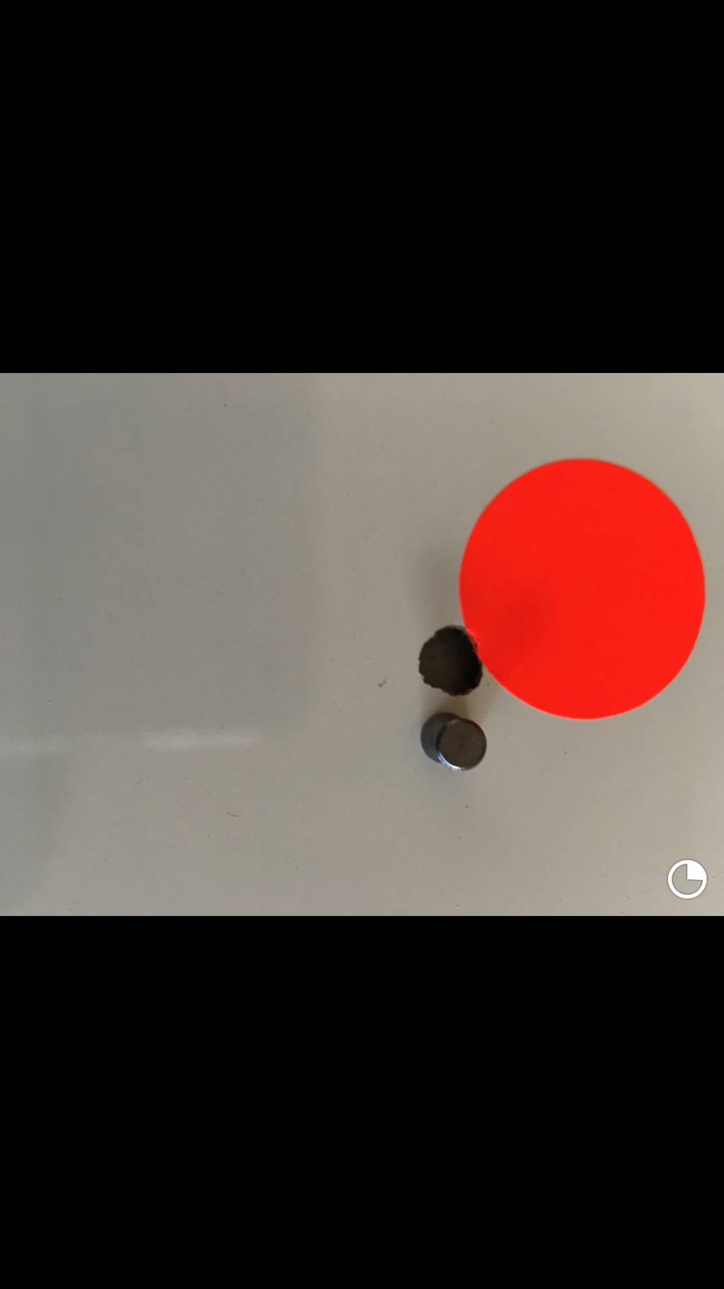

This was the first group I shot at 10m after getting the pistol back, and showed what accuracy was to come at longer distances
