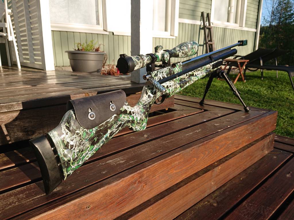

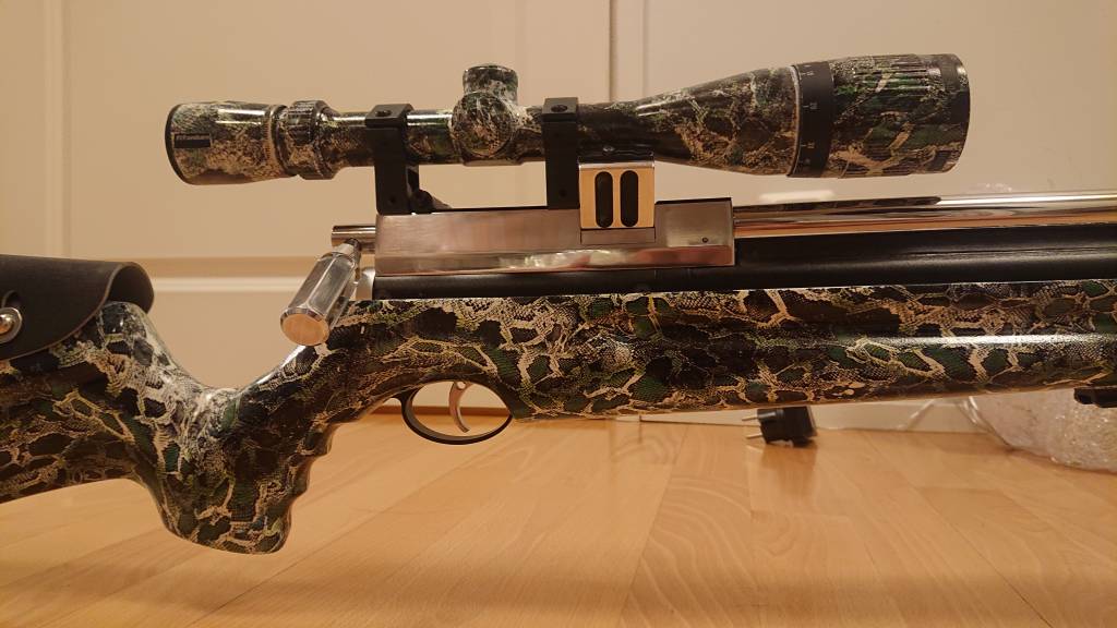

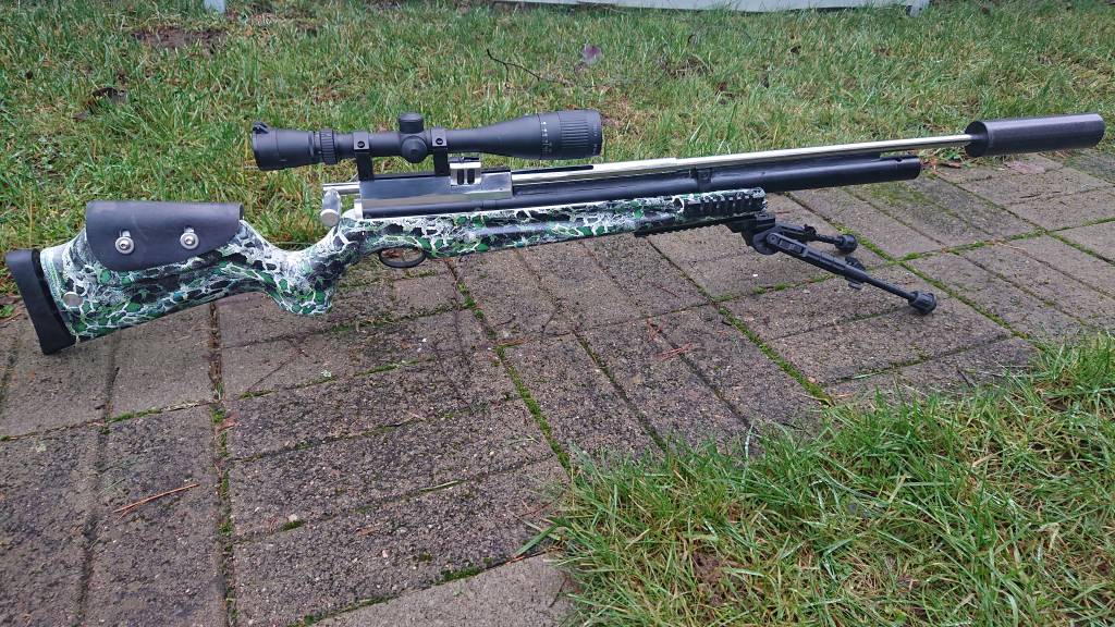

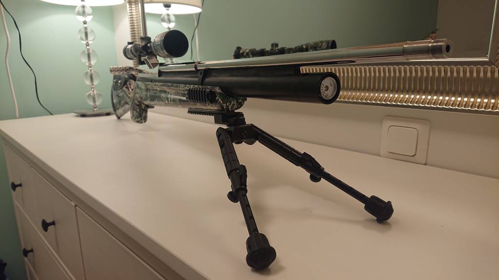

Spa M10 100fpe .22
Ready to rock 😎
Man, that action and barrel+ blinded by the light! Love it!
The pattern on the stock gives me the willies. Too many close calls with diamond backs here in central Tx. GRRRRR!!!!
Almost stepped on ones head just stepping off the steps here at home. I was hovering my foot right over his head by about 6-7 inches. He never tried to bite, but scare the dickens out of me!
Of course, I shot him and fried him up. A Texan thing. LOL!

Haha! Did it taste good tho!? I used to have snakes for over 15years thats where the fantasy for the pattern comes from lol. But I assume snakes are type of animals that devide ppl some love some cant stand them.
Well that is weak point.. I had that issue after 50shots or so.. Its made too weak. You can email dirrectly to snowpeak airguns and ask for new it will cost you something and will mostlikely take months to ship but they atleast used to do that. But be warned I noticed on my trigger action that chinese tolerances are so horrible the replacement that I got didnt work so I had to make new one my self generally its so simple part you can make it at home with bit effort but remember to use steel.. I made first new one from aluminium and well let say it did wear out quickly.

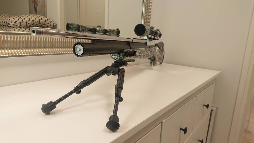

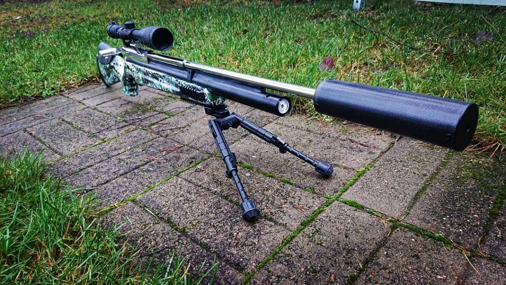

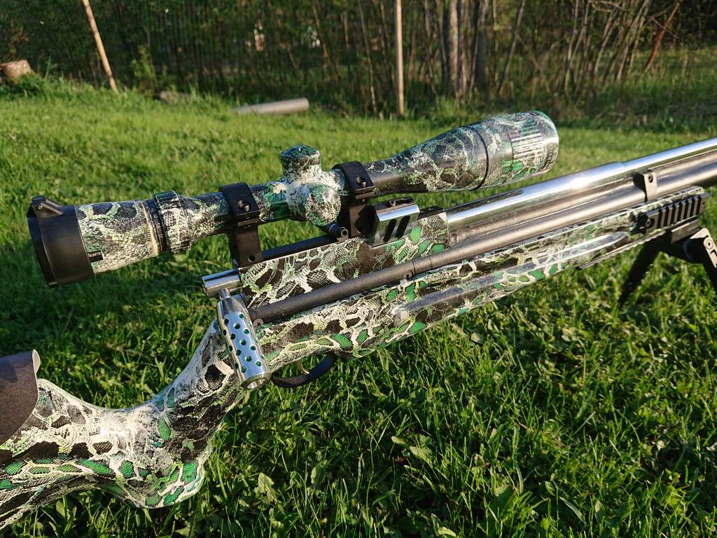

Upgraded spring forced mag and stiffened 15mm barrelend with 20mm carbonfiber so barrel is at 20mm whole lenght. Band on aircylinder needed to be fully redone since I didnt want it to touch barrel at all and its freefloating now. Slow and long progress but its getting there slowly. Next step might be fully redo upper to add some lenght so barrel connection would be more solid.Â
