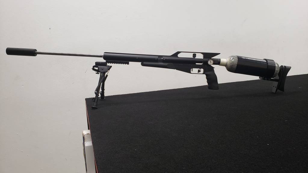

Very enamored with your build. On the Raptor, I should have a custom valve soon. A Don Cothran. It hopefully with be a prototype. I added an Accu-Tac G2 bipod and just installed a Ergo Zero Angle grip. Makes bench work much easier. The AccuTac is built like a tank. Very impressive and stable.

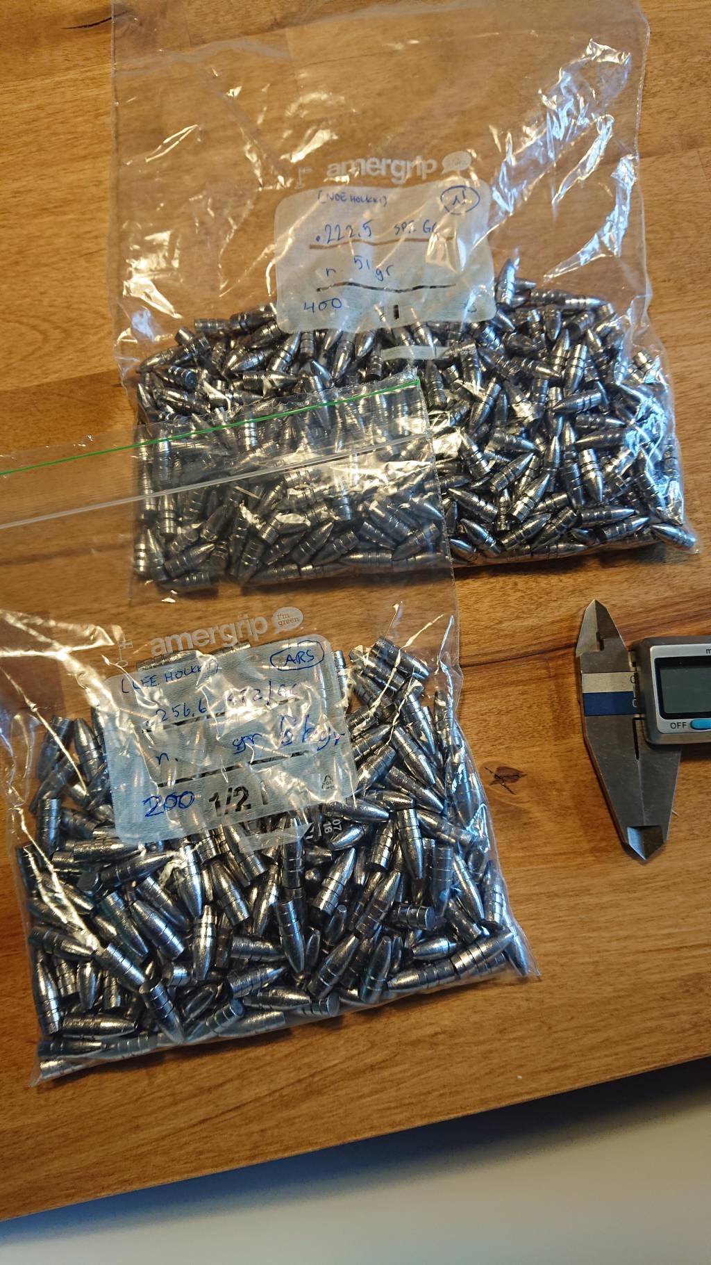

I just changed out the .223 barrel and am testing a Superiors Heavy liner for a little research. So far, so good. I had dismal results with it choked, and removed it. Much better but not impressed. Every Bullet I tried was scattering. I decided to try the HP pictured above. I mainly Hp'd it to move the CG Rearward. Boy did it work. But have only tested at short ranges. Testing more in a few minutes. It is heavy CF Wrapped to end up with a full bull barrel with CF for stiffening extending the full length into the action block.
I am considering making an new air tube a bit longer as is featured on the full size Raptor. Mine started as a Mini. So more work ahead. LOL!

The spitzer you show looks all the world like a 338 .257 Lyman of old. Extremely accurate in My Talon/Dor .257. ;<)

Damn that bipod is on my wishlist too! Wonder how that new valve will work on 257. Stock raptor seems to be bit too tame for 257.

Haha that 388lyman is superb. I run 257388arsenal through my texan 😉

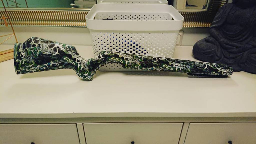

Refinished the stock on M22, put in 2 hair curlers after telescoping the shroud out a little. Very silent. I also replaced the stock reg with an Audrius (further enlarging the already large plenum). Replaced the hammer spring with dual springs to increase 70 joule shot count to around 25. Very accurate at 70m with JSB King Heavy ll. Only had to replace the stock gauge by a 3.5usd m8 unit from Aliexpress because it was inaccurate and then broke because I overtightened it.
