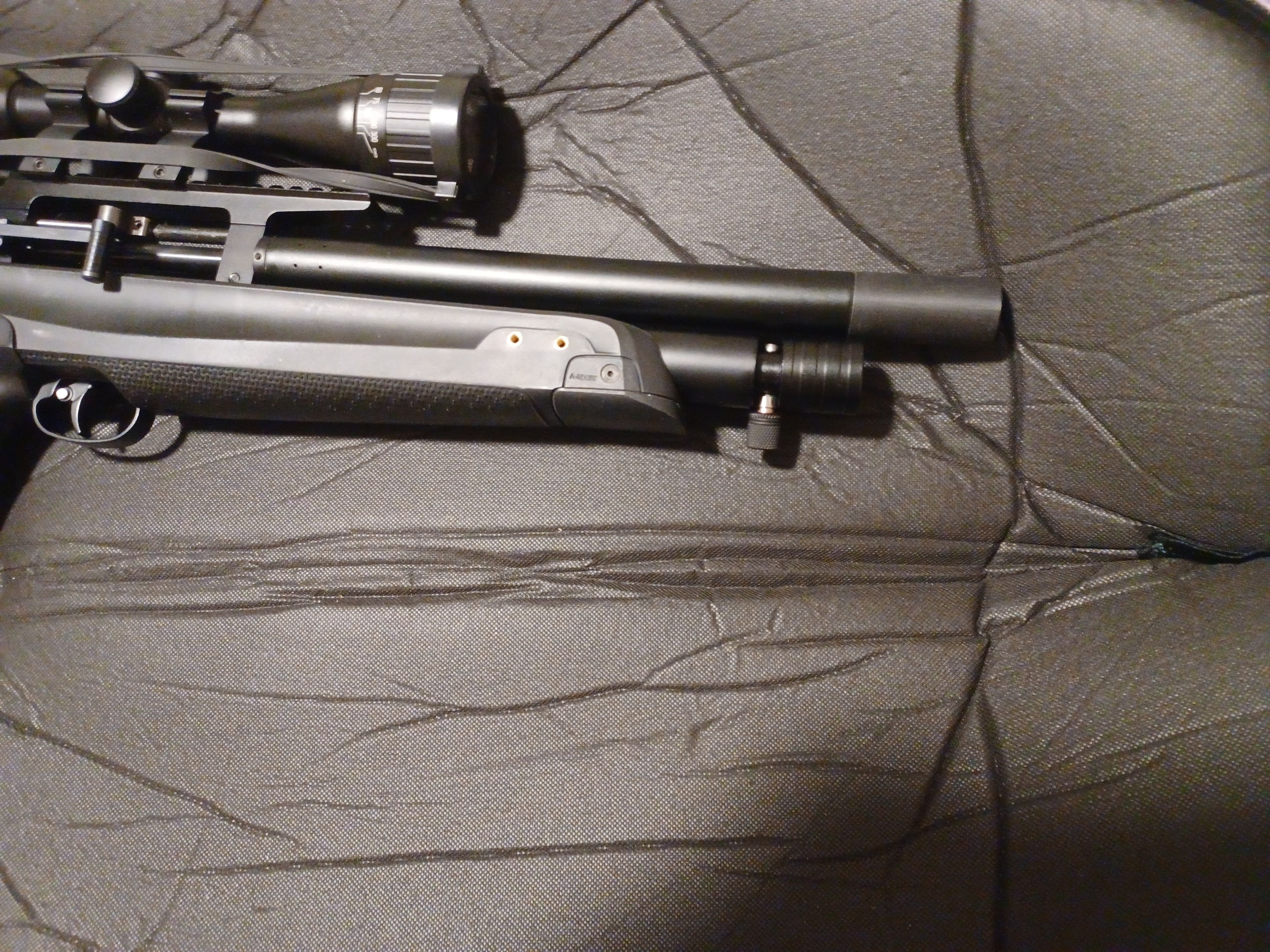

I have been working with several members on the GTA site testing for both the P35 and Bullshark. The P35 has more room to work with so the inserts are sized a little different length wise. Here's one photo of the screw-in insert in my Bullshark and a photo of some of our testing inserts. When using the internal shroud insert the shroud has to be slid forward an inch or more depending on which gun you're using it on.

I'm sure it is possible to end in a 1/2 UNF but I would be worried about how strong it would be. Could it withstand normal handling? Seems like the plastic 1/2 UNF piece would be the weak link if the moderator got bumped. Keeping the in shroud and out of shroud portions in the same printed piece leaves their diameter larger for even more strength.
I may worry too much about strength after breaking my buckrail moderator for my Prod. Nice moderator but I was not gentle enough with it. On my P35s I push the shroud forward to have the moderator stay inside the metal shroud. That way they are protected. You can do the same thing on a bullshark but the gap at the back of the shroud will be about 1.5 inches larger. The support points for the shroud are the same distance apart as on the P35, however.
