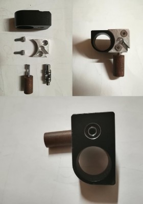

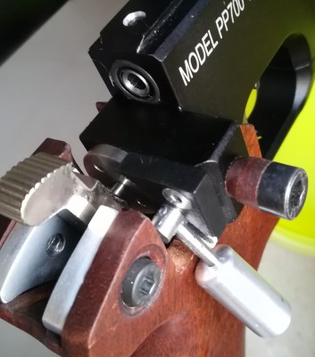

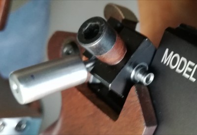

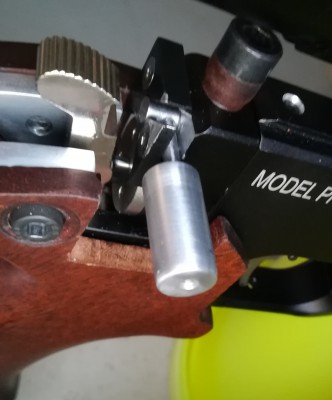

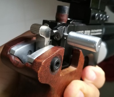

Hi all,
I already sold mine, but before that I developed a kind of carbine breech that works a treat:
