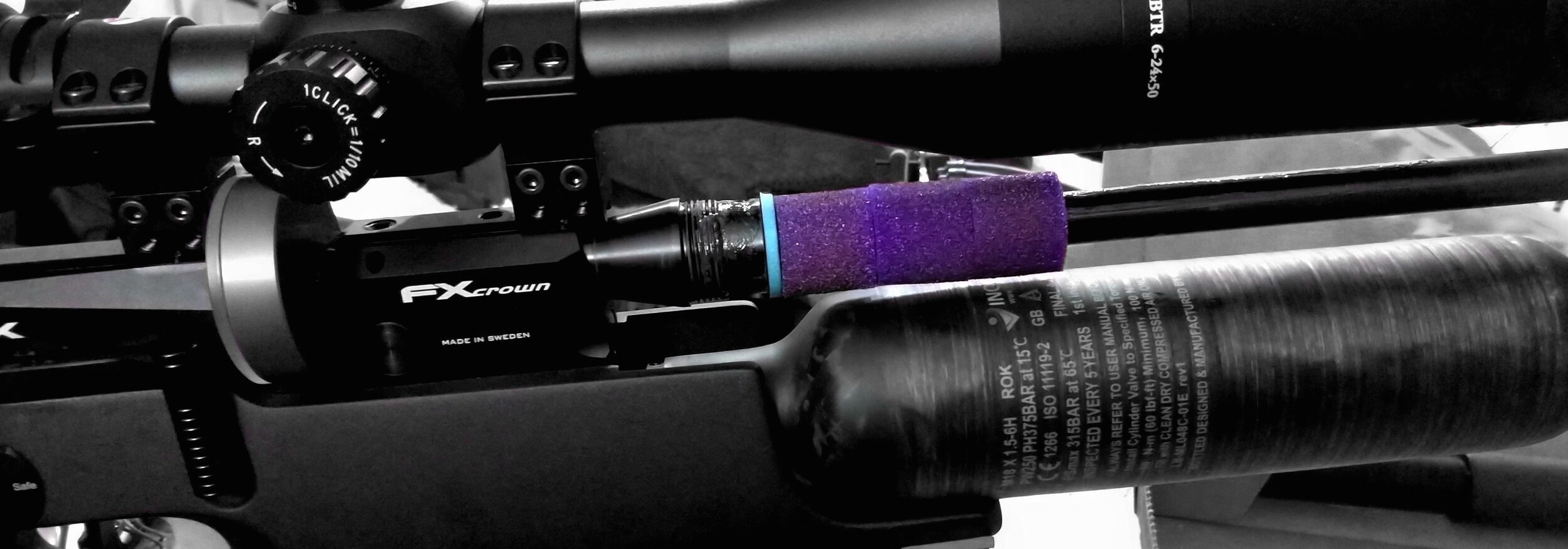

I wrapped my barrel in scotch bright pad inside the shroud. With a buckrail ldc screwed on the end of the shroud it was totally quiet. I was using the one designed for the avenger on my liberty which uses the same barrel shroud.

I've heard that those pads will work. Hair curlers foam is also a good one to use.

STO sells foam for shrouds to dampen the sound. He talks about the pressure waves. https://www.silentthunderordnance.com/air/shroud-damper
I've been making moderators for years and stuffing moderator space will NOT reduce sound volume. It will change the sound signature, but not the volume. Of course everyone is welcome to reinvent the wheel if they wish. Using an inverted cone baffle and large expansion volume is the magic ticket to sound reduction.
Correct. Internal volume and deflecting in back into the shroud will reduce the DB. The PING or PONG noise is very audible in some shrouds, which makes it a more noticeable sound to the ear. Making that more of a flat tone would help reduce the perceived noise. Some shrouds even have an echo to them, like AEA guns.
