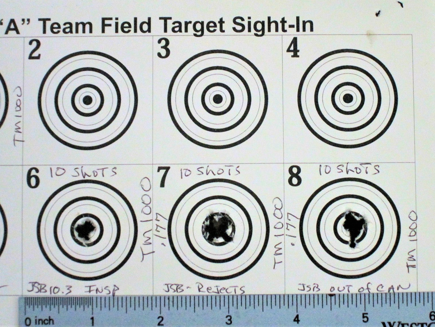

If you shoot in competition and want your rifle to shoot consistently, weighing pellets is highly recommended. It may make a small difference, but if you shoot a "9" instead of a "10", you may lose the match.
Lot of factors involved there. Regulator, consistency of hammer strike opening the valve, air transfer port size/design, smoothness of bore, the choke, and there are intricacies involved in each of those areas as well. After addressing each of those areas, I get 10-12fps ES over 90 shots with my Daystate Tsar straight from the tin.
Edit: That said..when I do sort pellets by weight, I would separate by 1/10 of grain with .177 caliber and weed out the extreme variants. Shoot the median weights at competition.

My recent experience with a .177 Crown MK2 has convinced me the using a Pelletgage to sort by head size is beneficial if you want to try shooting for tight groups. I have repeatedly found smaller groups when shooting sorted pellets vs straight from the tin pellets. Now I will confess that I’ve only compared the results three or four times. I’d like to sort enough pellets to shoot ten groups of sorted vs ten groups of non sorted and have more definitive results.

For every day plinking, you don't need to sort -> very much a waste of time, but if you want to shoot MOA groups at 100 yards - need to remove as many variables as I can. Have already tuned the valve, hammer and regulator - so now working on pellets.
Out of my tin of 300 JSB 33.95 MKII pellets, at least 15 pellets had a 1 grain weight variance - guaranteed No 1 MOA group with those mixed in :whistle: .
