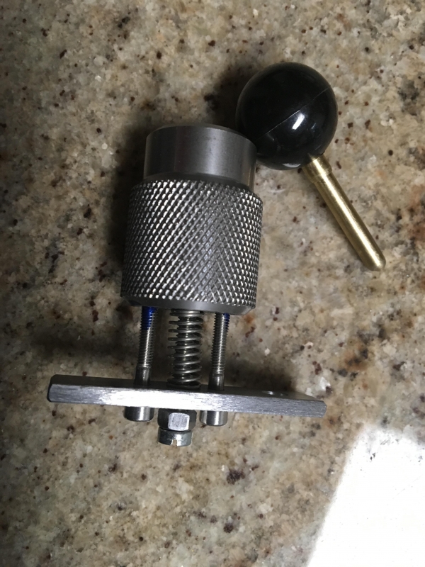

I have found that as long as I size by weight then by diameter I get consistant results with all the ammo sorted, provided that I size them for the correct diameter I use the TR Robb pellet sizer. After weighing and sizing I may have to adjust the reticle slightly for each batch. I like the Robb sizer as it allows adjustable diameter of pellets. The only problem it can only make pellets smaller. The ones that can’t be properly sized go into my plinking box .
The way the sizer works the hole you but the pellet it is tapered, you just set the depth needed for size then push pellet in using the brass rod,then pull back on the spring loaded lever to eject.

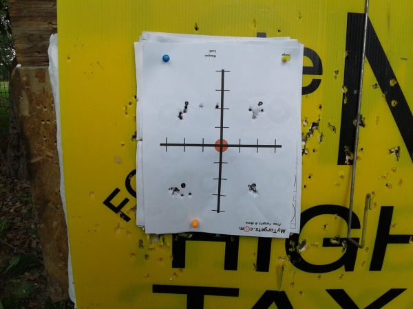

Okay the follow up on the Sorting I've got about a 20% 6.36 head size the rest are 6.37 this of course is only 25 caliber impact frame. You'll notice the left upper quadrant is my sighter quadrant and the first six shots 636 I moved to the right upper quadrant six shots 637. I usually find that my first 10 shots or so are getting used to shooting again shots. I get serious after that at least as serious as I can get. You'll notice the left lower quadrant is six shots or so 636 and the right lower quadrant is 637 about eight nine shots give or take all in the size of a quarter or less. So I'm going with a 6:37 s. These are not washed and I'm not washing them because they're waxed they've not been weighed so I may play around with the weight of the 6:37 to see what that does. I am generally a hundred yard shooter with this gun and out.
this is 50 yds.

"Brian10956"I have found that as long as I size by weight then by diameter I get consistant results with all the ammo sorted, provided that I size them for the correct diameter I use the TR Robb pellet sizer. After weighing and sizing I may have to adjust the reticle slightly for each batch. I like the Robb sizer as it allows adjustable diameter of pellets. The only problem it can only make pellets smaller. The ones that can’t be properly sized go into my plinking box .

Brian,
Your pellet sizer intrigues me. Can you tell me where I might inquire about obtaining one? Any tips for its proper use? Thanks!
