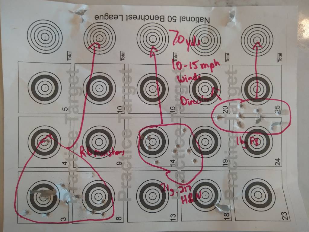

I would hate that! I was gonna use them for pesting in windy conditions but my Uragan is not a fan. My Vulcan 3 was stupid accurate with them though. At 70yds in wind they didn't hold up at all and had a wild flier. Seeing this in my gun, hard to beat a lighter weight yet consistent pellet in the wind regardless of the BC loss. Yeah not a competition shooter but I don't like having fliers when pesting either.
