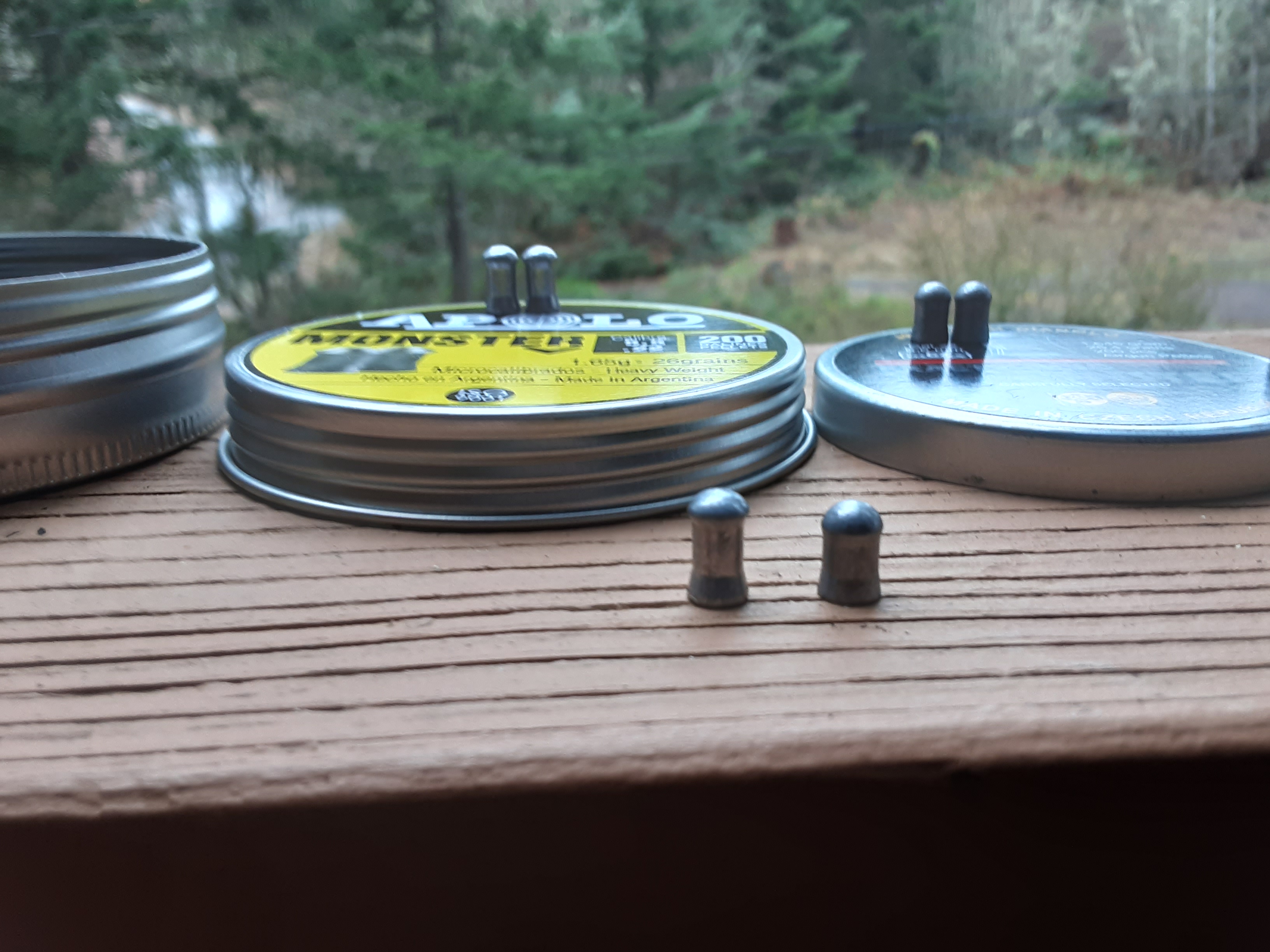

I've had good luck with the 26gr Apolo Monsters. And the older jsb jumbo Monsters 25.4gr. The Apolos are around half the price of the JSBs.
