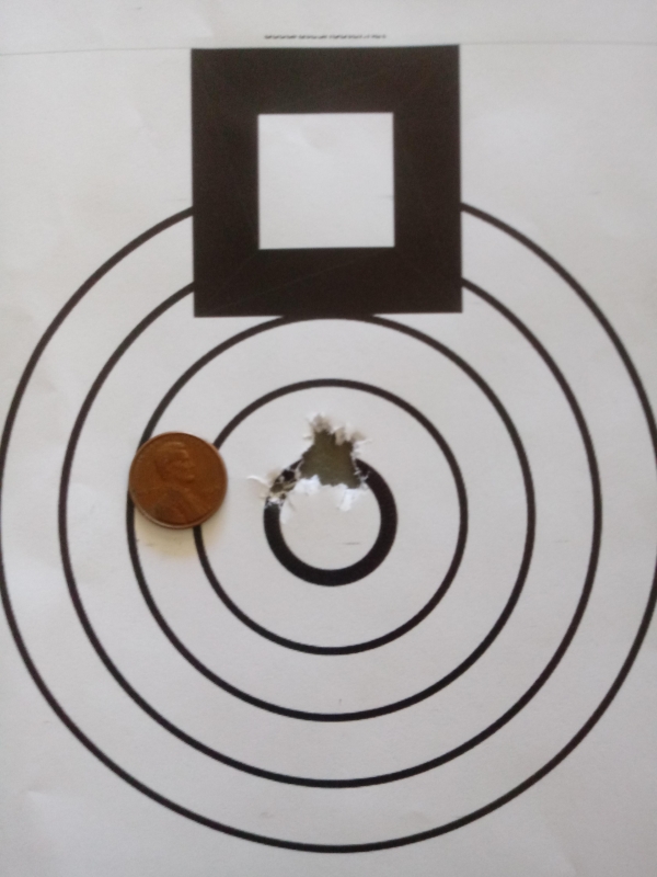

I had my "low-end" Kral doing some 50yd groups. This is a typical 12 shot (1 mag) group. Put a Tatsu from Donny on it this weekend and Now it lives up to its Puncher Breaker Silent designation.
I added a few turns to the hammer spring adjustment and added a hole in the rear of the stock so I can adjust it without removing the action from the stock. Also cleaned the barrel with some JB Bore paste and touched up the crown. Been in contact with Troy from Annihilator Airguns and plan on some "subtle upgrades". It shoots best with the JSB 18.1's at distance.
Thanks Darrel! I'm shooting 18.1gr JSB's (.22) Haven't had any issues in the past year but I ordered a new cocking lever anyway, just plain looks better! There is lots of talk these days about all the fantastic rifles out there, well deserved I'm sure! I just can't afford 2k + at this point. Thats where the "Lucky" part comes in. It seems I landed a pretty darn nice rifle for what I paid.

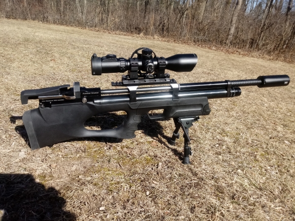

MScottleeman I have to ask more info. since these pcp's are new to me, is that a accutshot 4-16x44ao scope ? rings ? anything else ? Know that you have it dialed in, It look's like you have carbon fiber tape on the end of the barrel shroud, are you going to do the rest of it ? just wondering. I have a 22 cal synrod that I'm converting to bp & I did my barrel shroud & air tube in carbon fiber tape, what a difference in looks . I realize that is each it's own preferance, I sure do like the look of your bp. It would make a good ride around gun. I know most of the guys can take one look at your bp & know every thing on it, but I'm not there yet. Just to much much to comprehend on this forum . There's a wealth of knowledge on this forum and great people, just glad to be here. One of these days I'll learn how to do pictures, pm's ect but I have to say that has saved my bacon. Because I would have a closet full of stuff that I have seen in the selling section. (It's like a candy store!). Thanks for your time MScottleeman & everybody else, your doing a great job ! Darell

Yes Darell,its a 4-16x44 swat scope on medium weaver 30mm mounts sitting on a UTG super slim 3/4 in picatinny riser,bolted to the rifles rail. I put some carbon tape on the end of the shroud to see how it looked and will most likley cover the entire shroud. A DonnyFl Tatsu moderator with the puncher breaker adapter has been added,stock it was LOUD! I drilled out the power adjuster to 3/16 to gain a smidge more power at low setting, stock the fps was Way to low on low power. This way there will be one less thing to do once the Annihilator valve upgrades are done. I did some cleaning on the hammer and trigger components and added a Small amount of moly lube for a finishing touch. The scope is ok but I'm going to go to perhaps a 6-24 for target shooting. I'm not to keen on the reticle either, its a bit to thick for my taste. Thanks again for the kind words...You made my Day!
