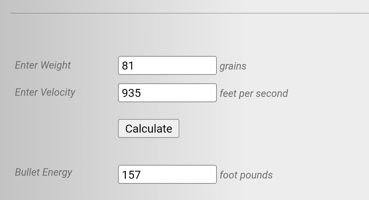

This just in! Paul sent me a pic with some data. Can’t wait to see the shot string with the plenum and air valve upgrade (air valve was upgraded by Wes). View attachment 568551
Wow, that is quite an improvement from stock. hope to read about your experiences with the new plenum and valve. i am a bit scared of installing the plenum myself, tbh. after it took forever to manage to seal the bottle adapter, i am not eager to introduce more possible weak points in the sealing department.

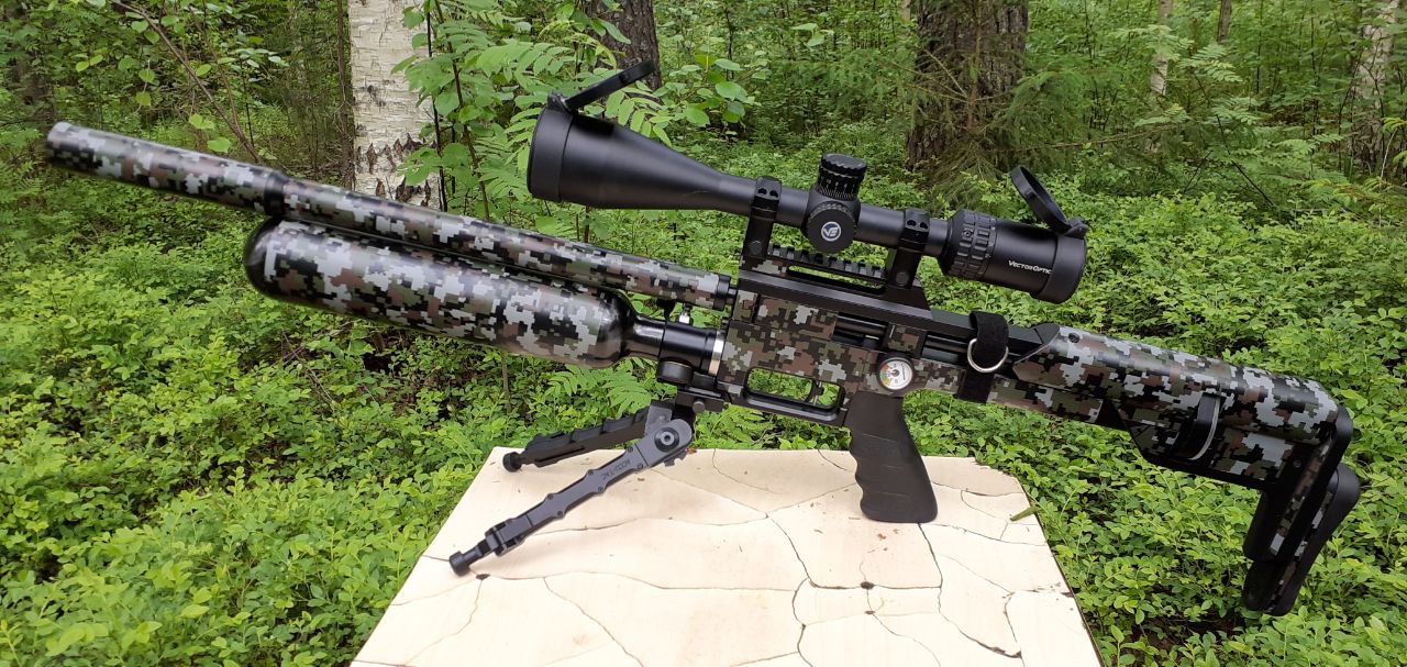

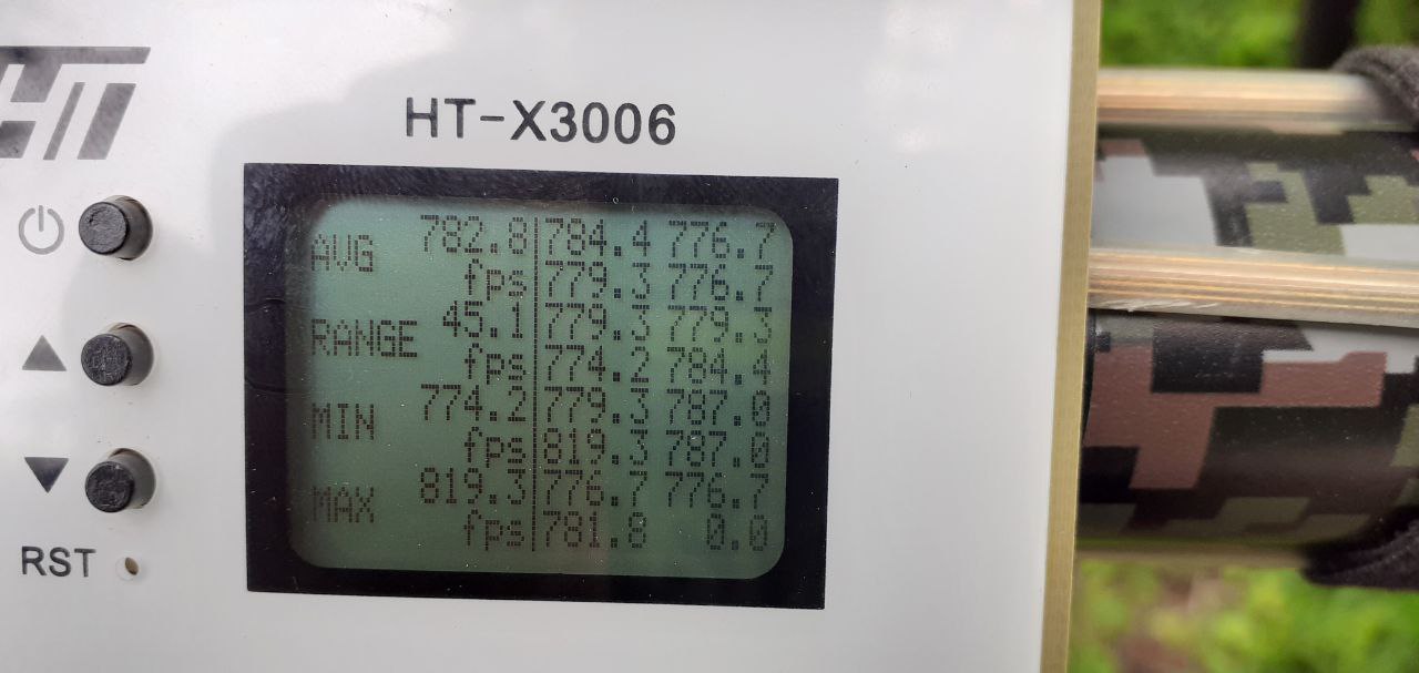

Since the regulator of my VULCAN3HP has a broken o-ring, that i needed to order first, i have been putting the scope on the M60B .357 cal and shoot a bit throught the chronograph. i have increased all possible port sizes and also have @Paul D's 'power valve' installed and the max. power i got so far was 150joules / 110foot pounds. i tried with reg settings from 140-170bar and various hammer spring tensions. (with the new valve the HS actually lets you adjust the power, in a wider range, than with the original valve).
here's some numbers, i think the 819.3 fps wasa double feed.
i've been shooting snowpeak 80.87gr pellets. besides a .22 K1 tuned for pellets, this is my most accurate rifle, but with the VULCAN3HP, i only have been shooting self-cast unsized slugs yet.
