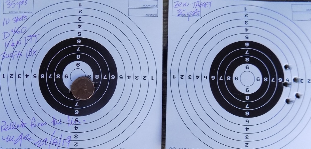

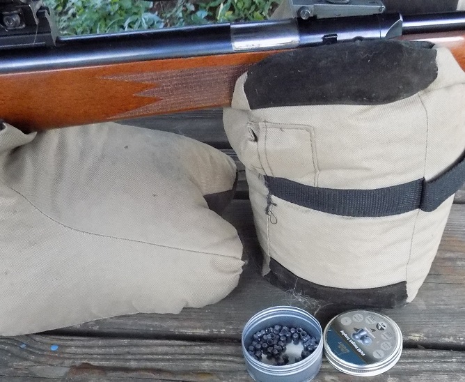

Get one of these.
Shoot these in it:

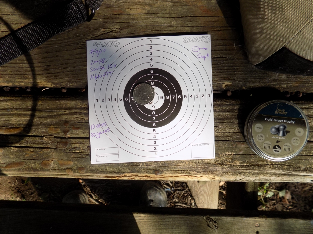

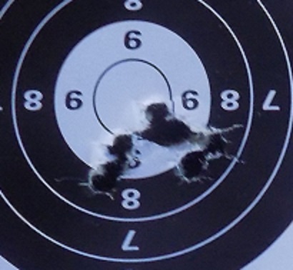

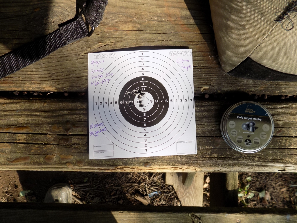

Make ten shot groups like this:
Targets were hung upside down. =)
You are looking at the only two groups I have shot out of that rifle in more than two months.

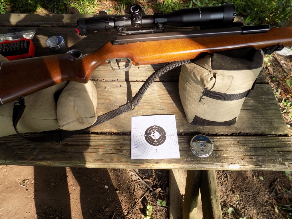

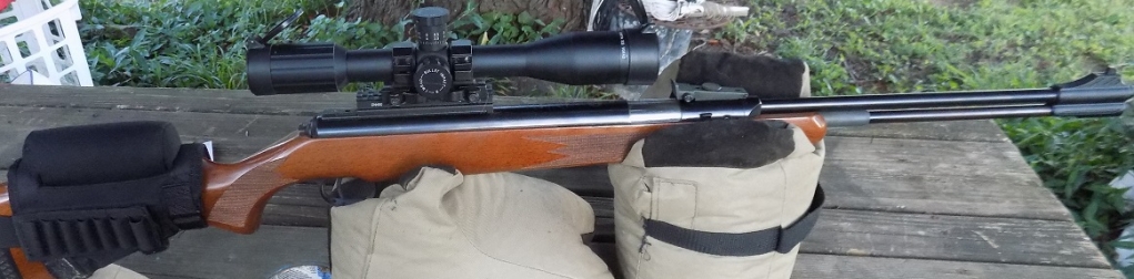

What is it ? Everything on this site is new to me so I’m always wanting to know. What gun, what caliber and what scope. Those are always my basic questions. I’m now kinda looking for an easy operating.177 Springer prefer it to shoot under 1000fps for my 74 yo dad.
That looks like an RWS 460. It is a good gun, but probably near 20 ft lbs of muzzle energy, so not the easiest to cock and shoot. If you want an easy shooting easy handling rifle, get an R7 or HW30. Same rifle different names, cheapest from Krale in the Netherlands, but AOA is pretty close.
It is written on the target. 😁
Sounds like you want a Diana Model 34 or similar in .177 for your Dad. They are about a 14 FPE rifle. The Walther rifles are also supposed to be a good performance/price ratio rifle and I like the look of those but have never owned one. Someone also mentioned the HW/Beeman line. They have a nice trigger and are well made. One of the nicest rifles you can get is the Air Arms TX200, very accurate out of the box and a joy to shoot.
The optic is an SWFA 10x you can get less expensive glass but you wont find anything that is nearly as good a value as the fixed power SWFA optics. Happy shooting.
