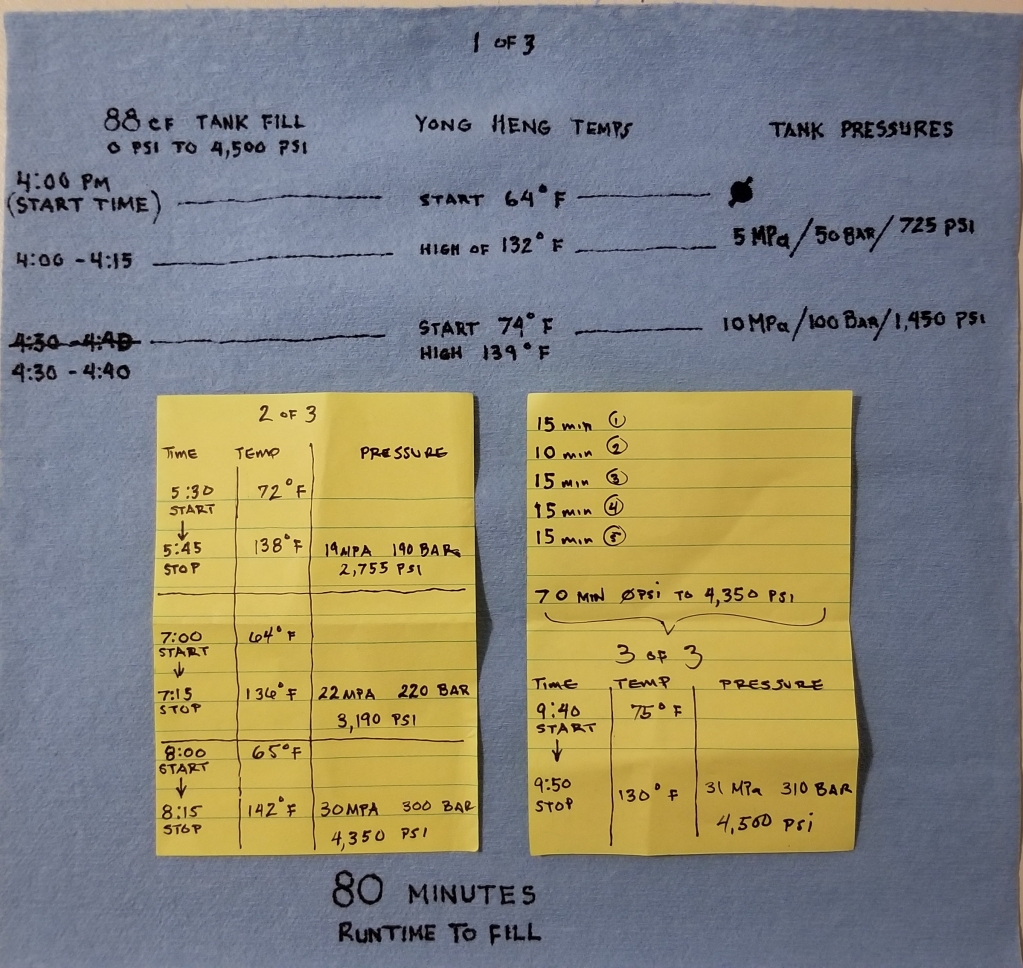

Filled the tank from empty today (about 75 degrees in the shop) using only the Yong Heng with my standard setup- a tool box (holds roughly 2 gallons) filled with ice/water that is regularly replenished and an external ducted fan blowing laterally on the cylinders.
Zero-1000 took 10 minutes, temp at 41C.
1000-2000 took 11 minutes, temp at 41C.
2000-2500 took 6 minutes, temp held at 42C.
2500-3000 took 6 minutes, temp stayed at 42C.
3000-3500 took about 6.5 minutes, temp still 43C.
3500-4000 took 7 minutes, temp 43C.
4000-4400 took just over 7 minutes, temp still 43C.
So just under an hour to completely fill (to indicated 4400 on tank gauge) a large CF tank from empty. Some air certainly lost at a couple of the ventings. When I turned off the external fan the temperature would rise relatively quickly to 60C but turning the fan on would lower it almost as quickly back to the mid/low 40C range. The external fan helps A LOT. Relatively linear fill rate from empty to 4400.
