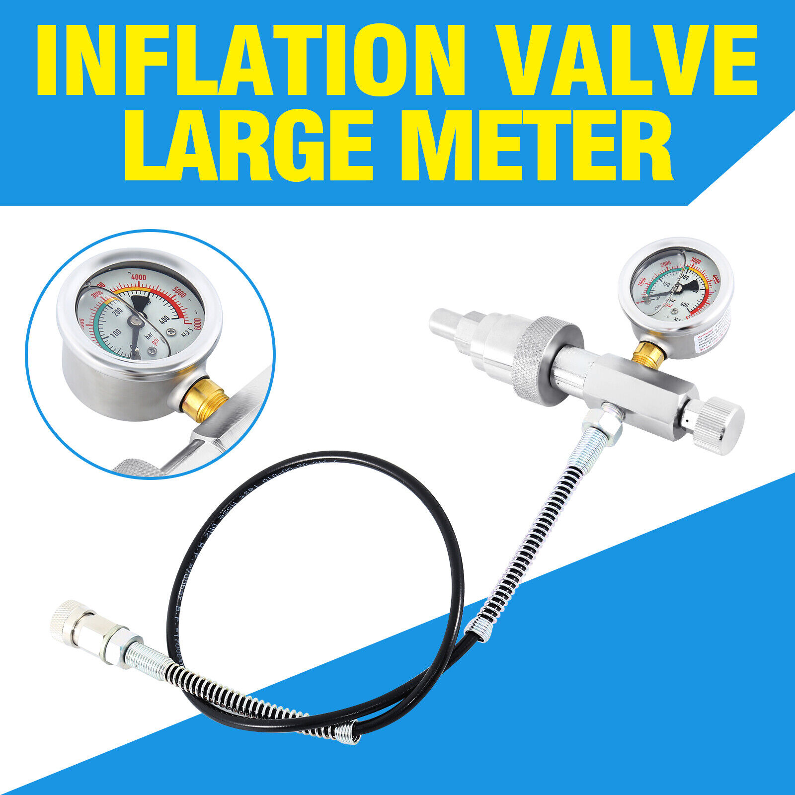

You can often get a fill station that screws directly on the SCBA vavle's CGA374 connector for less than a fill station that replaces the SCBA valve assembly. I have one of these from ebay that cost me $37, that has been working flawlessly for almost a year. I replaced the whip with a male QD connector and added a female QD connector to the other end of the whip to match my existing compressor and gun filling setups and to make it easier to travel with in a backpack. I have a one way female to male QD connector that I attach to the tank when filling it from the compressor, just in case something happens between the tank and the compressor that would cause my newly filled tank to empty itself rapidly, wasting a lot of time. You can also buy an SCBA tank without a valve and get a fill station that screws directly into the tank, but be sure to deduct at least $25 off the price of the tank vs one with a valve.

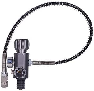

This type of valve / fill station will screw directly onto an empty SCBA tank with no factory valve on it, but they cost $20 to $40 more than the one above. I think most SCBA tanks have 7/8"-14 UNF threads, sometimes referred to as 0.875"-14 UNF but don't take my word for it. Bes sure that it matches the threads on your tank. From what I have read on the forums, the valves in these fill stations are not that robust. The valve on the Scott SCBA tanks is built extremely well. The valve on the Inspiro tanks has a very thin threaded portion where the knob attaches, almost half the thickness of the one on the Scott and is much more prone to bending if knocked over by you or in the past by a fire figher.

I've been using that fill station for around 4 years. I had to seal up a couple of spots with Teflon plumbers tape but haven't had any problem since. Heck I just bought another one for my other tank instead of swapping the one between tanks. By the way, thanks for the link. I've been looking for another one off and on for awhile but they all seemed to have gone up in price from when I bought mine.
