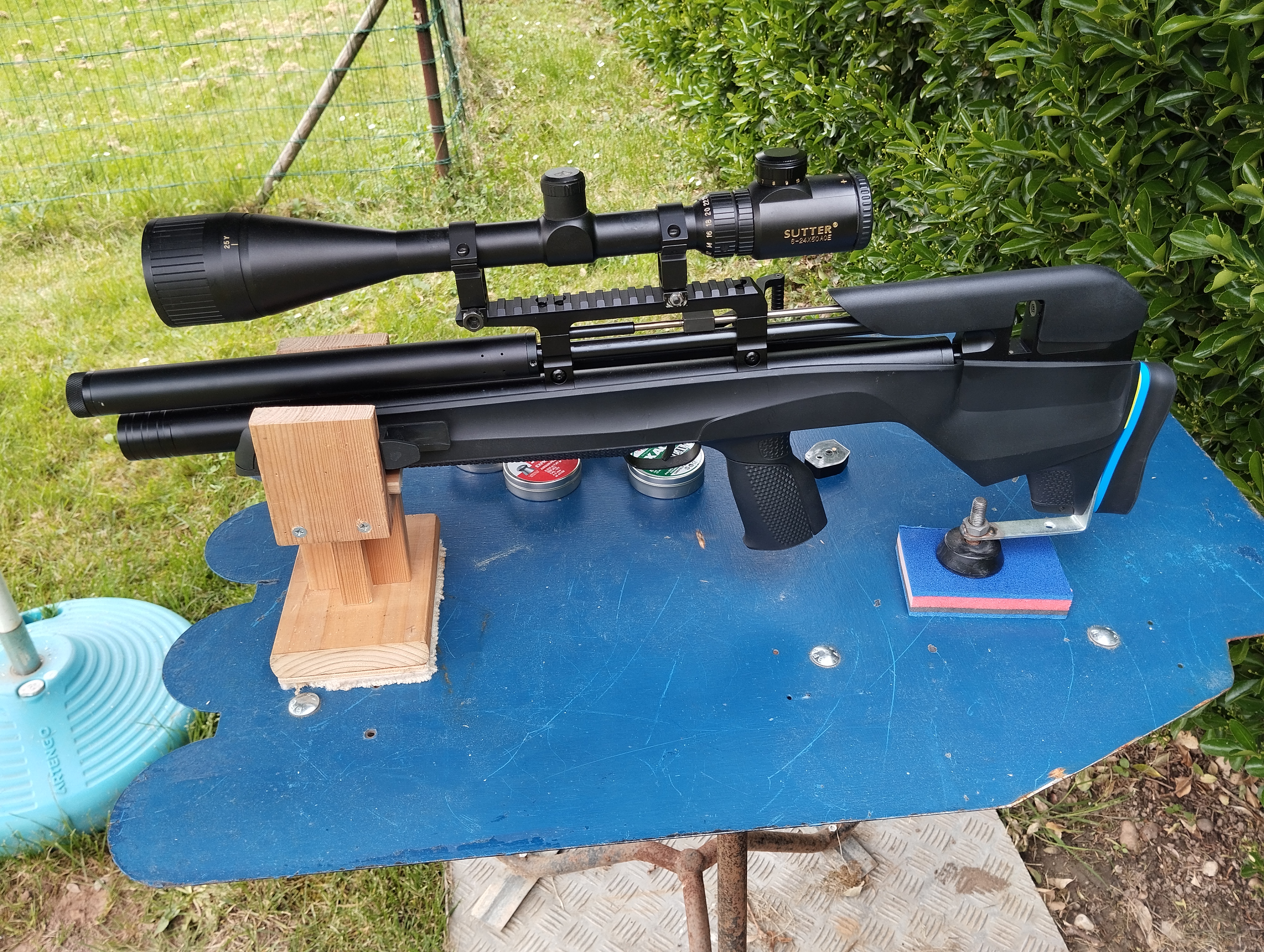

Got my new stoeger xm1 bullshark aka snowpeak p35 the other day. First thing I noticed was this gun is very very inconsistent
Checked the hammer (factory oil was very sticky) cleaned off the factory oil still very inconsistent.
So I decided to take the whole thing apart which is very easy to do just a single bleed screw.
I found the regulator was cover with silicone grease. Cleaned those off the reg and lowered the regulator setting a bit.

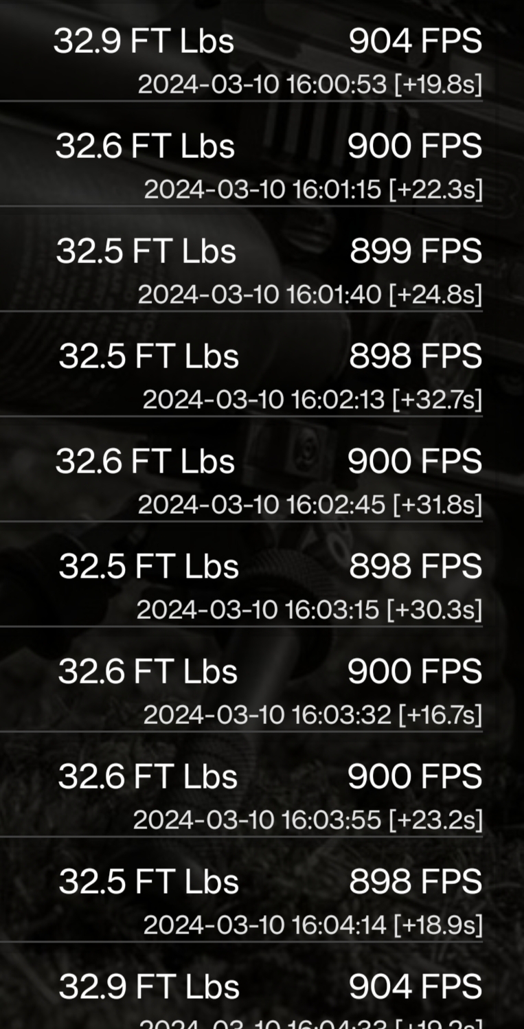

This is what I am getting after. Had to lower the hammer spring as well to hit that 900fps magic number with JSB 18.13gr.

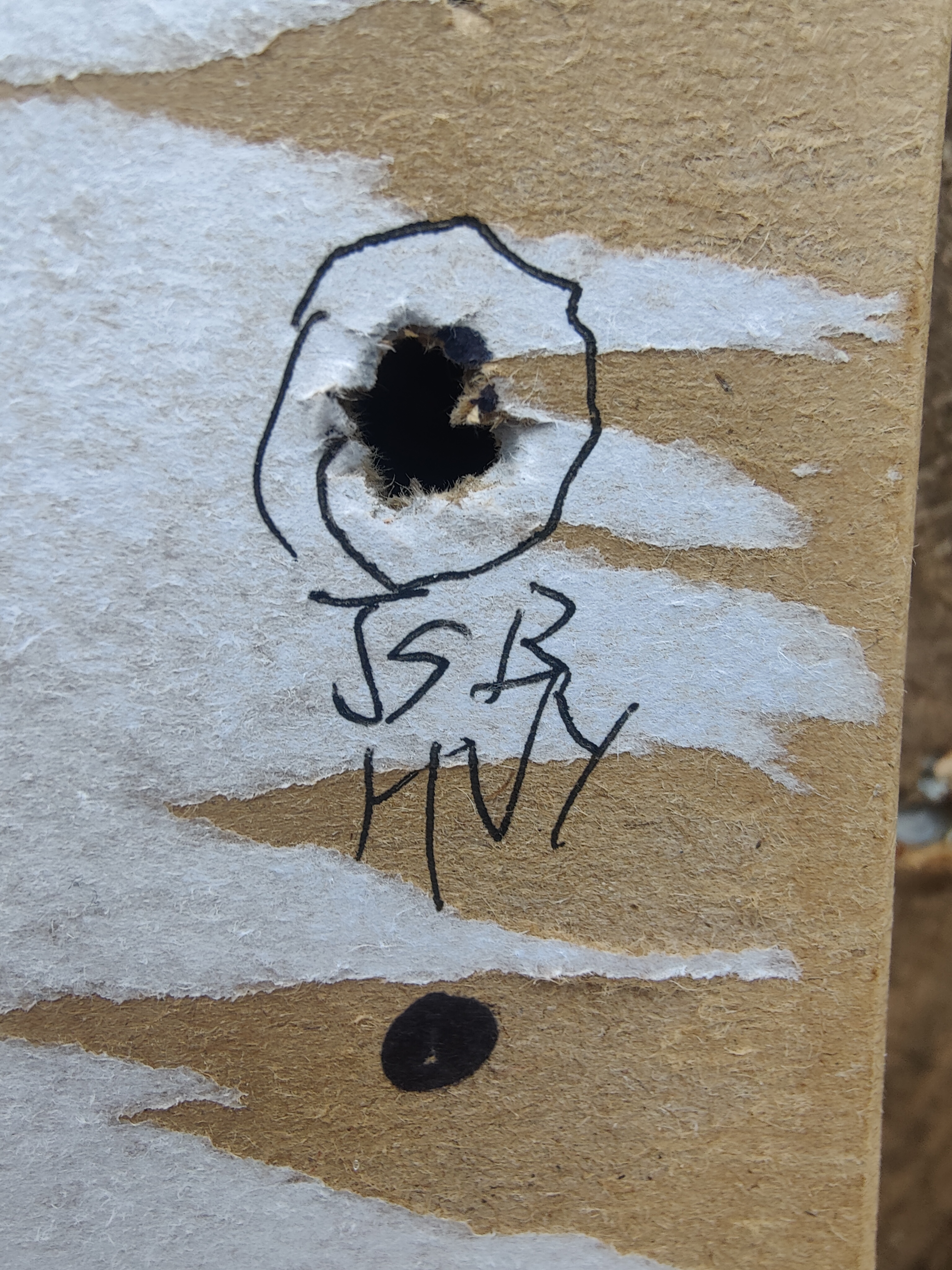

8 shots group at 25 yards

I'm glad you got your inconsistency fixed. My Caiman is inconsistent too and much more expensive. Still working to figure it out. I haven't pulled the Huma regulator yet but that may need to happen. It has a unique (to Air Maks) pivoting hammer design and it seems like friction in the pivot may be playing a role. A light oil (FP10) seemed to help for a few shots so I just put in some moly grease and hopefully it will be longer lasting.
I have 3 P35s and they never had inconsistent velocity like you illustrate. But I find the ES and std deviation are both lower with pellets they shoot accurately. Not sure whether the consistent velocity is helping accuracy or possibly both characteristics are because the pellet and gun are compatible.

PZCP rifles need to be TUNED properly to get shot-to-shot velocitry consistency. Should be within 5 fps of each other. One "tunes" for a specific pellet or slug in one's particular PCP rifle. Look on YouTune for something like".How to tune a PCP air rifle". Or "How to tune XM1 Bullshark"
Interestingly part of the issue I was having with my Caiman turned out to be an excess of silicone grease on the washers in the regulator. It's a Huma. Much more expensive gun with the same issue as the Stoeger.
I like shooting 30 yard challenge targets so I have a lot of shot strings that are 24 shots or so long. My Caiman gave me one with a 12ES and 3 std deviation recently. My P35s are typically more like 18 and 5. So I think once I got it cleaned up the Huma is working well.
