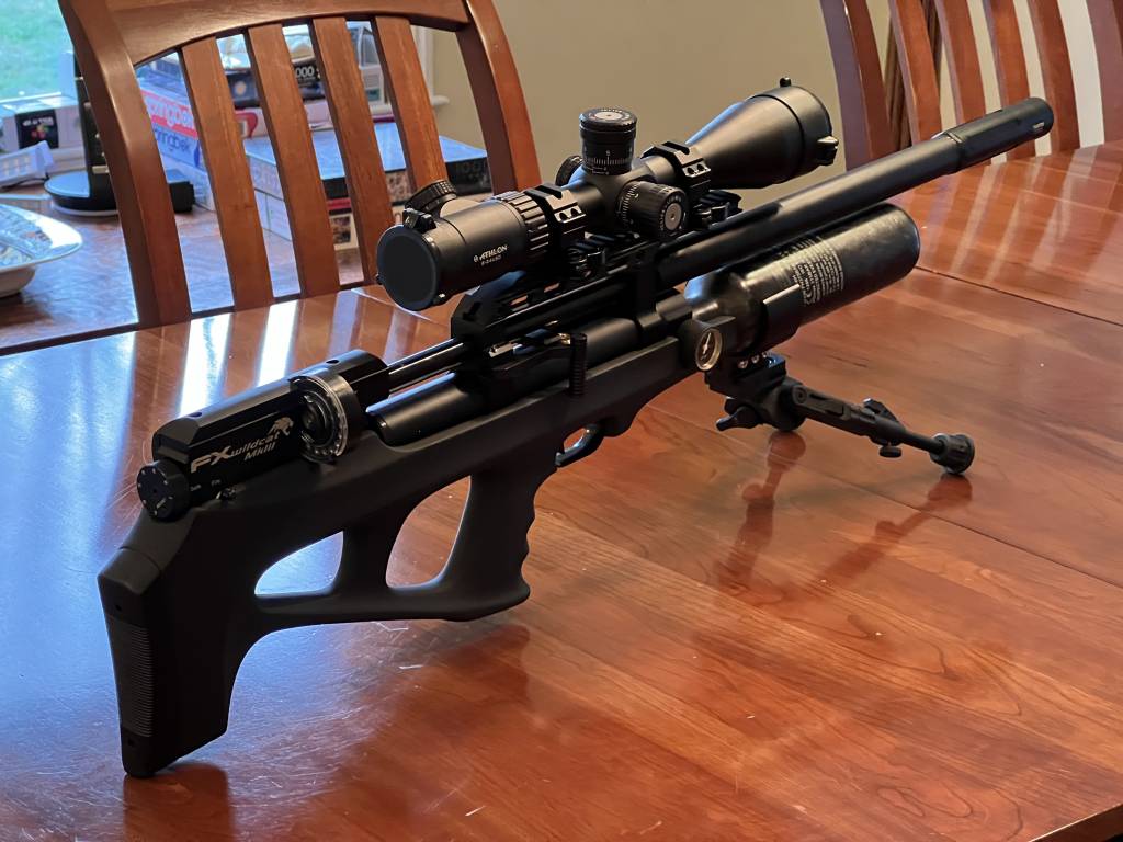

Everything worked perfectly! I mounted a spare Athlon Argus BTR Gen 2 6-24, sighted it in roughly in the basement (15 yards) and practically skipped outside to fire a few quick ones at 50 yards. Out of the box the 2nd reg was set at about 90 bar, and it shot 13 JSB 18.13 gr pellets at an average 934 FPS with the Power Wheel on 7, and accuracy at 50 yards was great, even with a strong wind blowing everything 1.5 inches to the left. It still gave a 1/2” group for 8 shots. I’m very happy so far. Just what I wanted!

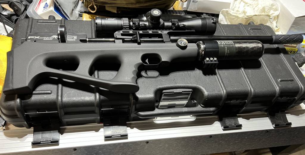

The gun comes in a nice cardboard “box”. Not what i would call a “Case”. The box is shown in the photos below, and you can see the gun lying on the case for one of my Impacts. Quite a difference. By the way, I assume that this is only true for the VP model.

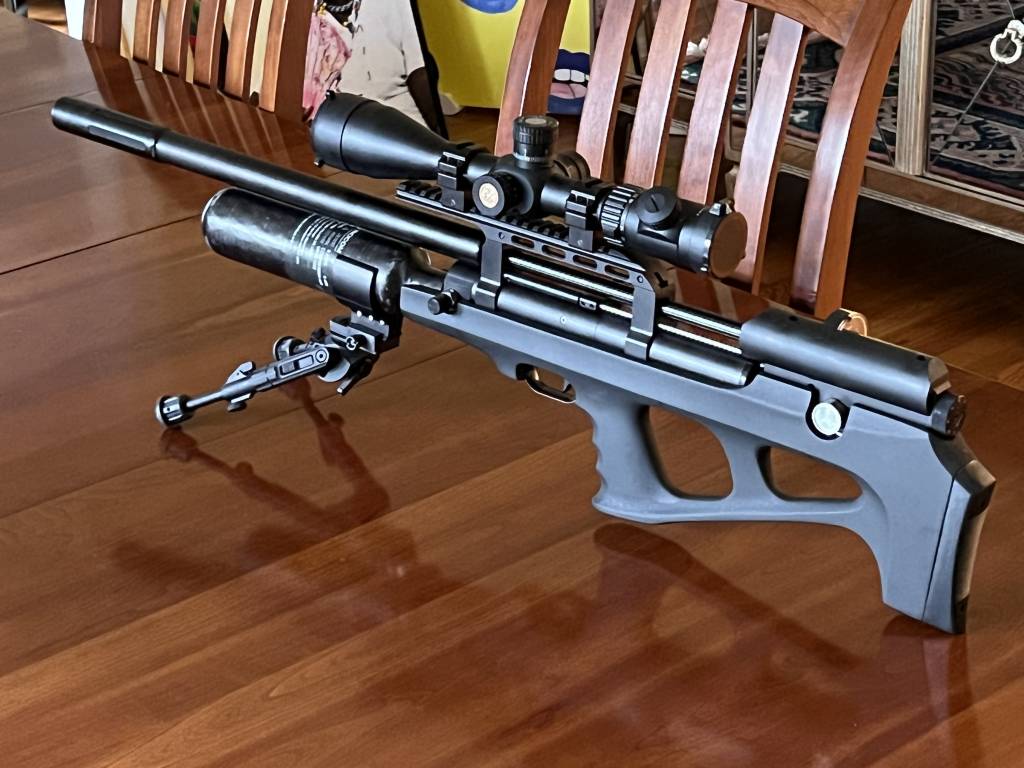

Just realized that I forgot to post the measurements that I promised, so here they are:
The Wildcat MK3 BT VP is 35 1/4” long with its 600mm barrel and the 0dB moderator shown in the last picture. W/O the moderator it is 31” long. From the top of the scope rail to the lowest part of the stock is 8 1/4”. With my Athlon Argus BTR Gen 2 6-24X50 scope mounted using Low UTG quick detach rings it is 11 1/2” tall.
