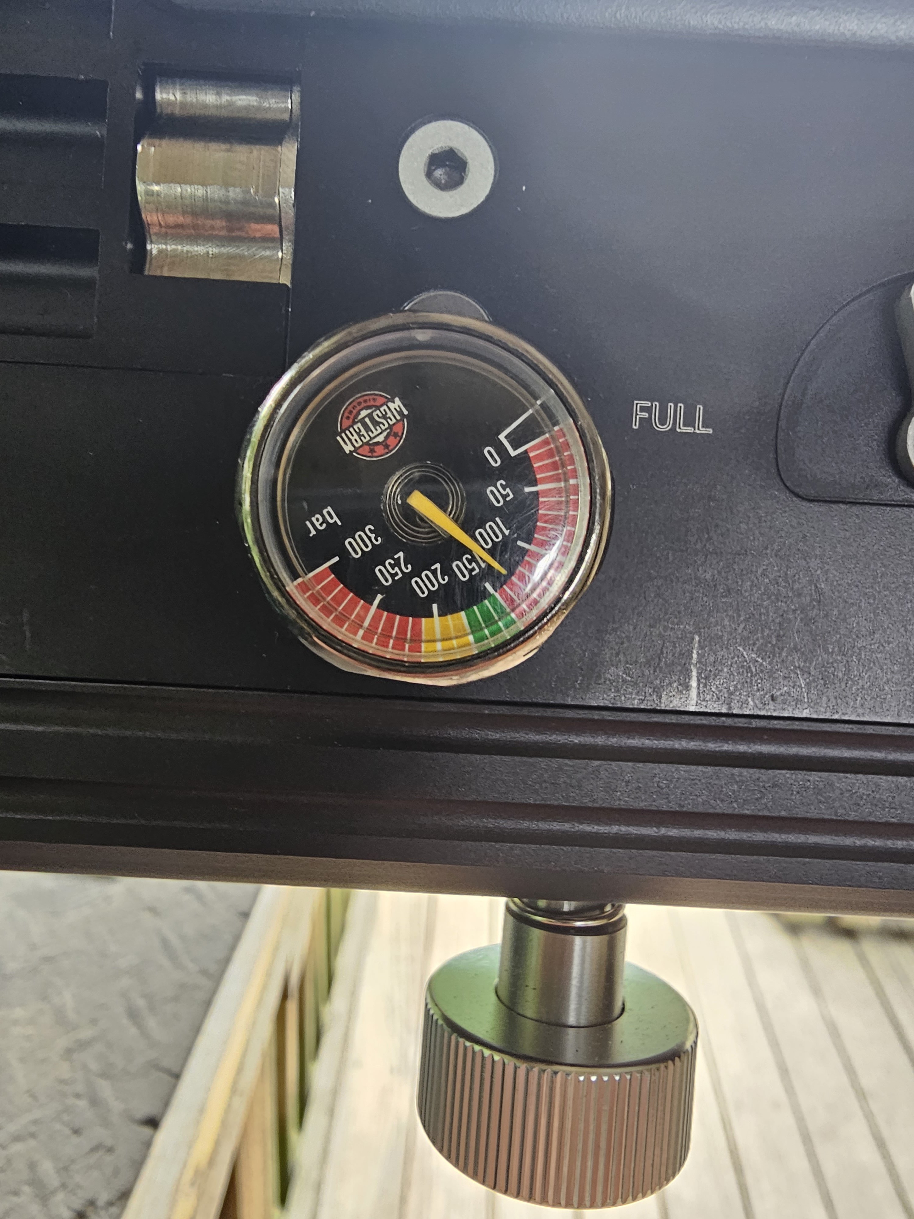

However I'm not clear on where to make the adjustments. I've heard it said that the rear knob is all you need to adjust; then others saying that the front part is where I should be adjusting. If anyone can help clarify this process, and educate me as to the finer points of dialing this gem in, I'd appreciate it. TIA.
So... I decided to bottom out the rear knob. That gave me an 801fps with a 61.5 NSA slug.slugs. and the rear gauge still hasn't even twitched. It's still sitting exactly where it was the day I got it.
Hello.
The rear gauge is the regulator pressure set gauge. It will not move with turning the rear throttle knob. The rear throttle knob changes the volume of air behind the pellet. Not the pressure. The regulator pressure adjustment is in the front of the rifle. The manual can help you with how to adjust.
Rob
Thanks. I think I'm on to something now. I was finally able to get the slug up to 850. What measure of change per click can be expected with adjustments to the rear knob?
