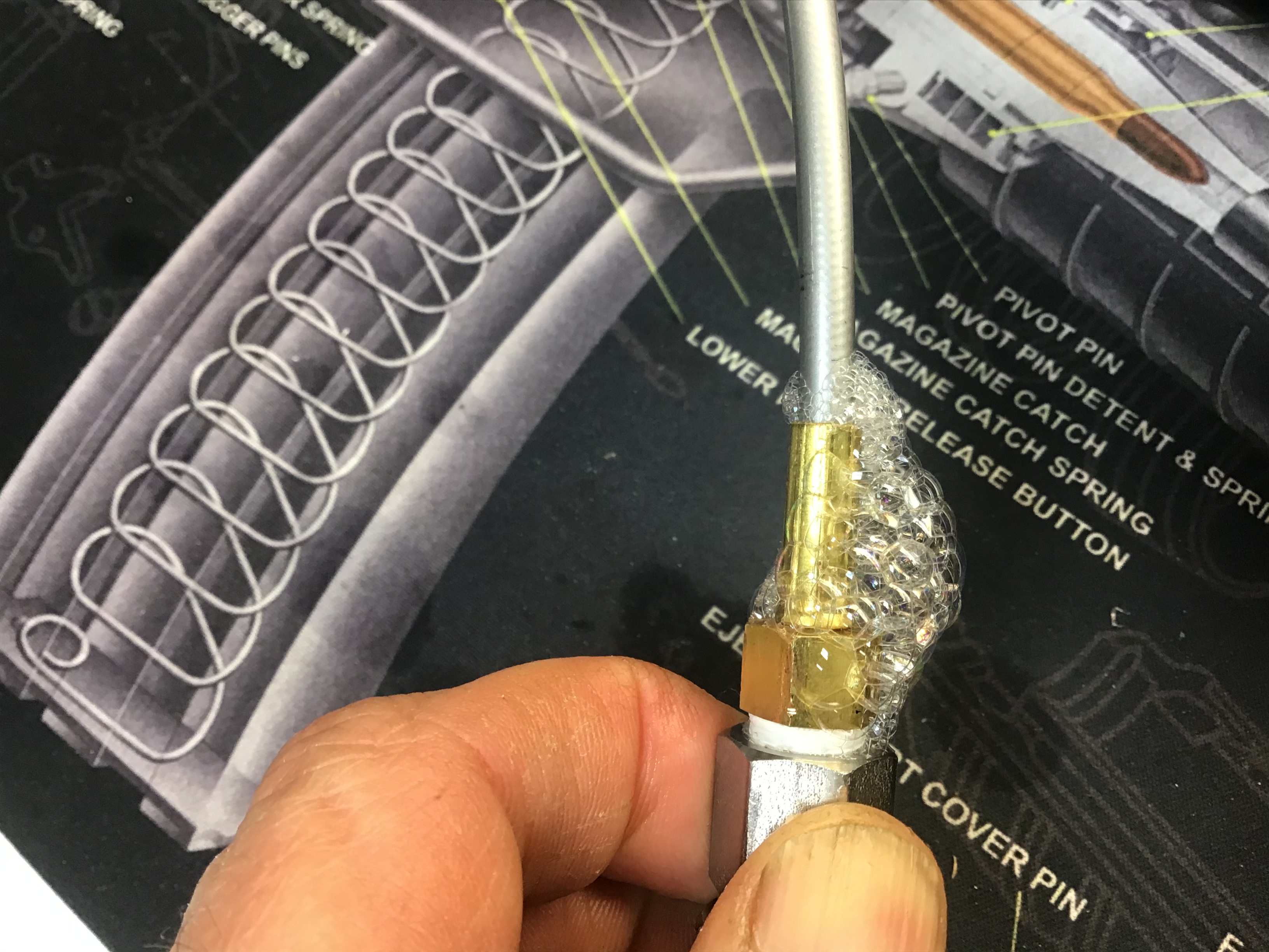

This is a pic of the microbore hose supplied with a 5000 psi hand pump I purchased. This us the 1st attempt. 3 more hoses under warranty and finally have a good one. Being a retired hydraulic engr I can tell you whomever prepared the hose and clamped the ferrule did so improperly. At this point it's junk. You can buy the fittings, but, the dies and crimp machine would be cost prohibitive. These gage hoses are toss away and never fixed. Stauff corp. sold assemblies you may want to contact them to discuss your options.

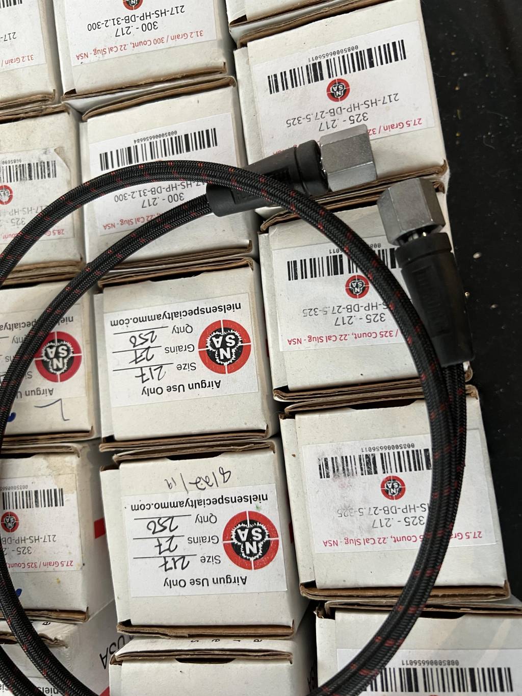

Get the best, and get the hoses from airtanksplus.com. Comes in different lengths to suit your needs.
there’s a reason that the maker of the Thomas target Rifles prefers the tethering reg and hoses from ATP, which he used when he won that 50 yard event just recently.
It’s more than likely the quality of the hoses and how they’re put together
