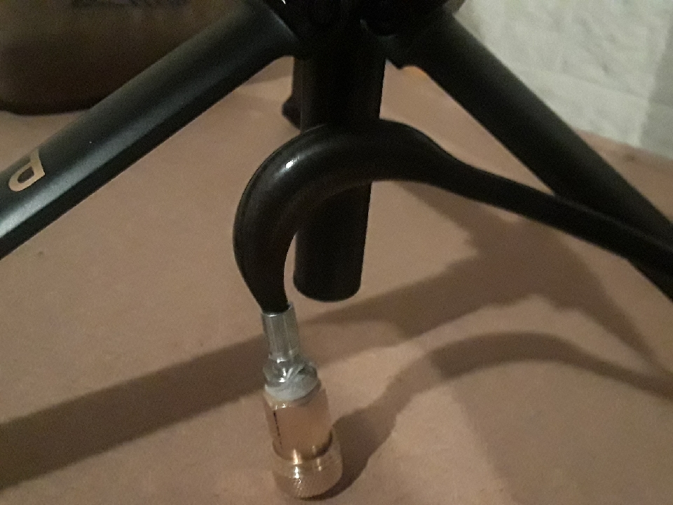

For every crimp connection/hose size, there is a exact set of dies, some metric, some proprietary, that must be used. To try and 're-crimp' a connection would probably do very little to solve your problem. Cutting off the crimped leaking connection and installing a new one is the only way to repair a leaking crimp fitting. More than likely the leak is in the hose itself at the crimp, from hose strain, hose kinking, or hose stretching.

This is a pic of the microbore hose supplied with a 5000 psi hand pump I purchased. This us the 1st attempt. 3 more hoses under warranty and finally have a good one. Being a retired hydraulic engr I can tell you whomever prepared the hose and clamped the ferrule did so improperly. At this point it's junk. You can buy the fittings, but, the dies and crimp machine would be cost prohibitive. These gage hoses are toss away and never fixed. Stauff corp. sold assemblies you may want to contact them to discuss your options.![]()
