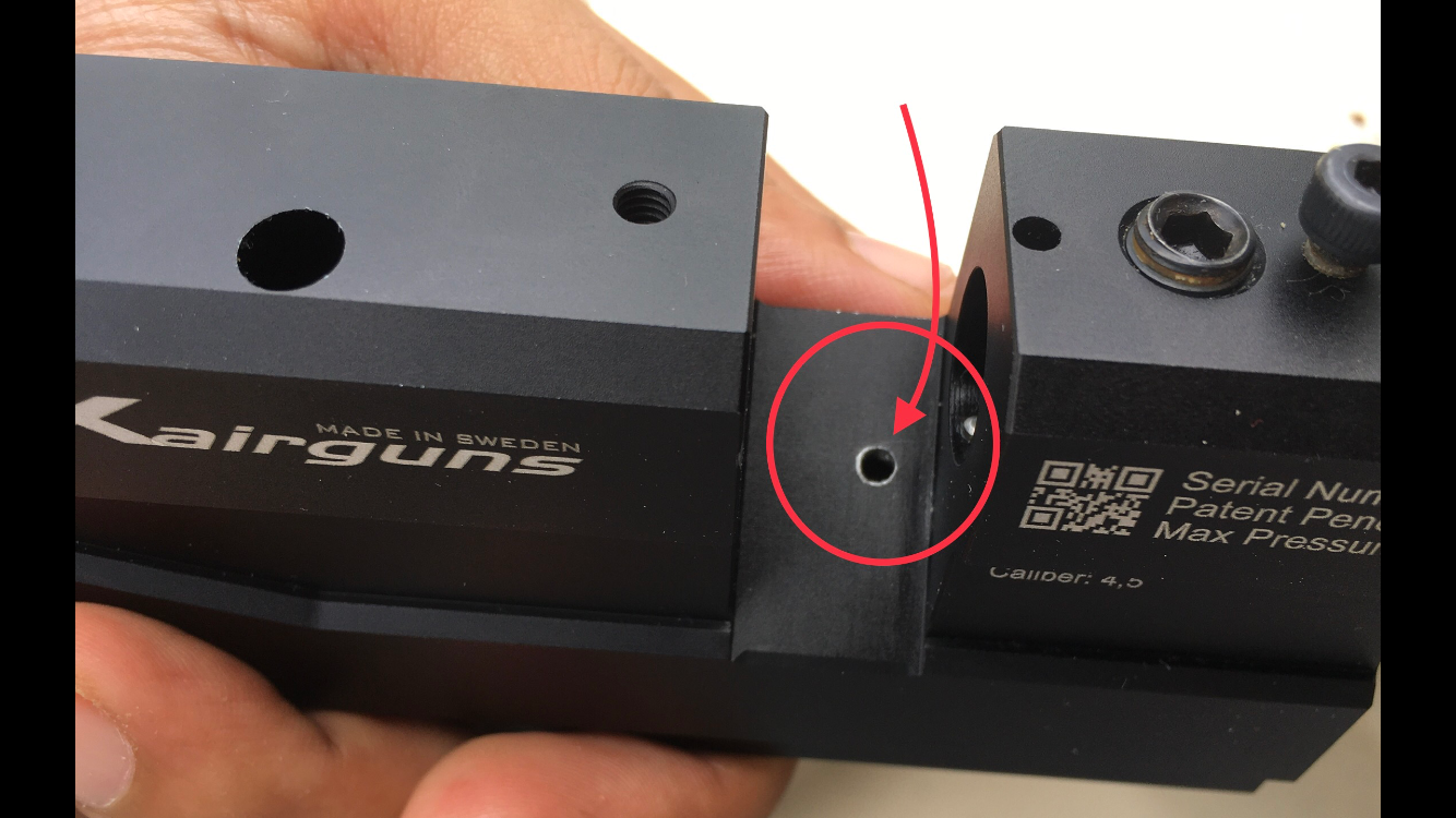

Hi All FX Maverick Owners!
Has any of Your Maverick Gun, esp. the compact in .177/.22 Cal got a Hammer Limiting Screw?
Asking as mine has got one in the screw-hole indicated in picture where it goes…
This is not present in Parts List either.
This essentially is limiting the hammer to how far it can push the Valve Pin and also so it doesn’t hit the Valve Block.
Will help if You can post Block pictures of Your FX Maverick…
Thanks!
-SoulSniper
hey @Tor7 ! You made my day...
You can make out from what overthinking causes, You see...
And there's no mention of it in the user manual either... :eek:
It had actually damaged my hammer, that i had to re-build.
Not only that, the hammer hitting it had made shreds out of the threads of that screw that fell and jammed the cocking mechanism too.
Removed it.
Thanks again for responding on this one, @tor47 ...
-SoulSniper
WOW!!! Never seen a screw there from 5 new FXs I personally bought and many more my friends bought. Guess your dealer never bothered with even testing the gun at all!
