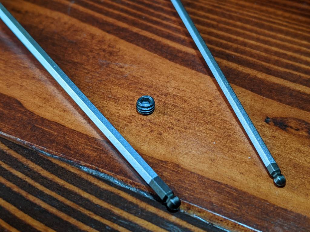

So I was out shooting my stock FX Impact MkII with my nephew this morning. We'd been out for a while and were enjoying the laser accuracy of the gun. Suddenly, as I was cocking the gun, a grub screw fell out of the gun and into the shooting table. I was perplexed, but thought I could just give it a lookover and determine where it came from. Nope! I looked all over that thing and couldn't see any spots that looked like they were missing a grub screw. Since I am a cautious person when warranted, I stopped shooting and came home. When I got back I took the gun mostly apart to search for where it could have come from, to no avail. I didn't take everything apart, but I did strip it down fairly good without getting into the inner workings (surely nothing could just fall out of the inner workings?). I still couldn't find out where the heck it came from. Here is a picture of it next to my 3mm and 2.5mm ball-end hex keys. I measured it with my calipers and it appears to be an M5x4 (4.99mm wide outside thread and 3.64mm long). The 2.5mm key fits in the hex recess.
Does anyone have any idea where this thing came from??
