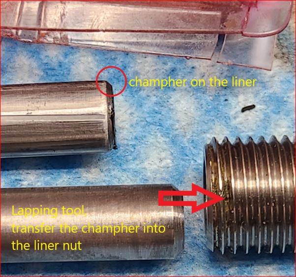

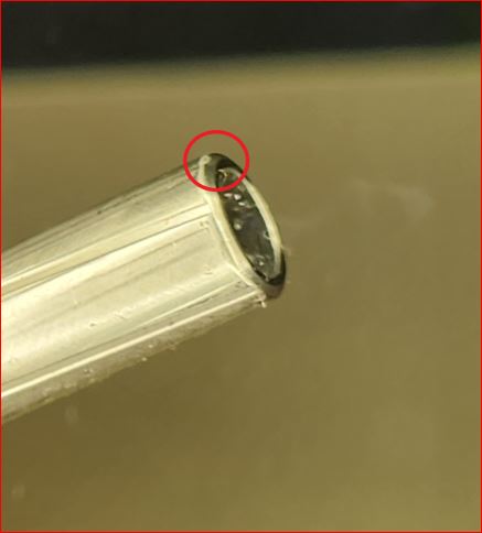

One example, and I don't have any machines I asked a friend machinist, everything done by hand... I made my own tools :
or
Or you can just wrap a teflon tape before installing the liner nut.
