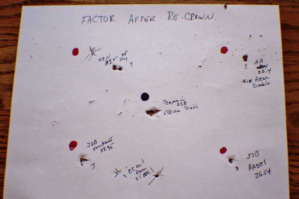

This the the standard Factor not the RC model. When I got it, wouldn't group at 10M. After trying to get some help from Hatsan USA. I gave up on them after 3 weeks.. I figured out how to remove the barrel. Then did a recrown on the barrel. It had a raised burr at every land and groove. Now has an 11 degree target crown that was polished with 1000 grit wet/dry paper after crowning. Shoots everything that I had great now. At 10M most are in one hole. I will send the before and after target with the gun. Comes with all the stuff from factory. Will try to get some pictures up. Not sure how to do that right now. I am asking $900 firm.You pay shipping.I would like Zelle if possible. I can do Paypal FF or you pay the fees. Can also send a Postal MO. This is a shooter now. Just not happy with Hatsan.
