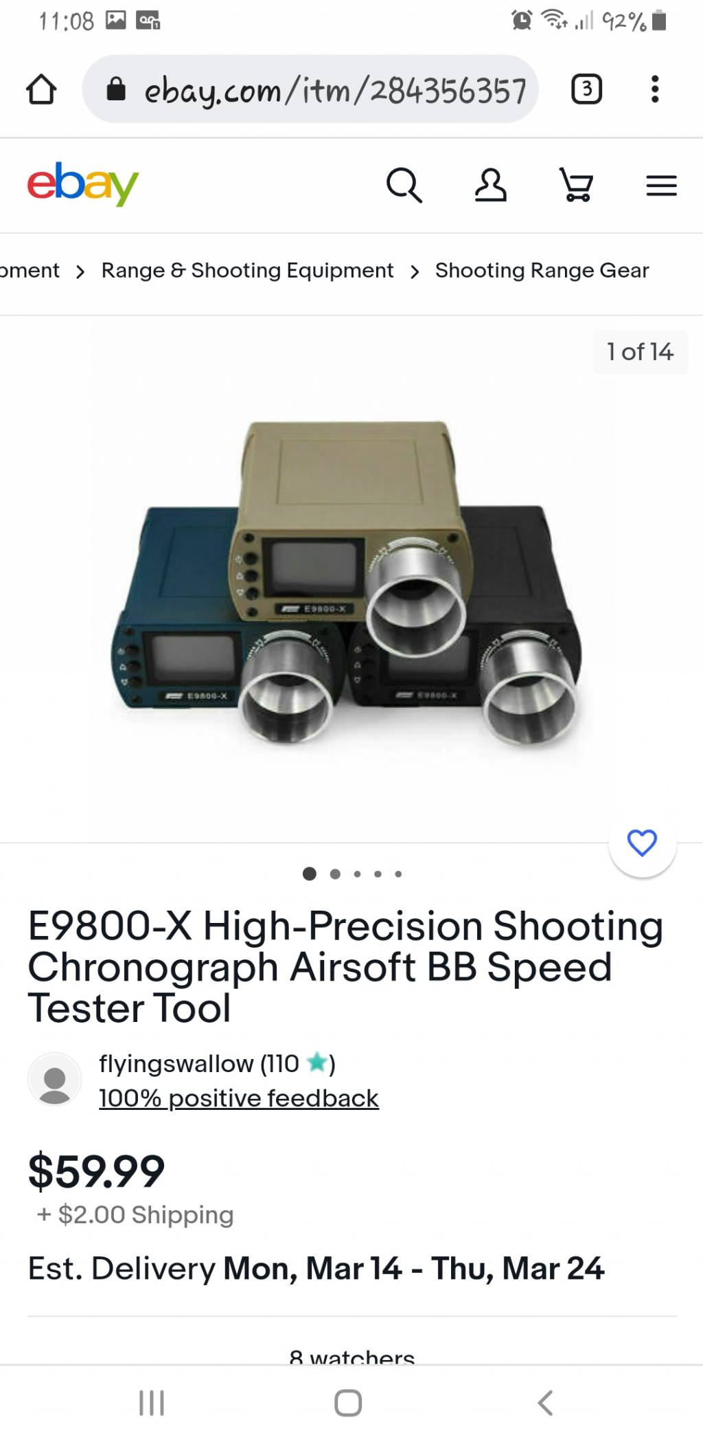

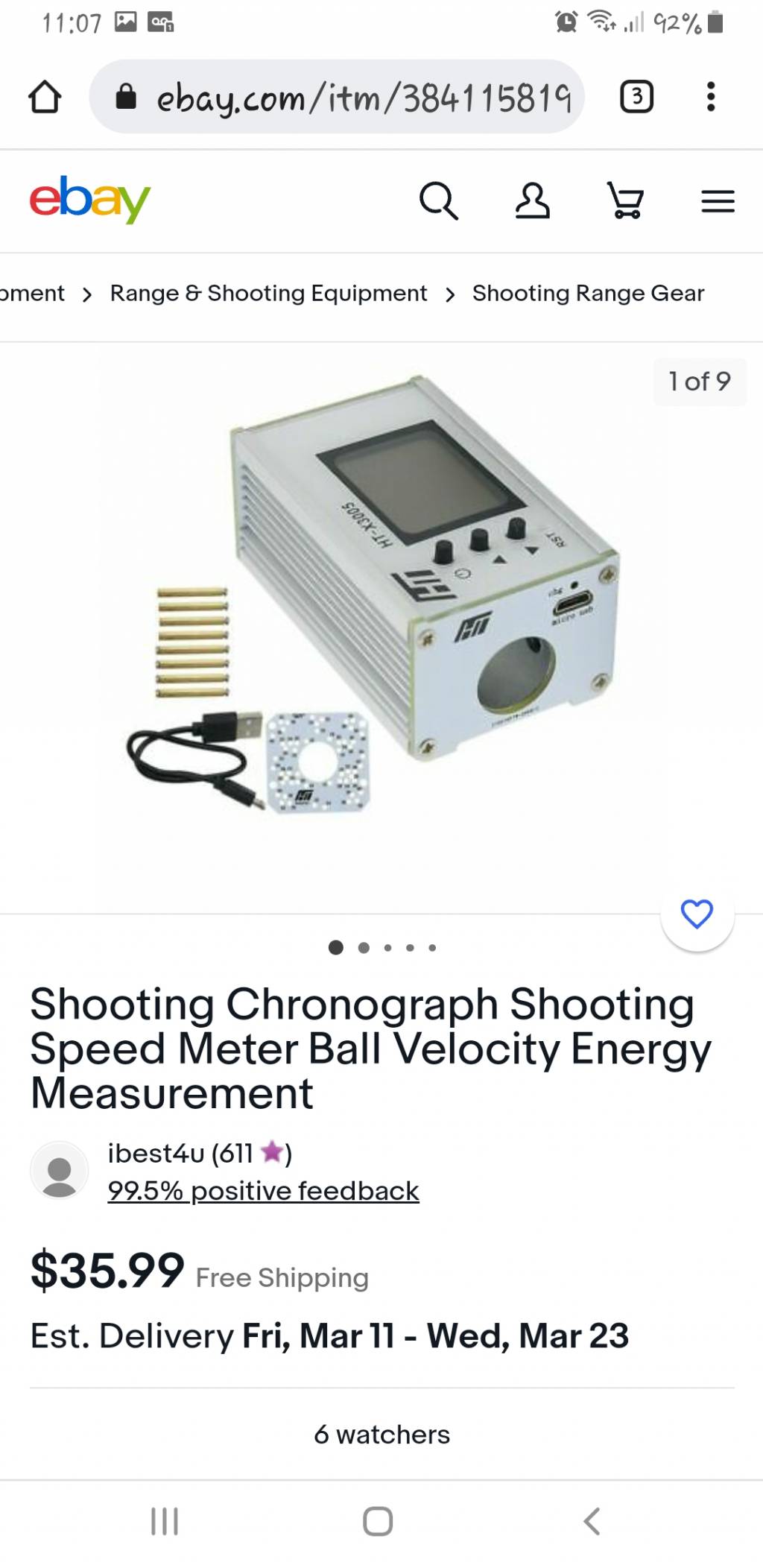

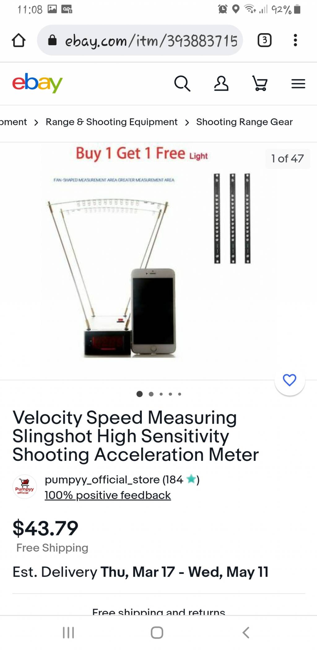

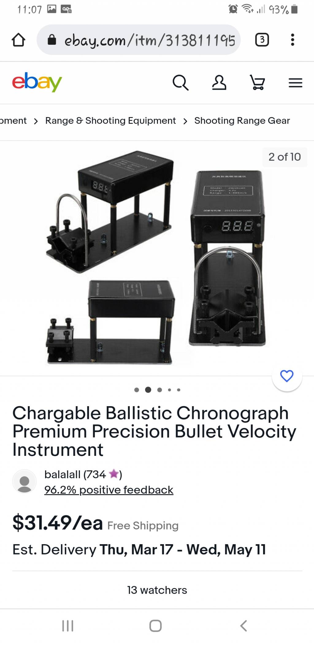

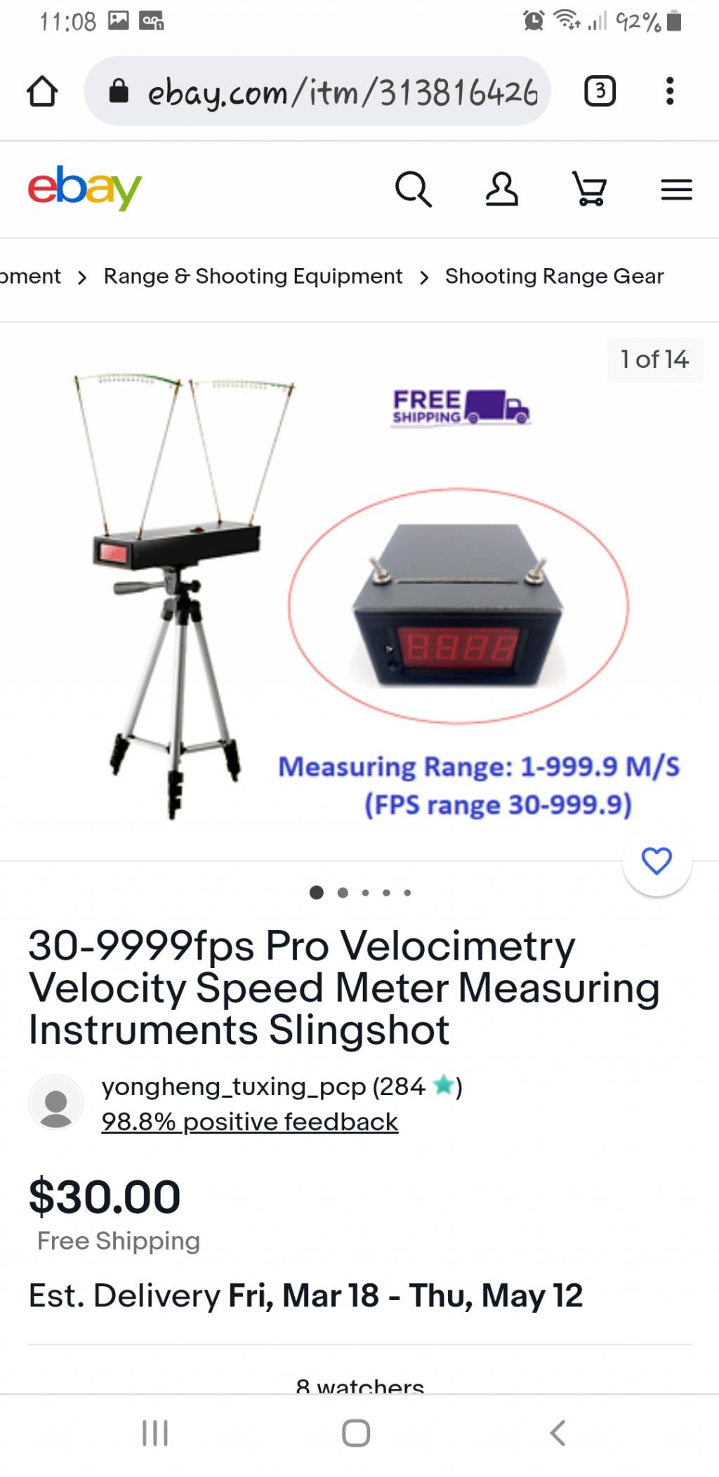

There are many chrony that will read your pellet/slug for way cheaper than fx chrony. Just look them up.
That is quite a list of chronographs. Which do you recommend and what features do you prefer/require.

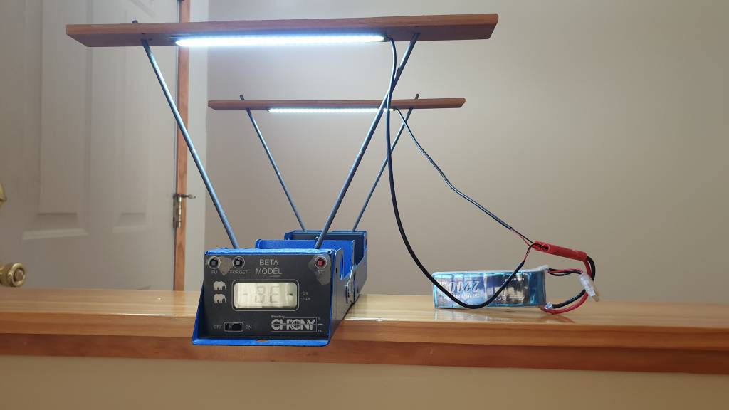

The chrony i use is the beta chrony, blue version. It will read fps, give your shot string, ES, SD. Thats basically all I need. It does require a light source when shooting indoors so I built my own from a led light strip and hook up to a lipo battery. It never give me an error cause the light led above. If you just use ceiling light in the house, most of the time you get error reading. Thats why I build my own light source. If shooting outside it does not require light.
