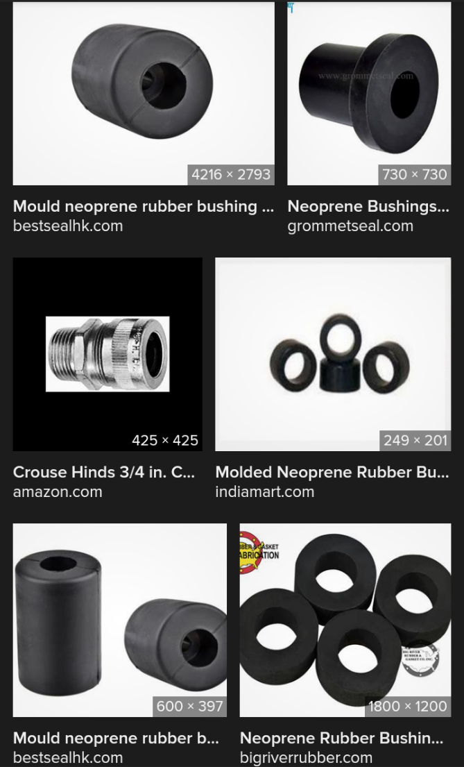

Maybe measure things up and find good bushings ..
Nylon, Teflon, neoprene, somthing real life ?
Thing is why dont the dealer / seller / distributor have them ready as replacement parts ?
