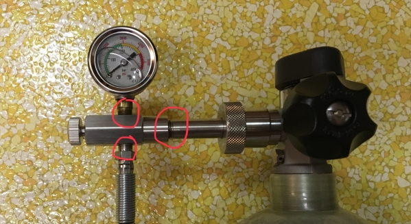

I just purchased a 45 minute SCBA tank on eBay and my set up cost $261.88 then add another $34.22 for the moisture trap and I was just shy of $300. The scba on that listing is a 2008 ,but it is brand new and I was going to fill at home anyways on my HP compressor. The fill station is actually very well made and I took it all apart and inspected the internals, machine work, and threads. if you do happen to disassemble make sure to reapply thread sealant and I prefer using Loctite 545.
1548829707_19109170945c51440b7a55e4.39229912_D89D20FB-F81C-4908-8D64-3BAEC068FE60.jpeg
CG86, it is counter productive to put Locktite or any type of thread sealant on an SCBA tank. The tank air seals on its O-ring. A tank with pressure inside can't loosen so Locktite just makes the valve much harder to remove for inspection. A tank without sealant is difficult to loosen. Silcone grease should be used to make it easier to loosen Even if you own your own compressor it is important to visually inspect the inside of the tank every few years for any signs of moisture damage. Locktite makes valve removal nearly impossible.
I apologize and should of been more clear on where the thread sealant (Loctite 545) was applied. Sealant was only applied at these areas circled in red which is 1/8" and 1/4" NPT pipe fittings which will require a thread sealant(TFE Paste, Teflon Tape, Loctite 545) to properly seal and any fitting that has a o-ring, only 100% silicone grease is applied. At work when assembling pneumatic fittings, I tend to grab Loctite 545 often for fittings 3/8" NPT and smaller because it is easier to apply and cleaner than using a TFE paste or teflon tape. The fill station came assembled with thread sealant out of the package and I am not implying that it is necessary to take it apart when it is received. I am just the kind of person that needs to take things apart to inspect and re-assemble using my own products that I trust in.
