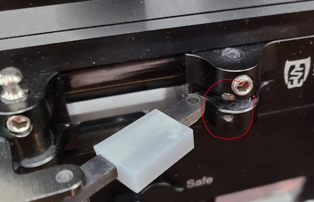

I had a post several months back about that ST cocking block issue, I complained here at AGN, complained to Saber and complained to my dealer, nobody bothered for a first while, but I got really stubborn ;)
Actually it is a triple issue with the ST cocking block, you have learned the first two only. Let me help you out with a next issue.
When you close the cocking lever it will touch to block "ear" exactly the edges between the upper and lower. And me as well hit the trigger with an open cocking lever couple times and it will leave a nasty footprint there.
Isn't this ugly enough to change that design? I even tried to put a dampener on that arm:
I kept complaining and finally my local dealer sent me a new set, and guess what? same thing, the rear block is 3mm dowel screw the front block is 2.5 mm dowel screw = Saber Tactical never bothered to fix the design flaw within this one year I had it on my Impact. So I re drilled the hole from 2.5 to 3 mm and reused a new 3mm screw. this tightened the play in the lever arm, also installed one more rubber ball in the front block (A10.1) and 3d printed a shock dampener similar to this in the picture.
