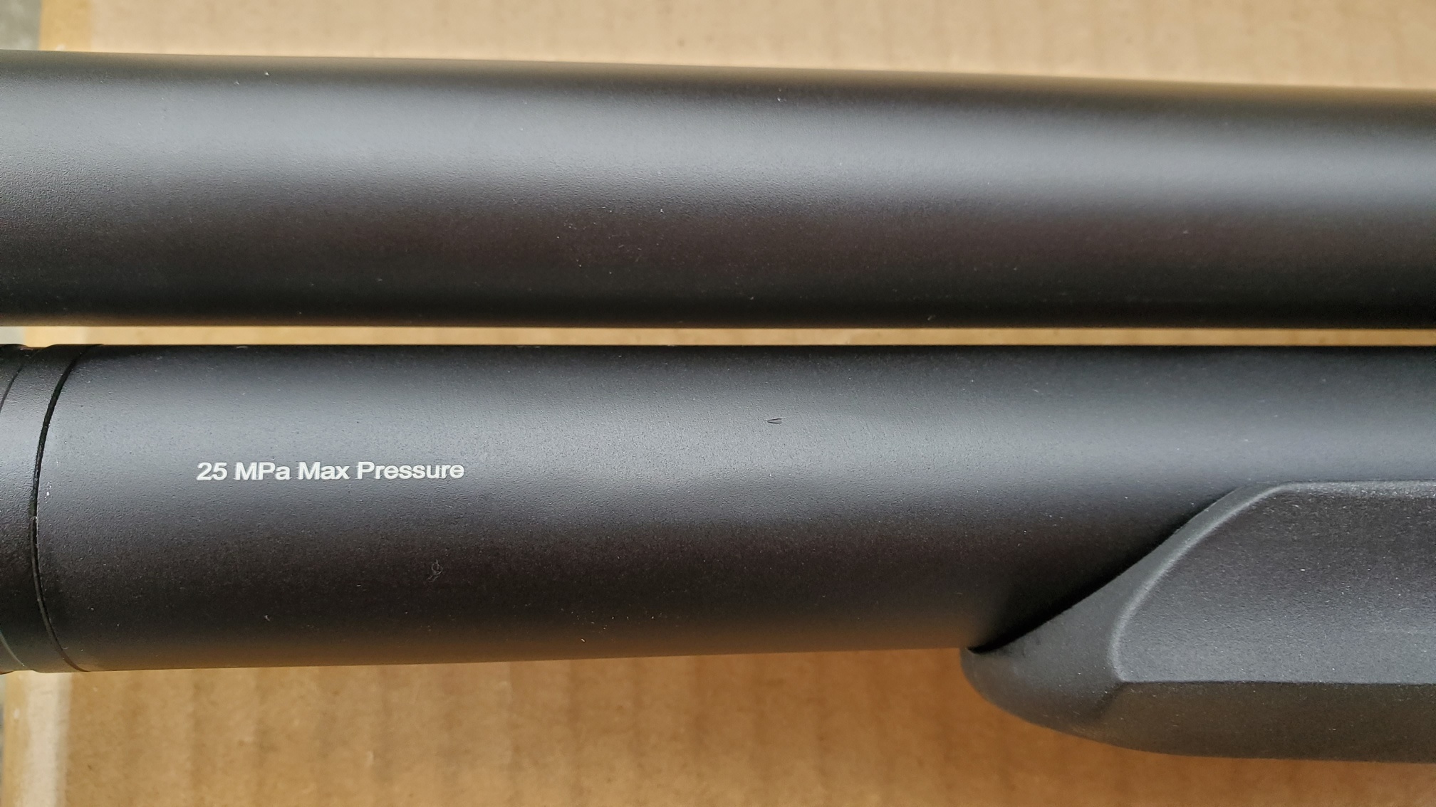

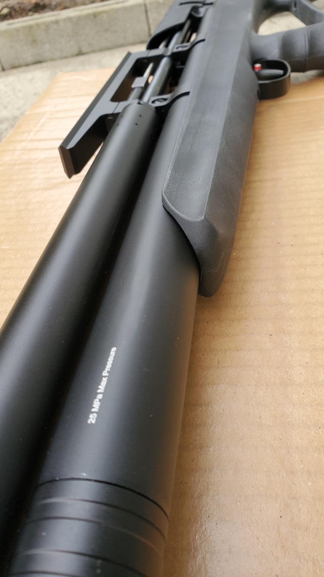

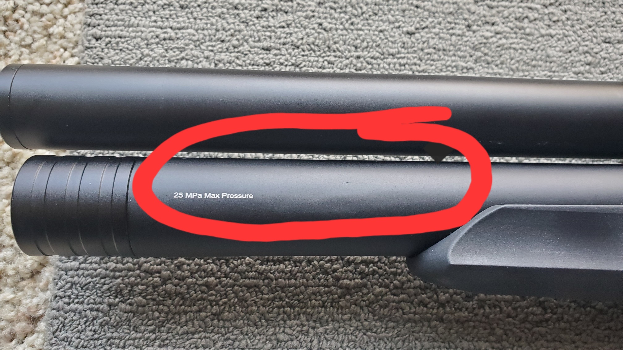

I have problems with a recently delivered P35 in .22cal from Krale. There are two main issues I have with this rifle. #1 is the air cylinder. I believe the tube was damaged somewhere along the production process and it was welded, grounded/blended and paint/anodize before putting it together. There's a pinhole undercut where the repair was done. I'm concern about long term usage.

Yeah I don’t like the looks of that tube. To the regulator, I do not own one but my understanding is yes it is regulated, I would find it hard to believe my SPA/Artemis PP750 has a reg but P35 doesn’t.

It doesn't leak and has held air since I filled it up, but that pinhole is bothersome. Who knows what it looks like on the inside. If it fails, that's probably where it'll be.

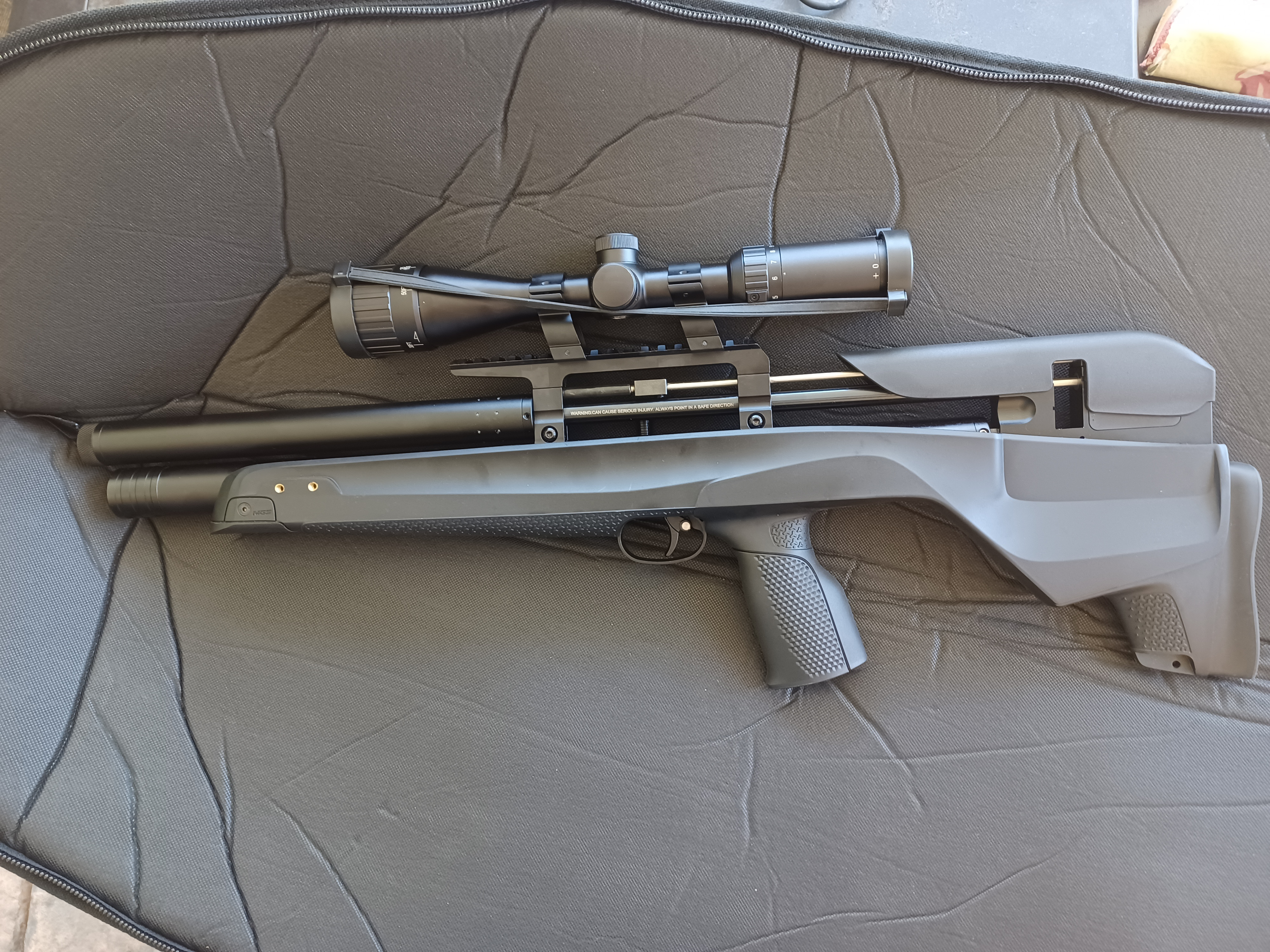

I'm sure happy with my Bullshark. I've been busy making it my own, but I hope to have some pictures soon.
The only thing I didn't like about my Bullshark were the colored pieces. Some Krylon paint took care of that.
I made mine all black too. I took the spacers out and cut the tabs off with flush cut nippers and moved the scope forward about an inch. Problem solved and it looks much better.
