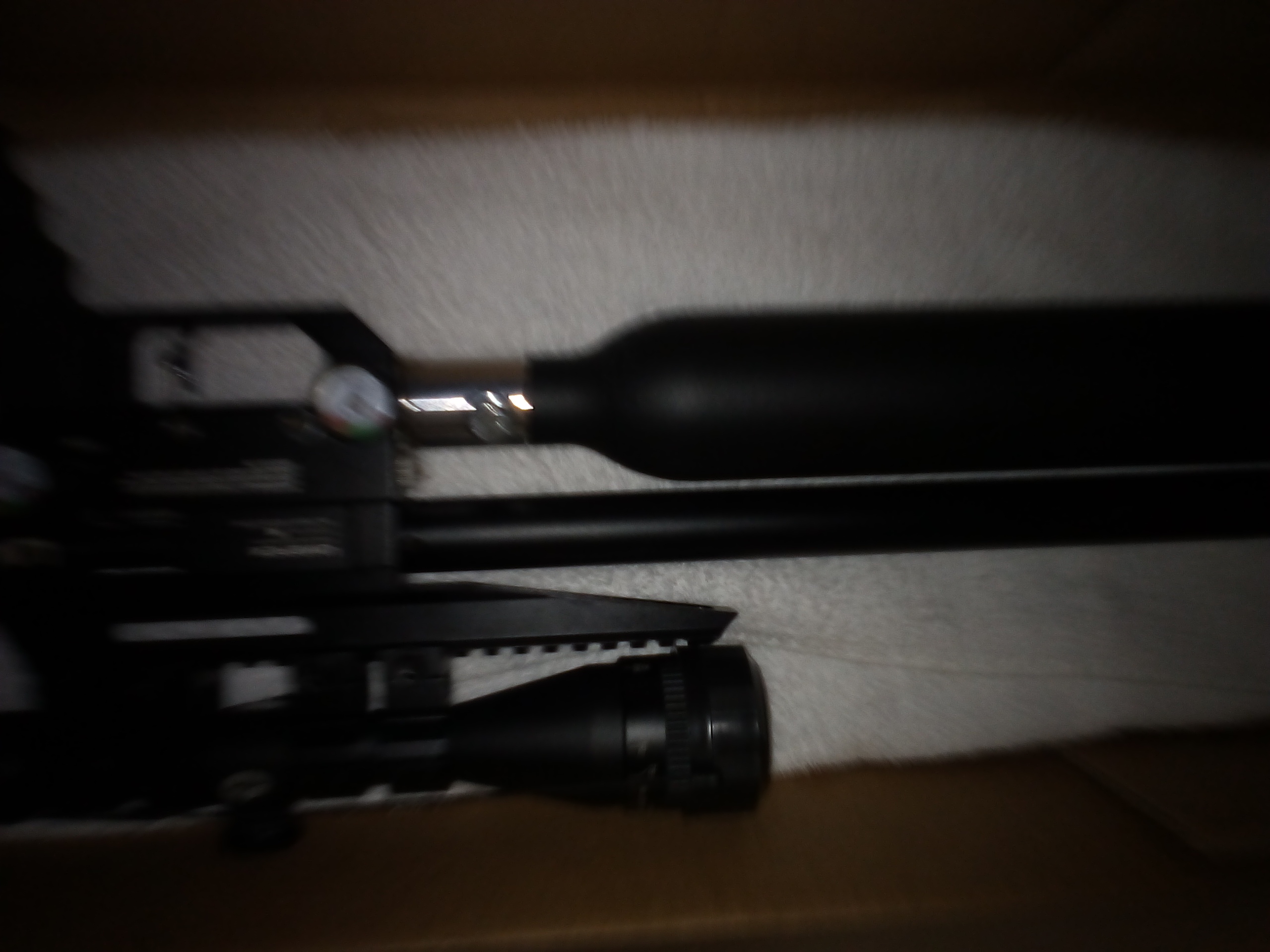

Where did you get the adapter on eBay? I can’t find anything. Thanks!Just wanted to express my love for my .22 caliber Zelos as well this was my first PCP with an adjustable regulator.
I wanted to shoot the 28 grain hollow point slugs I already had ,band when I seen Nates video that said you could turn it up to 3000 I set the reg at 2,700.
I don't have a Chronograph yet , but I was shooting slugs in the same hole.

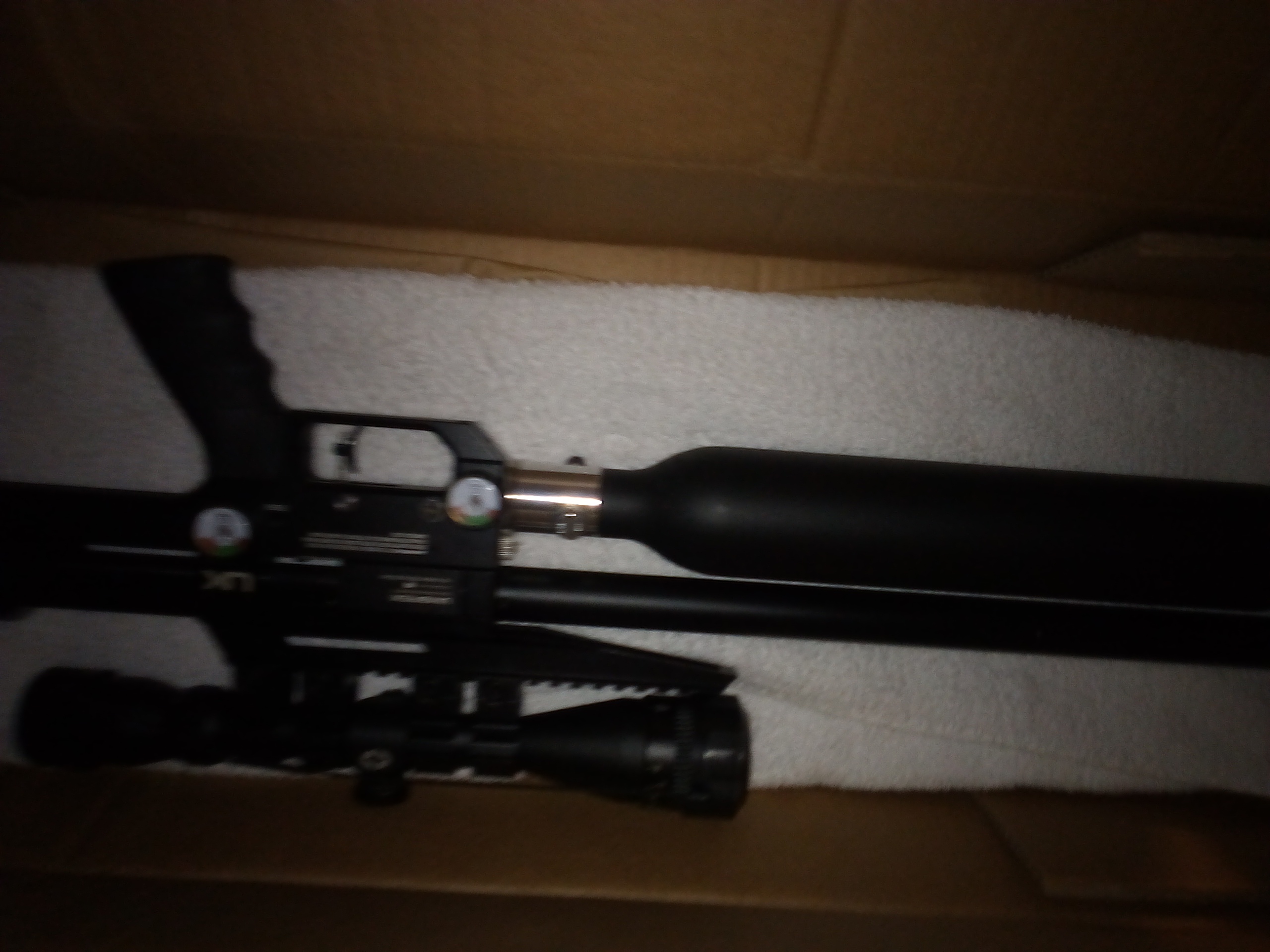

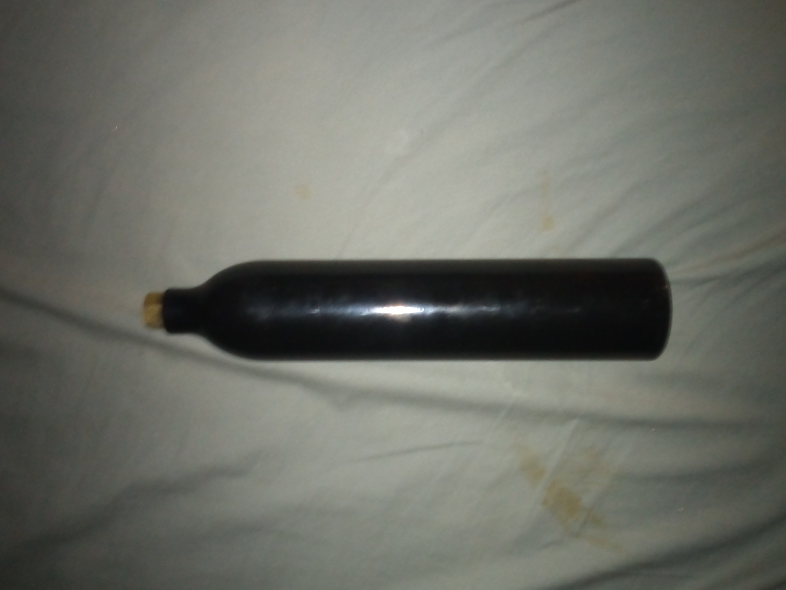

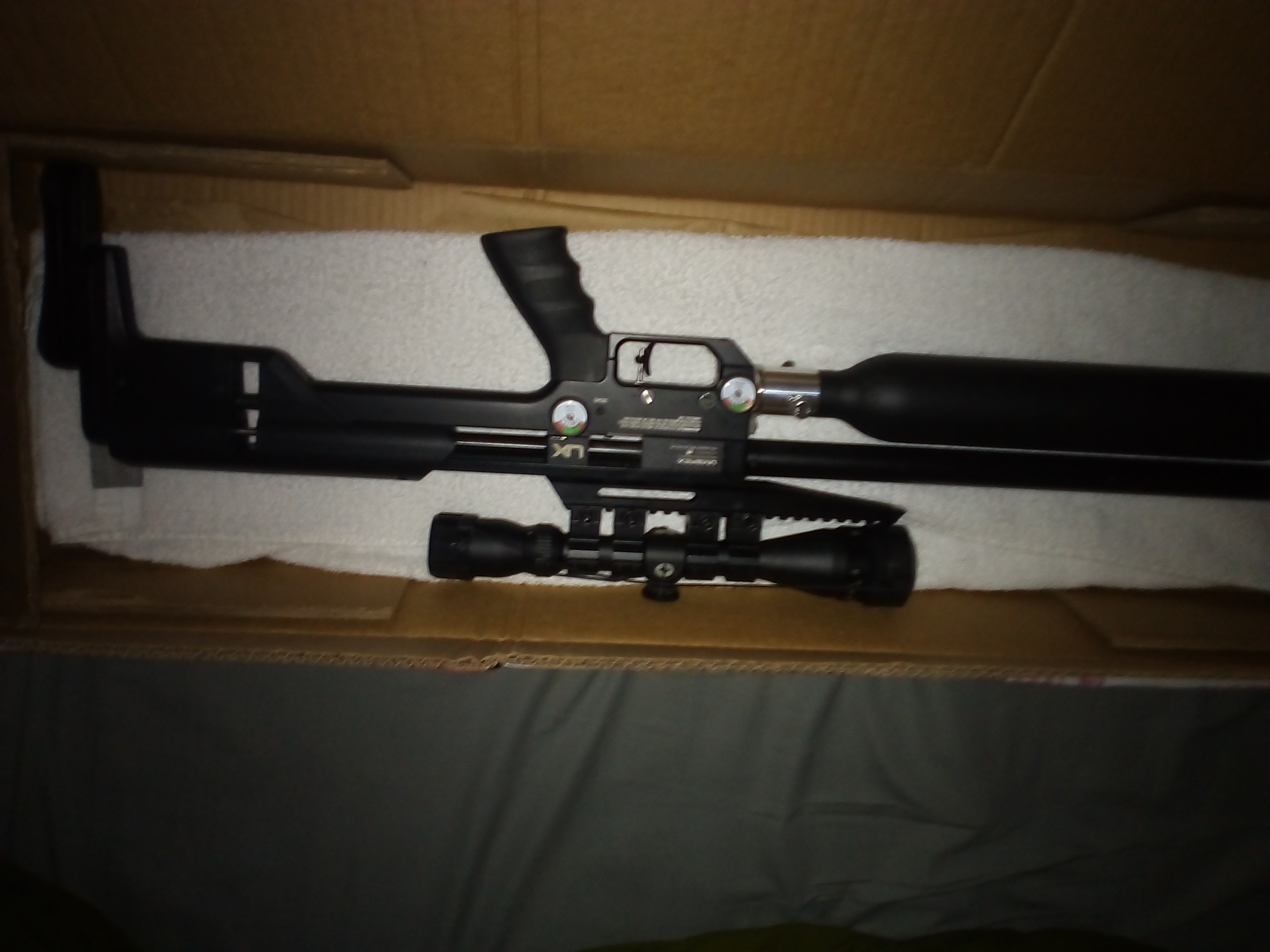

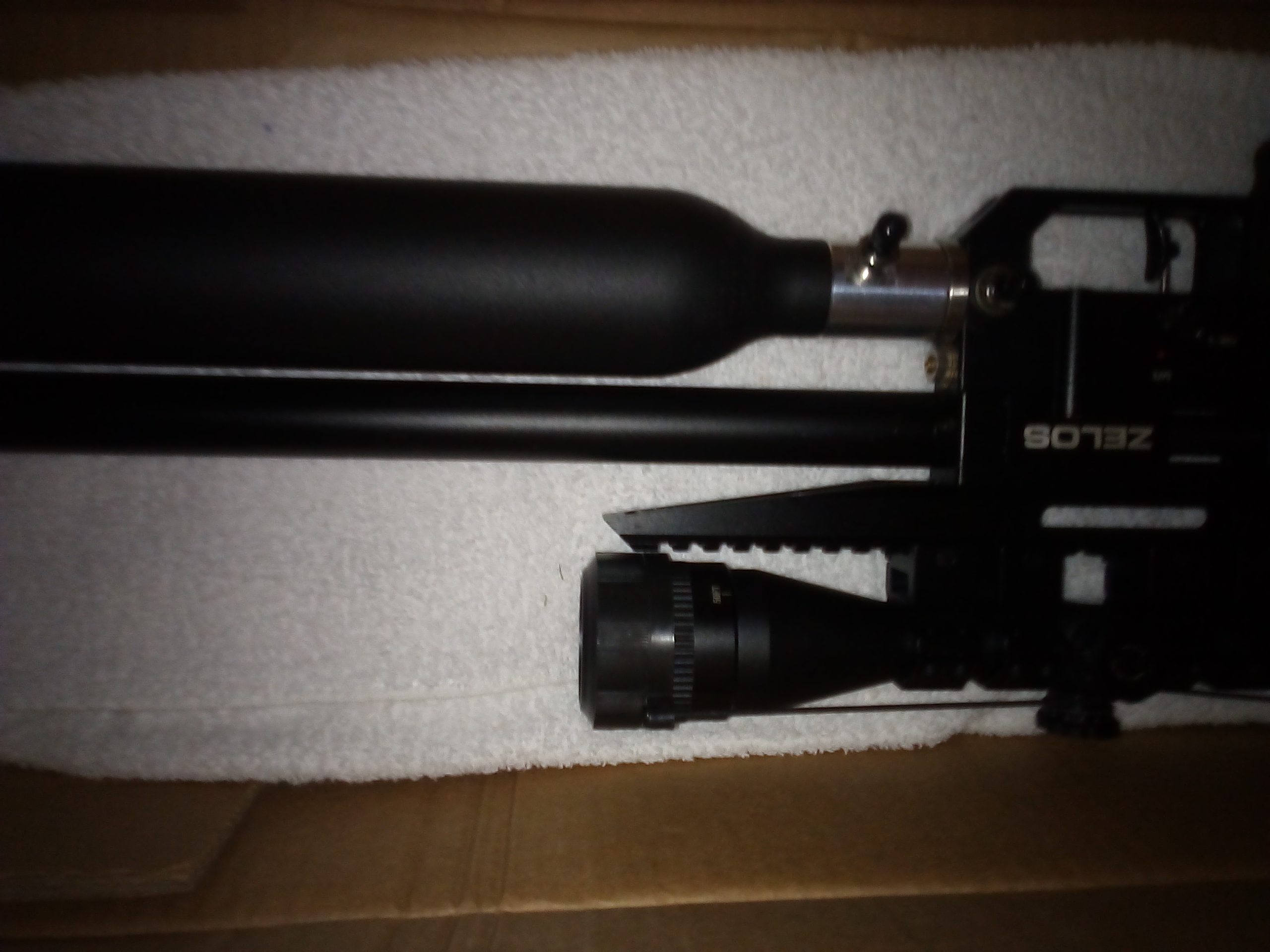

I only got 10 shots then it fell off the reg , so I bought a 500 cc aluminum bottle from Walmart for $35 , and an adapter from eBay for $5 . I had it going great untill my Vevor quit on me..
Which adapter did you buy?Just wanted to express my love for my .22 caliber Zelos as well this was my first PCP with an adjustable regulator.
It was a simple M18 x 1.5 male to M16 x 1.5 female. I had to use blue thread locker to make it work , and it was made from brass. Now I have an adapter made by c88machining it was $50 it's very nice , and let's you use the guage off the tube which is M8 x 1. I no longer use the paint ball flat bottom bottle I got from Walmart. I bought a round bottom aluminum bottle from Amazon for $40. I'm planning on getting a .25 cal Zelos , and I will be useing the Huben Zelos regulated bottle adapter , and a .7L Tuxing carbon fiber bottle , so I can fill that to 4.500 psi , and set the bottle adapter regulator to 3625 , and see how many shots I can get. I like very much that you can set the Zelos reg to 3,000 , so it will be my new slug gun , and I may even install slug power kit in it. THIS WAS A BAD IDEA. I COULD NOT GET THE BOTTLE REGULATOR I INSTALLED IN THE PLENUM TO STOP LEAKING. I ENDED UP DESTROYNG THE RECEIVER , AND HAD TO BUY ANOTHER.22 CALIBER ZELOS . I have gunsmith skills ,but HP is much different than PB. I now have a stock Zelos with a C88 adapter , and the round nose 500cc bottle. I'm still shooting the 28g slugs. Regulator is set 2,900 , and hammer spring is 5 turns in from flush. I'm getting 860 fpsWhich adapter did you buy?

I have been looking for a Zelos bittle adapter (reasonably priced) for a long time.It was a simple M18 x 1.5 male to M16 x 1.5 female. I had to use blue thread locker to make it work , and it was made from brass. Now I have an adapter made by c88machining it was $50 it's very nice , and let's you use the guage off the tube which is M8 x 1. I no longer use the paint ball flat bottom bottle I got from Walmart. I bought a round bottom aluminum bottle from Amazon for $40. I'm planning on getting a .25 cal Zelos , and I will be useing the Huben Zelos regulated bottle adapter , and a .7L Tuxing carbon fiber bottle , so I can fill that to 4.500 psi , and set the bottle adapter regulator to 3625 , and see how many shots I can get. I like very much that you can set the Zelos reg to 3,000 , so it will be my new slug gun , and I may even install slug power kit in it.
The c8 is best deal I know.I have been looking for a Zelos bittle adapter (reasonably priced) for a long time.
Where did you find the "M18 x 1.5 male to M16 x 1.5 female" adapter?
Does it seal and work well?
I know about the c88machining adapter but it is $60 after tax and shipping.
Been looking everywhere for a m16x1.5 female to g1/2-14 female to run a Chinese regulator on the zelos.The c8 is best deal I know.
Don't know of any metric to standard that exists.Been looking everywhere for a m16x1.5 female to g1/2-14 female to run a Chinese regulator on the zelos.
Steve , question what size is the zelos male filling on receiver?Don't know of any metric to standard that exists.
Yes M16 x 1.5.Steve , question what size is the zelos male filling on receiver?
Is it the m16x1.5 you alluded to?
Great info. - found the bottle at Walmart but confused about adapter on eBay. Can you enlighten me? ThanksJust wanted to express my love for my .22 caliber Zelos as well this was my first PCP with an adjustable regulator.
It was simple adapter from M16 x 1 female to M18 x 1 male there was no way to use it so , I put me foster , and my pressure guage in my plenum. It was a bad move. Since then I purchased a round nose bottle from Amazon for $40 , and a true Zelos bottle adapter from C88Machining for $50 use this set up as it will allow you to use the guage from your tube , and you will need to get a foster with a valve in it for like $10.Great info. - found the bottle at Walmart but confused about adapter on eBay. Can you enlighten me? Thanks
