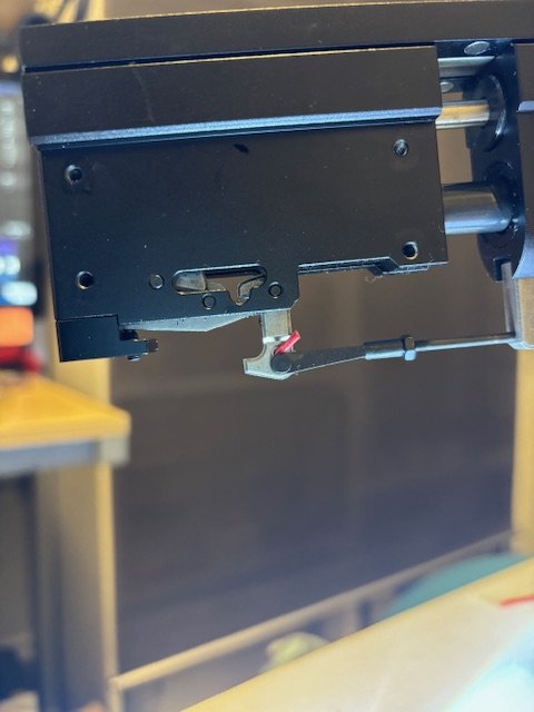

I am wondering if the trigger mechanism is like the P35 at least in the first stage. The P35 has a small spring that looks something like a ballpoint pen spring about half way back on the trigger rod that adjusts with a collar on one end that has a grub screw. By reducing the tension in that spring I reduced the trigger in my P35s about 1 lb.

@JimD. Here is the trigger linkage. Similar to the P35? I have added a piece of wire (red) as per Paul's video to take up the slack in the 90 degree connection there. Reduces the creep, I think.

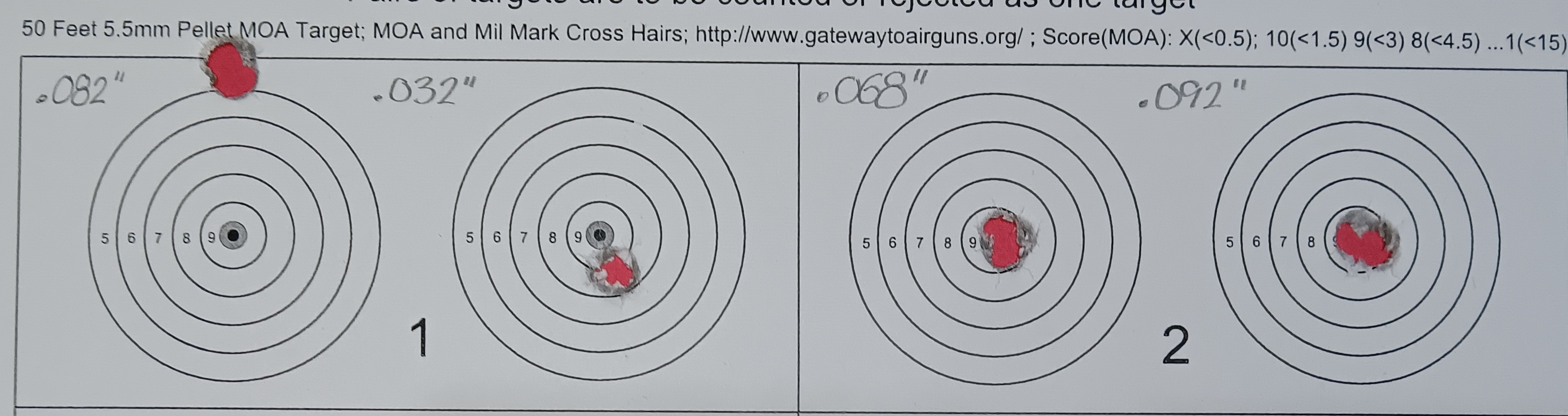

Here are 4 consecutive 10m groups of 5 shots each. JTS Dead Center 18.1gr round nose pellets from a fresh bore.
The movement off the bull is due to me sighting the scope in on Target 1 & 2 while 3 & 4 were centered on the bull so dont look at the bull, just the group sizes.
Center to center:
.082"
.032"
.068"
.092"
The M60 is tuned to 1 full turn of the hammer spring in from flush with the back, 140 on the regulator, 920 fps velocity.
