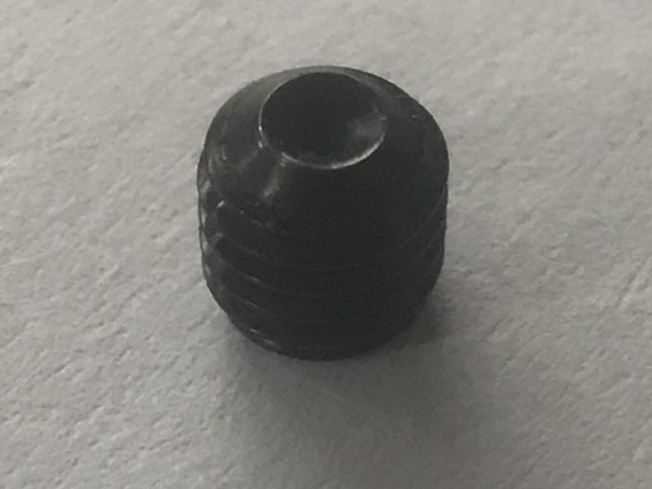

Looking for one FX Impact pellet probe set screw (or one that fits the Impact). I did not realize that it's part of the gun and does not come with a new barrel-kit. I already sold my screw along with my my barrel-kits and now "screwed" myself because no way to mount it. I may buy one from Home Depot, but I am afraid it may shear off like a few earlier ones reportedly did a year ago.
EDIT: FX Airguns USA will send me one.

Based on what I read, the Impact and Crown barrels are the same, but the 700mm barrel may look too long on a conventional rifle vs. a bullpup like the Impact.
Brian,
Thanks for the tip. FX redesigned their screws a year ago, I think they beefed up the material and made the screw longer. There may be a possibility that a regular screw from the hardware store may not withstand the .25 cal shear-forces. I would not try it for sure with a .30 caliber probe.
One thing that I am interested is the new barrel set-screw or grub-screw that the new Impacts come with now (mentioned previously). It supposed to do a much better job securing the barrel especially that the new X barrels (at least the 700mm Impact) do not have an indentation for the grub-screw. Does anyone have a photo or the dimensions of the new (grub) set-screw?  Here is the old one...designed to be hand-tightened:
