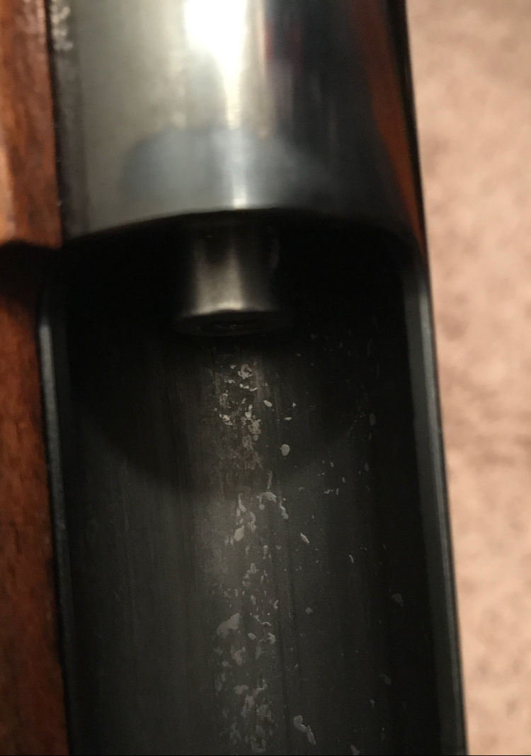

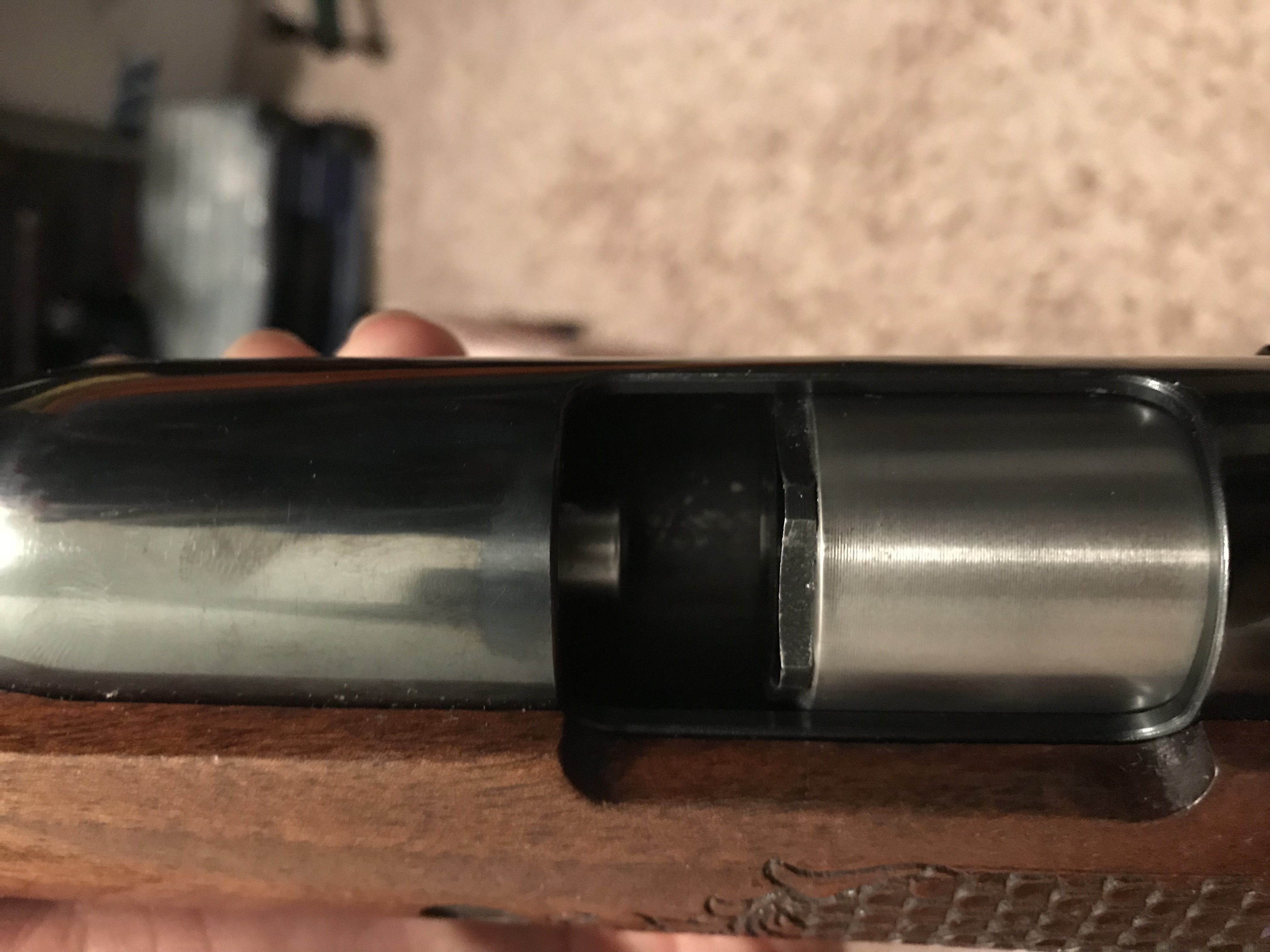

Here is a post I created a couple of days ago, hopefully, to shed some light on this matter:
Here are a couple of photos that illustrate how specks of lead can embed themselves onto steel. For those of you who use or have used Crosman pellets before, you know how dirty they are. As illustrated in the pictures, the smeared lead--caused by the constant opening and closing cycle of the compression chamber of my TX200 while bearing down on the lead particles against the steel surface--is impossible to remove even when using a bronze brush and lead remover, unless a significant amount of pressure is used. Nylon bristles will not work at all!
Anyway, I'll just let the pictures do the explaining and leave you to connect the dots that will lead you into making the conclusion as to what happens inside your airgun barrel when using these pellets. Wink-wink!
