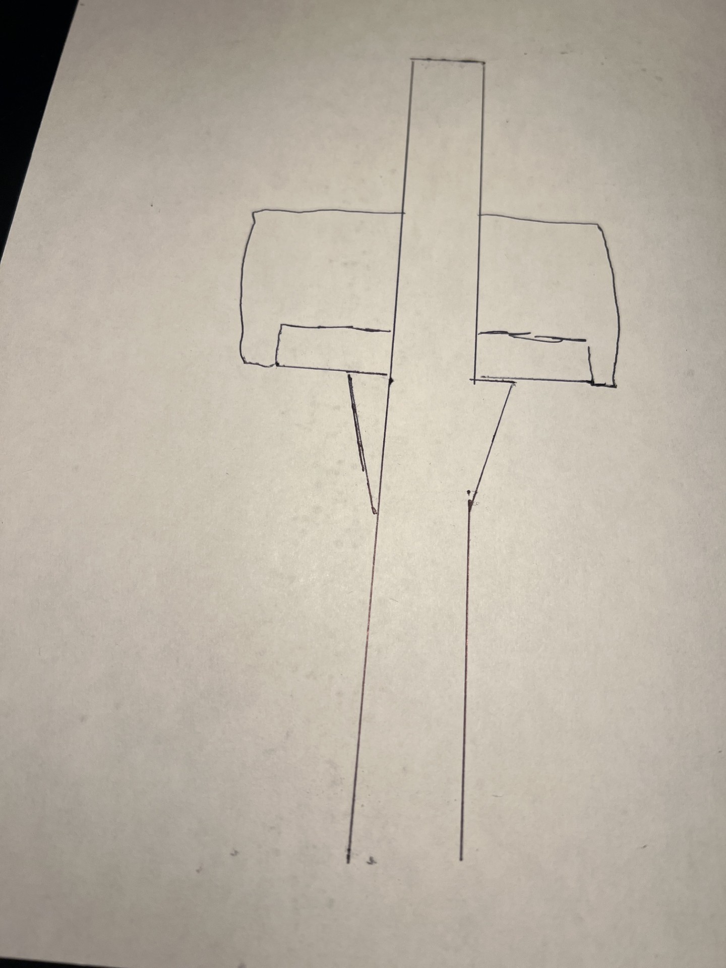

the valve
the stem is push out toward the seal side and in the crude drawing i have made you will see why
there a barb on the stem shaft and the barb holds the seal in place

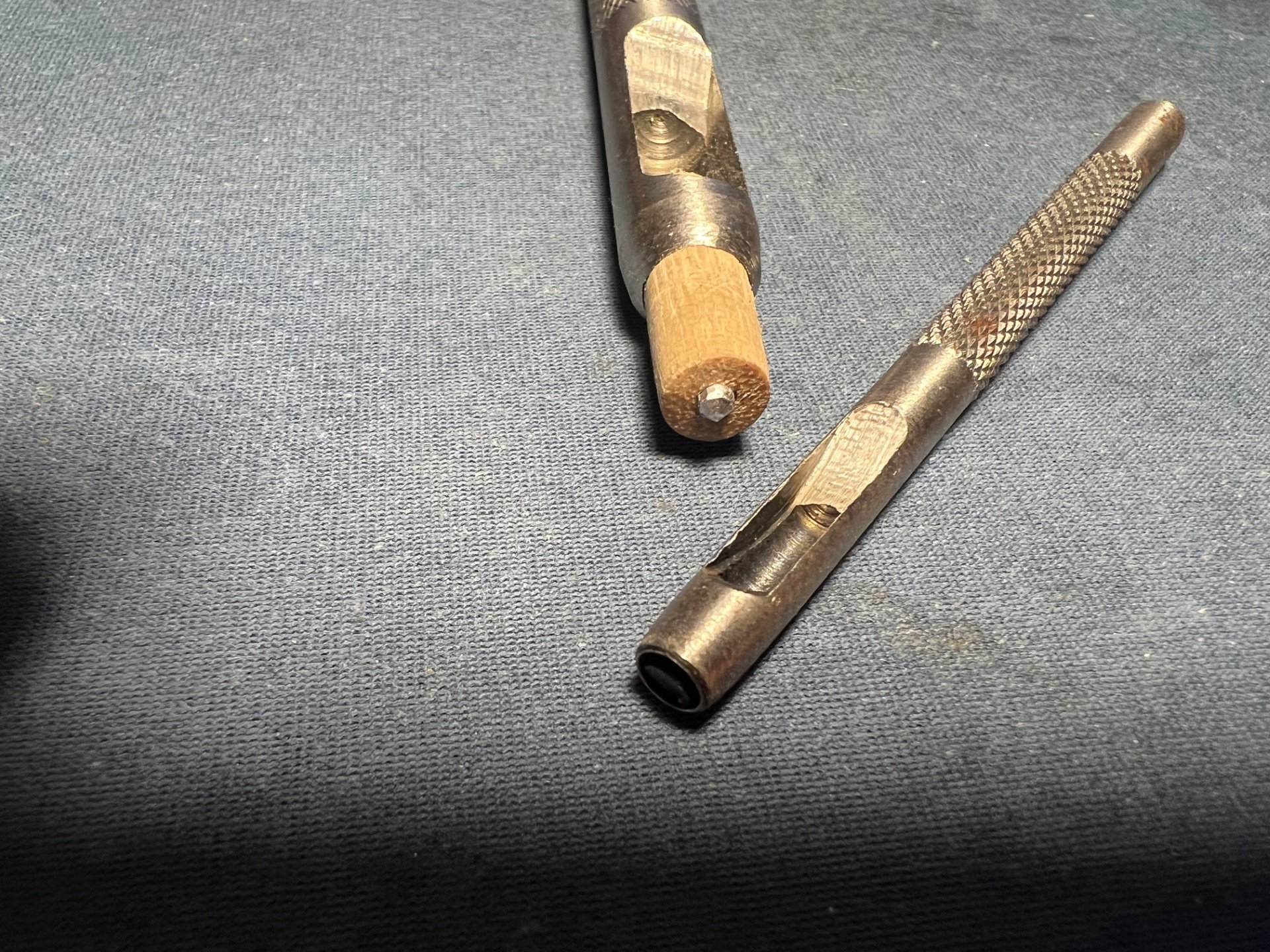

long ago i bought urethane sheet goods and leather punches to make the seal and the reason was just because
i can make the seals and or rebuild them i live in Washington state

the stems for the S&W 78-79g are a three piece deal
you have the stem, a cup that is brass and the seal
the Crossman are all the same part 1322-a011 and that is a cast seal of unknown material on the steel stem
so, no i cannot make them
the S&W stems need to be taken apart cleaned and reassembled with a new urethane flat seal
So I push the stem towards the seal, it will come out and than I can put a new flat seal into the cup side. So the stem pinches the seal and some what holds the seal in place.
