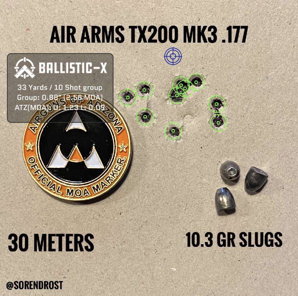

Tried 10.3 gr slugs out of my Air Arms TX200 MK3 .177 and they actually did group 👍
Not as good as pellets out of this amazing springer, but they did shoot okey 😃
Been there, tried it but in .177. They group ok but nothing to write home or brag about and pellets just shoot better.
