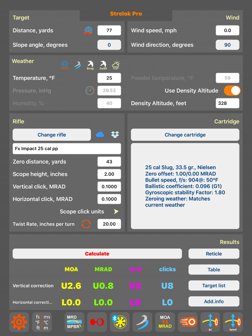

I am zeroed in at 43 yards. I type in 77 yards where one of my gongs are located and the app is telling me to aim here (see picture below) but I am actually hitting at mil 3 64 yards, right above 4.
So my question is am I doing something wrong? Do I have something wrong in the app because I'm using slugs now? I don't understand why my point of impact is so drastically different compared to what the app says. Could it be the flatter trajectory of the slugs is why and the apps not taking that into account? I don't know what is going on im so confused. When I was shooting my 25gr jsb pellets the app was point. I dont know why it wouldn't work with slugs. Thanks for looking and thanks for the help everyone.

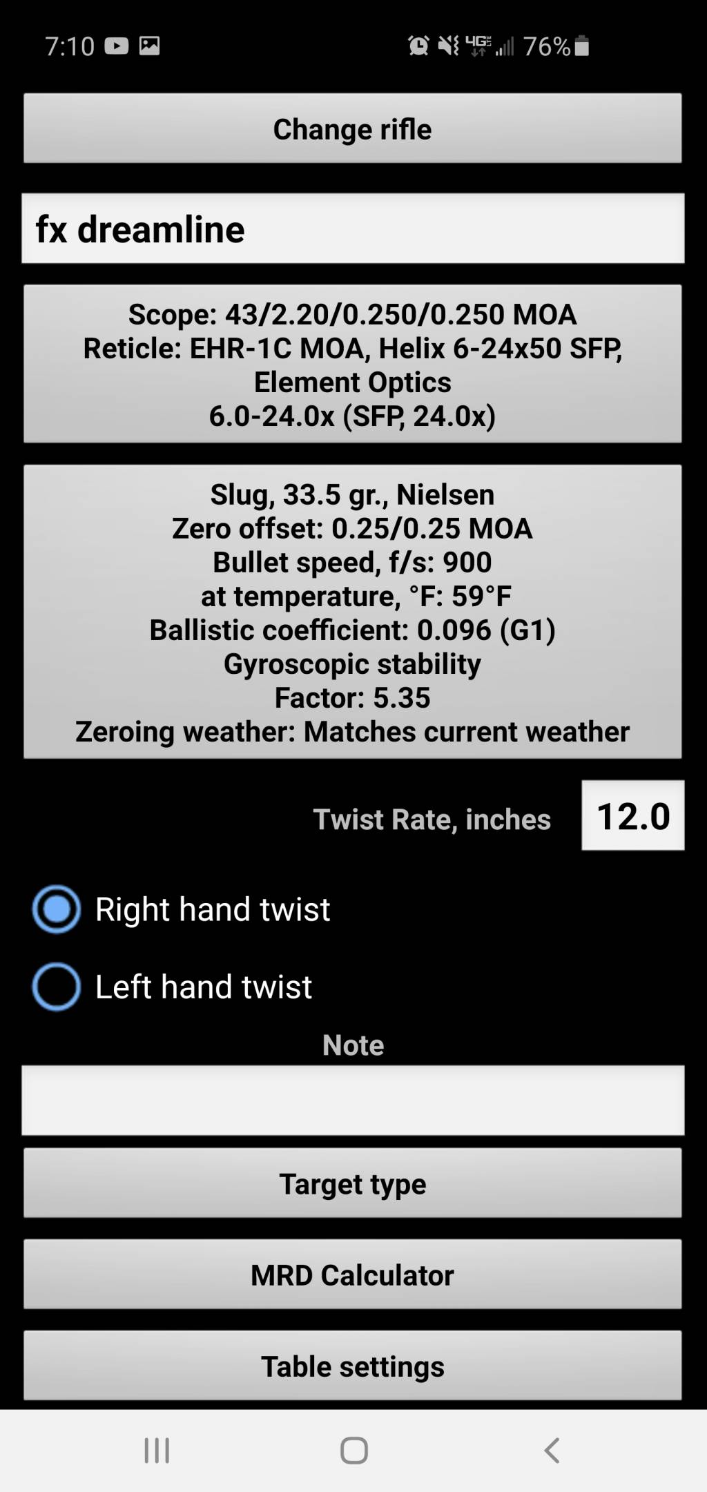

Hello Kevin,
Are you using a second focal plane scope (SFP)? That's what your software setup shows. If so, then you also have to set the magnification factor setting in the software to match the actual magnification on the scope to make the reticle have the same scale. In FFP scopes, this problem goes away, but software has to match hardware. To reiterate, for an SFP scope, the reticle hold point calculations are only valid for one specific magnification factor.
Also, make sure that the angular measurement standard for the reticle in your scope (moa vs mil) matches the scope reticle type chosen in the software. Some Scopes are available in both MOA or MIL. Also make sure the measurement system for the turret click adjustments matches between hardware and software. These can also be either MOA or MIL.
Also, your software shows a 1-in-12 RH twist rate....does that match the actual rifling twist rate & direction in your Dreamline's barrel/liner?
Ballistic coefficients of pellets are somewhere around 0.03ish. According to the Nielsen Specialty Ammo website, the 33.5 grain 25 caliber slugs have a ballistic coefficient of 0.096.

Yes, it seems pretty far off....you have current weather set equal to zeroing weather, which only works if you just finished zeroing. Don't forget the humidity.
Did you double check your scope height measurement? This is another key element: center of objective lens to center of barrel. It's not always easy to me are given that some shrouds taper, or some barrels aren't concentric with outside of shroud.

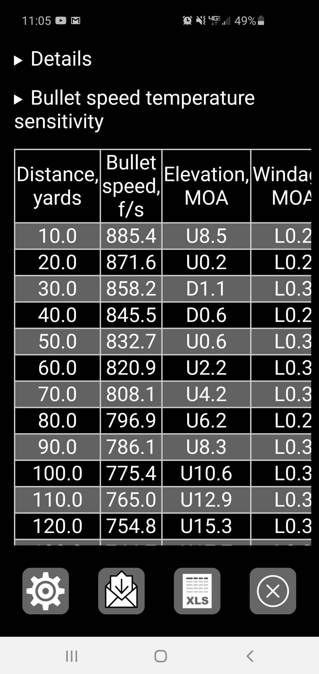

If you're sure you've got everything else correct, I would adjust the magnification down in the software and see if that makes things line up. Zooming out on an SFP scope will make each tic mark a larger distance downrange. Have you looked at the ballistics table in Strelok to see if the calculated elevations agree with your actual data?

Fienwerk, yes I measured my scope height and everything. Hasn't moved since I started shooting slugs, but I am going to definitely check just to make sure, I have the fx adjustable rings so maybe your onto something here. Are you talking about this graph? Thanks for responding.

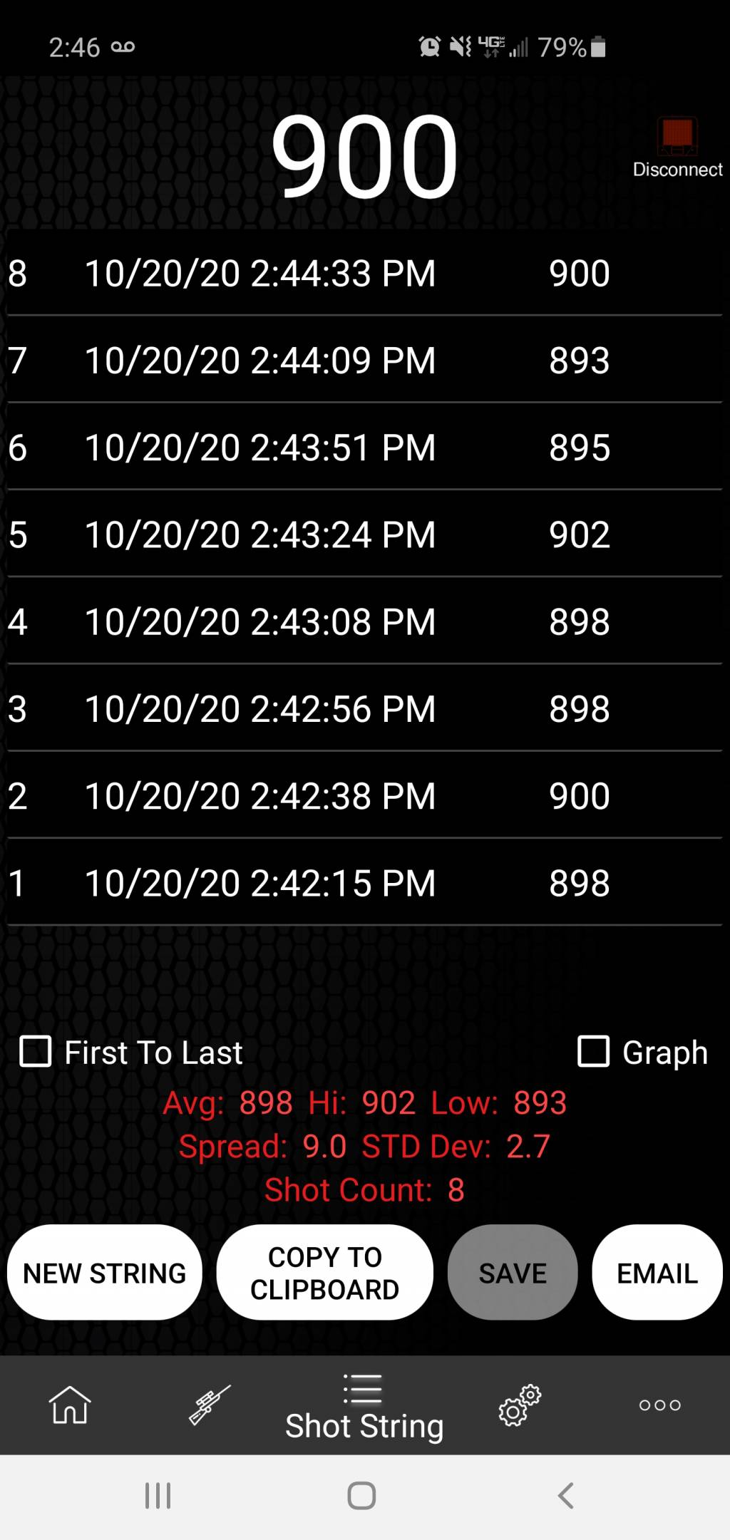

I'm not familiar with the fx chrony gizmo, mine is the labradar. I would assume that it will record speeds besides just the muzzle velocity. Say you get speeds at the muzzle,5, 10, 15, 20 yards. Plug them into a bc calculator such as the free one at airgun depot. It will ask a near(muzzle) and far velocity and what distance near and far were. Figure this for each of the far distances you have measured. Now you have 4 bc's. Where strelock asks you to input your bc, go to multi bc mode and input your 4 different bc's. Finding your bc(s) for your set up should give much better results than assuming you have the same setup/conditions that NSA had. I hope that makes some kind of sense.
There must be some fundamental error in the data entry. Centercut's comments are gold.
To run another diagnostic test:
Instead of holding over, dial your elevation with the turret.
If you're on target, it's clearly something with the reticle data.
If you're off, too, then the zeroing might not be set correctly.
Let us know when and what solved the problem. 👍🏼 Good luck.

Thank you everyone for all of the advice. I plugged everything into my strelok app so it was correct. I was going with the BC from NSA website like a dumby. As you guys said above thats NSA's BC not mine. Used my caldwell chronograph and set it up down range at 40 yards where i zero in at and got my near and far velocity like Scoutscope recommended me to do and calculated my personal BC at 0.055 and she's back to normal!!!!!!!!!!!!!!!!!!!!!!!!!. Thanks again everyone!!!!!!!!!
