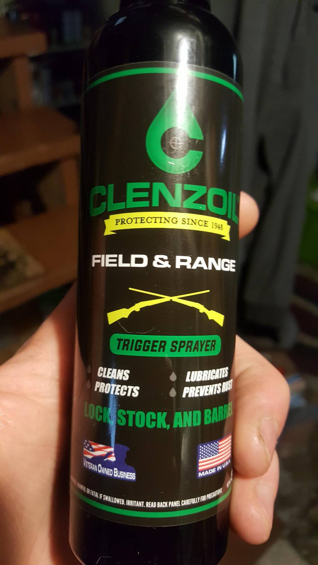

      What kind of CLP are you writing about?

        Can anyone tell me if they know wheather or not this CLP is safe for o-rings?
