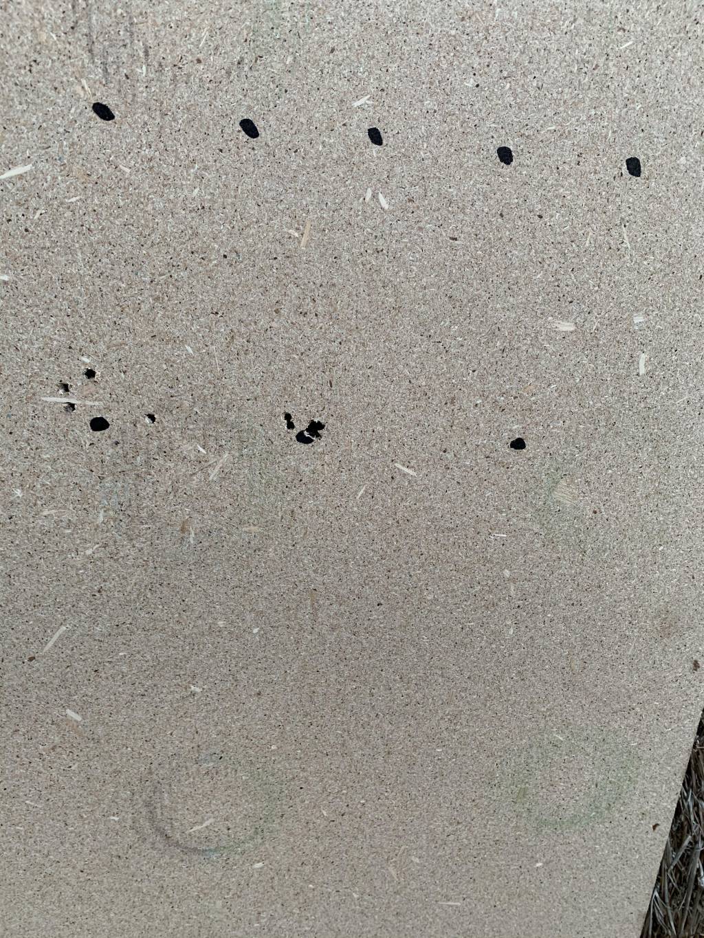

Middel group is My dreamline classsic. 90 yards. 6 shots @ 930 FPS . H@n 21 gr 218. Stx pelletliner 500 mm. Huma Reg 145 + fx power plenum
Left group is h@n 23 grain.
The classic is more accurate than my impacts with superior and slugliner.
