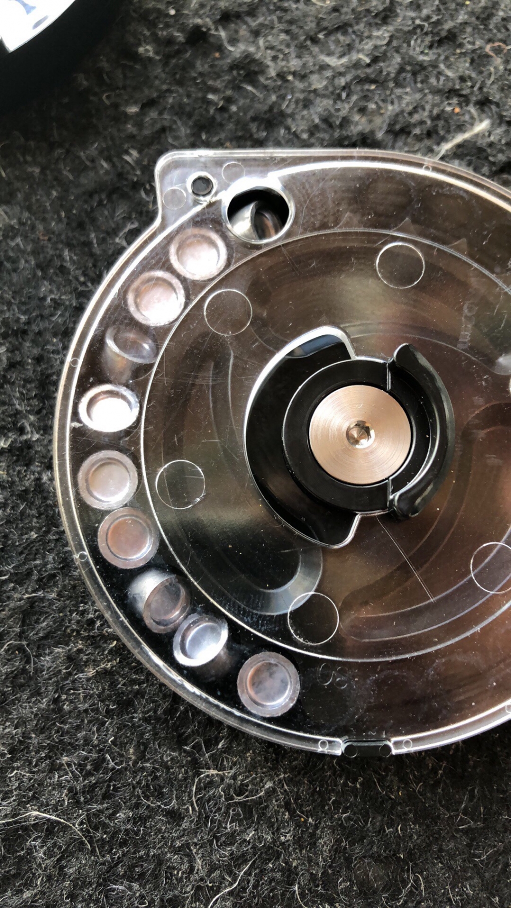

Anyone having this same issue? This is happening after every few shots I make, it’s happening to 47g 50g 55g NSA .30 slugs.
Are you sure you're not putting. 25 cal into a .30 mag? Theres no way the pellet or slugs can turn sideways like that useless it's really under sizes.
Im pretty sure they are .30 cal, that’s what they say on the NSA box and plastic baggie that came with the slugs
